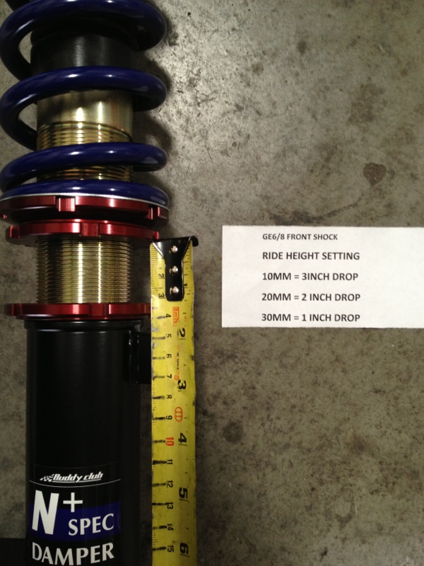

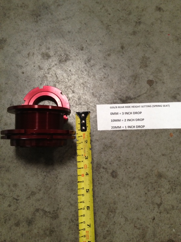

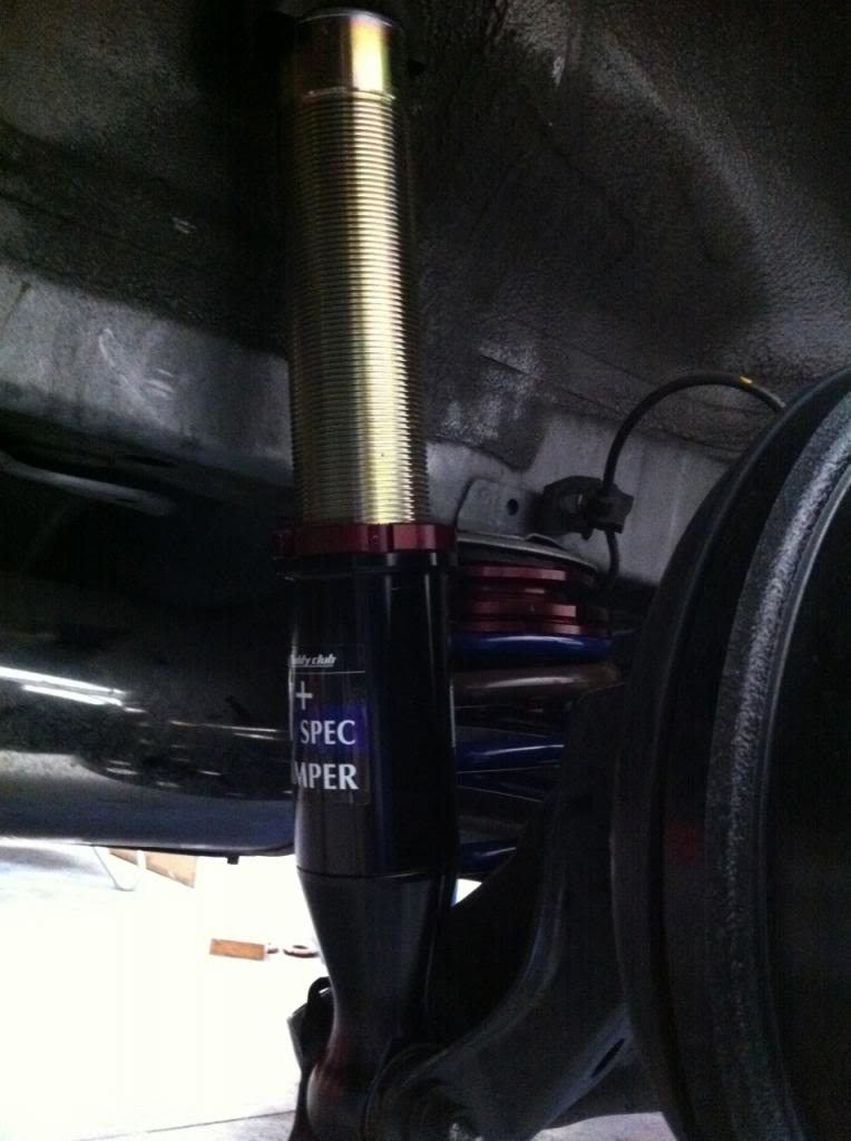

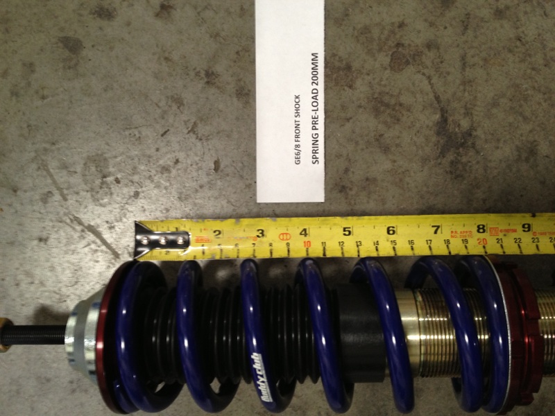

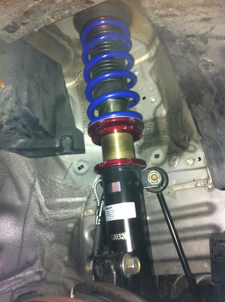

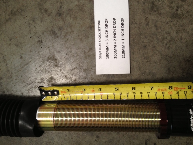

SO.... Basically i wanted to help out the Fit Freak community with GE BuddyClub Lowering adjustments...
These picture will show you how to properly adjust ur ride correctly to the different ride heights that you desire
Hope this helps Please feel free to ask any qestions you have....

Update there new springs around so double check witch spring u have
Here are the new specs for this spring front and rear For 175mm spring
Pre-load 175mm
Ride height
30mm = 3 inch drop
40mm = 2 inch drop
50mm = 1 inch drop
