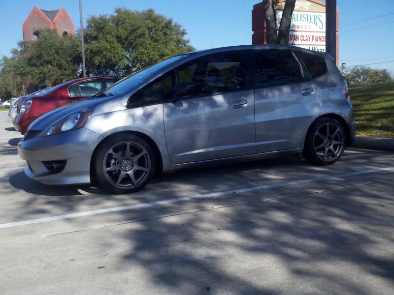

There seems to be a lot of talk on here and I can honestly say the current setup I have RUBS ALL THE TIME! I had 205/40/17 tires and put DZ springs on my Fit. Way too much GAP in the fender. I went with the Falken Ziex ZE-512 215/45/17 on my DR-33 wheels 17x7.5 +42 and had some poke up front. No RUB at all...
I then put on APEXi ExV Coilovers, lowered them ALL THE WAY DOWN and had to remove the spacers from the rear due to rubbing the letters off the tire, and front Rubs on any bump hard turn, and on hard bumps the tread hits the fender liner hard! Most of it is gon now, and I will trim the remains...
PS for those who care DR-33 are HEAVY 20Lbs!
On the Drop Zone springs this is how it looks with the Falken Ziex ZE-512 215/45/17 Tires NO RUB

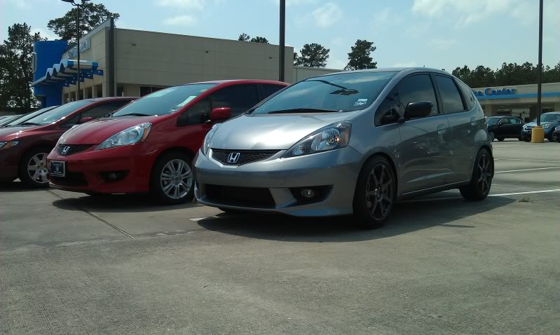

205/40/17 Tires 17x7.5 +42 wheels Drop Zone SPRINGS NO RUB

Read my previous post... I did not rub until I went lower than the lowering springs. On DZ springs I DID NOT RUB with the Falken XD-512 215/45/17. I did not rub until I got my coil overs for MOAR LOW...

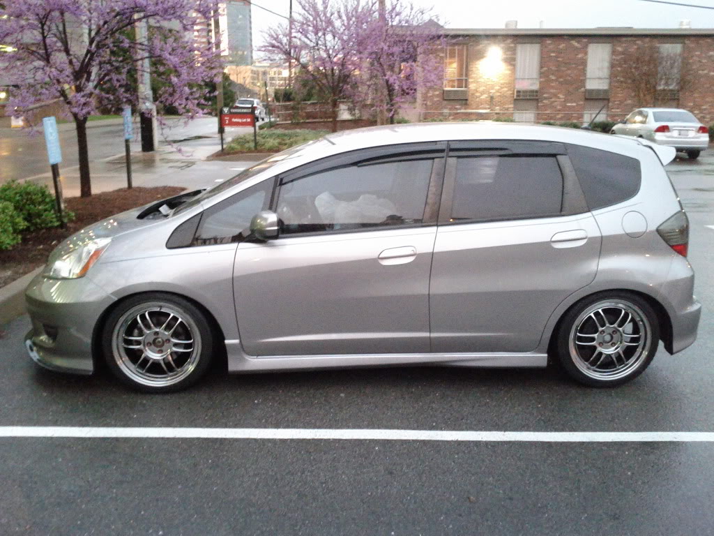

Enkei Rpf1 17x7 +43 205/40/17 No rubbing! Lowered on tanabe coilovers on the lowest setting.

Are there no center caps for the RPF1?
I was supplied some faux CF caps for my PF01 but I covered them in vinyl.

I got the wheels off craigslist and they didn't come with caps. Not sure I would've put them on anyway, and I'm definitely not paying $25 a piece for the caps even if I wanted to.
That money is going toward project mu lug nuts. : D

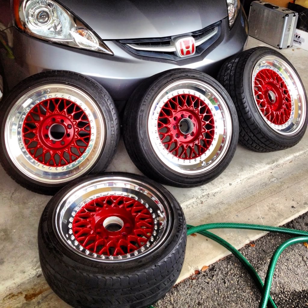

Repolishing the kicks ! Its such a task ,Kinda feels like raising a child ! But all worth it ! Name:  ec5a37fd.jpg

Whats the specs on those BBS? I Been looking for some of those or some RPF1's

16x8+24 all around on 195-45-16 !

Damn that seems kinda agressive fitment wise. Sometimes I wish the Fit was RWD or at least ran a lower offset from the factory. what was honda thinking with +53mm offsets.
