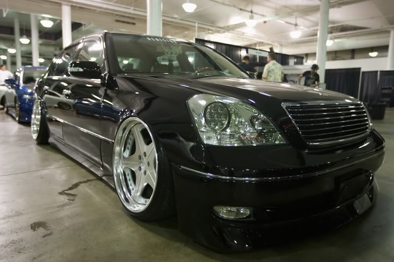

i ran these on my old LS430 to flush out my wheels. the fronts were project kics 15mm and rears were ebay special 25mm. ran these for amonth until the the front got loose. car was wobbling like crazy on the freeway. took it right out that night. the rears (ebay spesho) actually stayed on pretty well even though the rears were cambered more.
could've been that it wasn't properly torqued by the shop. who knows. i took it out cuz that scared the shet outta my cheeks.
