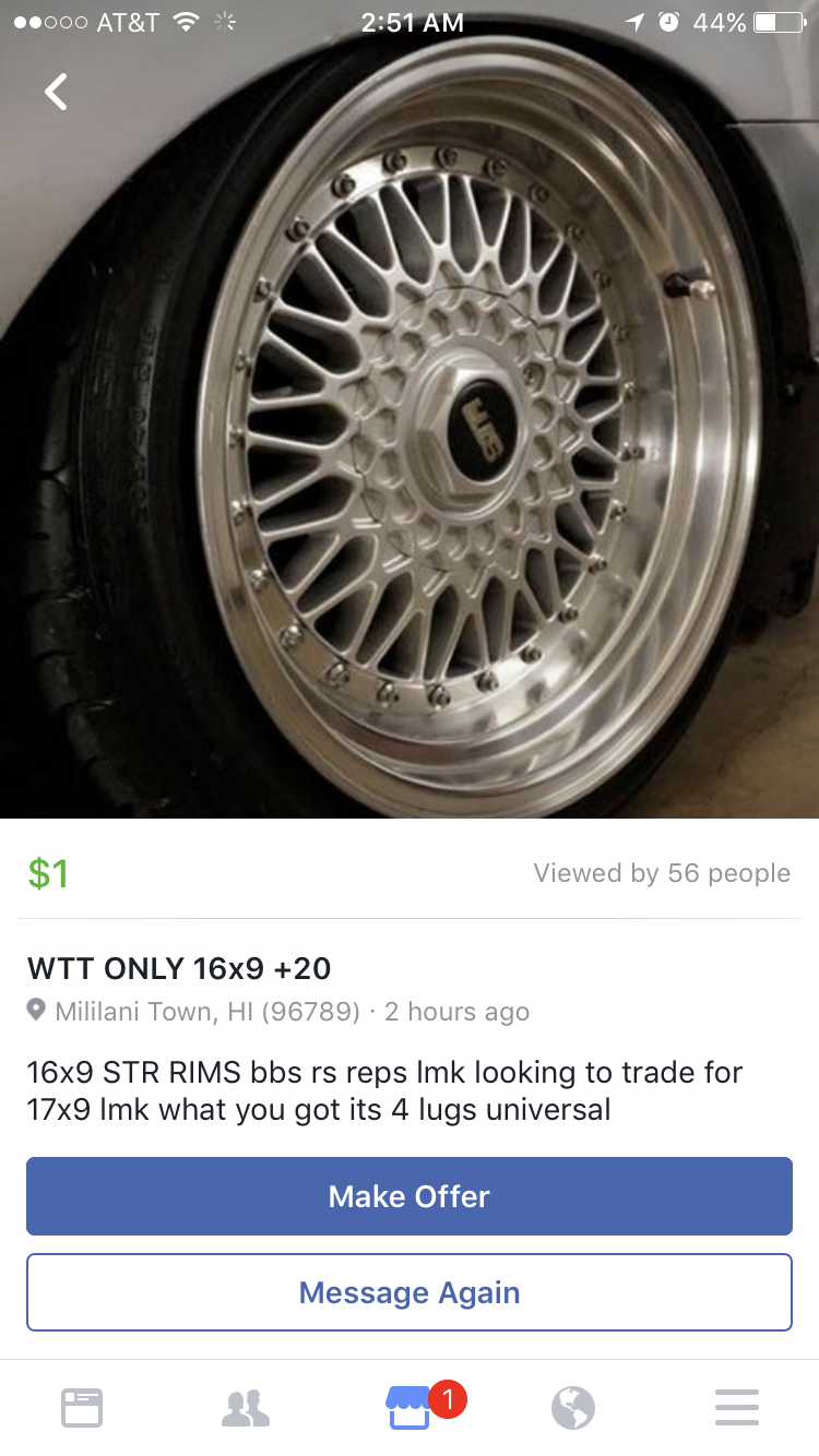

Will these 16x9 wheels fit
Will these 16x9 bbs rims fit on my 2010 honda fit sport all stock everything

I think you will need a significant fender pull/roll or even bolt on fenders to cover those.
I am on 15x8 +35 and the fronts peek out past the fender. Rear lines up with fender.
The +20 offset AND 9" wide will make them stick out quite a bit. I'd say at least 1-1.5" PAST the fender.
