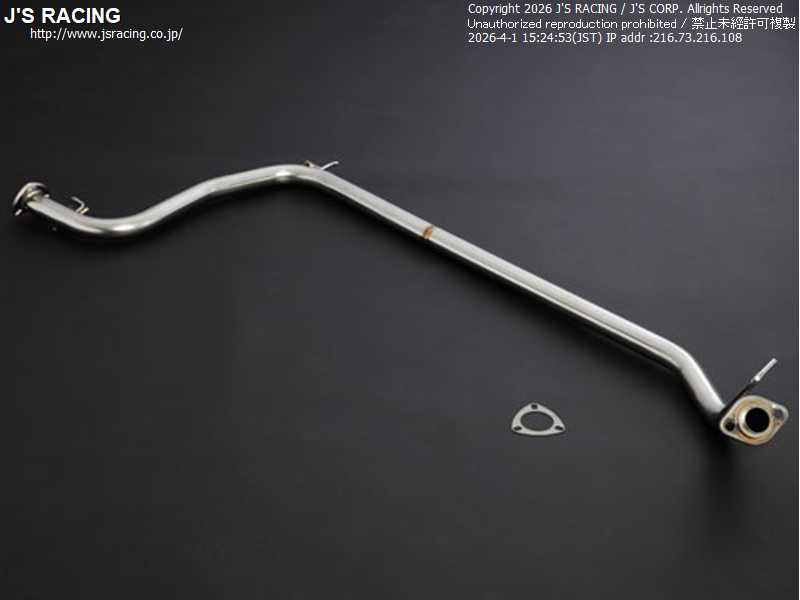

J's Racing GK5 B-Pipe or Mid Pipe
J'S RACING GK5 FIT C304 SUS exhaust system center pipe 50C
See Post #10
My bad translation --->
"Use SUS304 stainless steel tube of thickness 1.2mm to the main pipe. By making the flange portion and the stay part that was thin to the limit in a hollow structure, it was even finish to lightweight.
Exhaust efficiency is significantly improved the diameter of the pipe portion by a 50φ. We made ​​muffler, of course, you will be able to make big power up, even in combination with third-party and genuine muffler."
36720 Japenese Yen Approximately $310.65

The J's Racing B pipe arrived today (Only two weeks after ordering it on 3/23/15). It is the exhaust piping on the left while the stock is on the right. It was packaged really nicely and there did not appear to be any damage to it. Welds look fine, it was shiny (I don't care about this either way). Nothing else to add!
I laid the J's racing B pipe on top of the stock pipe to see if it looks like it would or would not fit on the car. It looks like it is a go.
I took measurements of the J's piping at different sections since I took measurements of the stock B pipe sections earlier today. Here's a pic of the differences. O.D. means 'Outside Diameter'. I.D. means 'Inside Diameter'.
In the case that the picture does not load up in the future, here is the piping diameter info of the J's Racing B Pipe from measuring with a digital caliper.
Feel free to take your own measurements. The stock piping measurements are in this thread --> 2015 Stock B-Pipe Diameter & Weight. Results may vary.
Outer Diameters
Inlet Piping diameter -- 46.6mm I.D. (1.83")
Pipe after 2nd cat -- 49.5mm (1.95")
90 degree bend
Pipe leading towards the resonator -- 49.86mm (1.96")
Bend towards resonator
Inlet piping to resonator -- 49mm (1.93")
Resonator
Resonator outlet pipe that has slight bend -- 50.66mm (1.99")
Piping after slight bend that goes to muffler -- 50.4mm (1.98")
Piping outlet to muffler -- 41.9mm I.D. (1.65")
The J's Racing B-Pipe weighed in at 12.2lbs. (5.53kg)
The stock B-pipe weighs 10.4lbs (4.72kg)
The J's Racing B-pipe weighs 1.8lbs (0.82kg) more than the stock pipe.

The J's Racing B-Pipe fits like a glove.
And the flange that attaches to the J's SUS Converter aka Cat delete is a match made in heaven.
