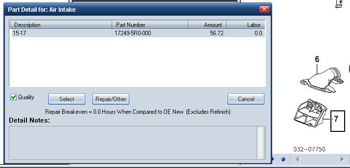

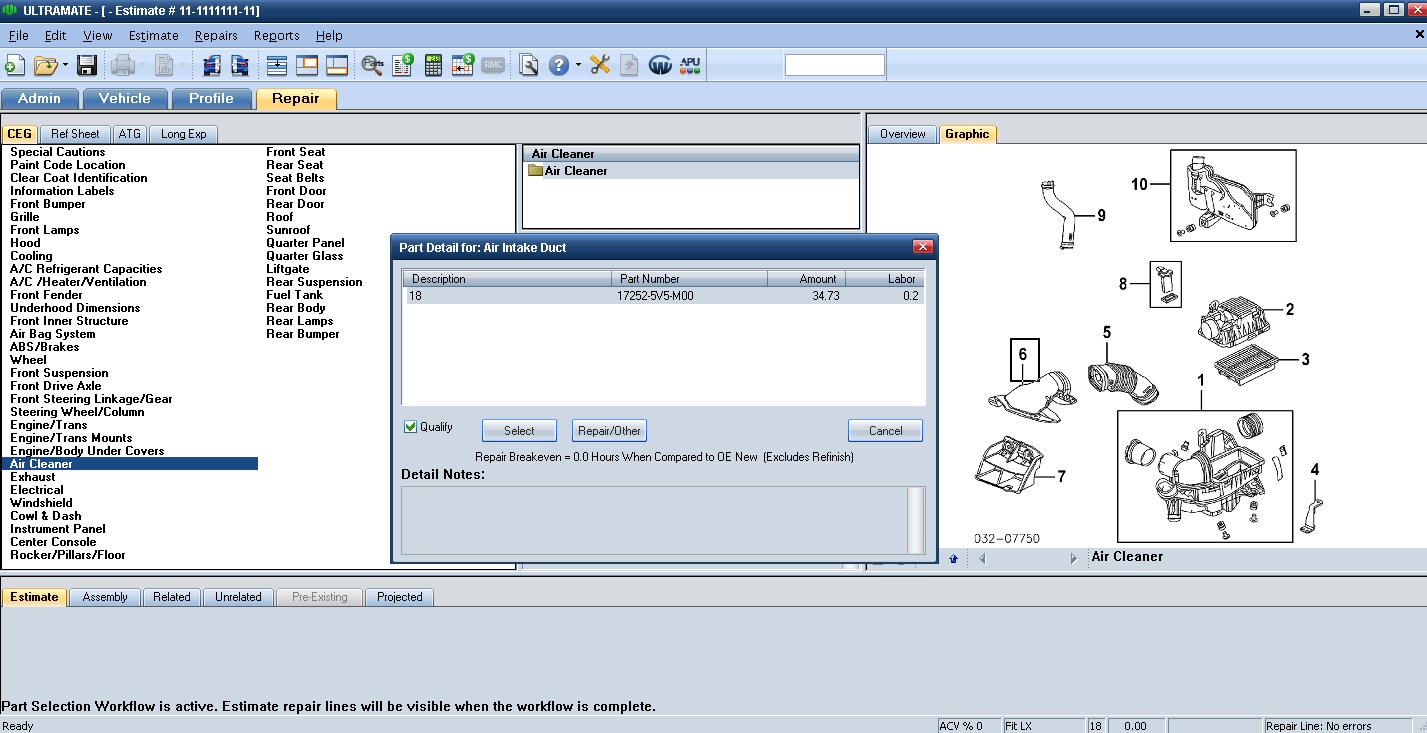

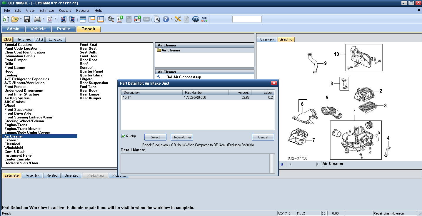

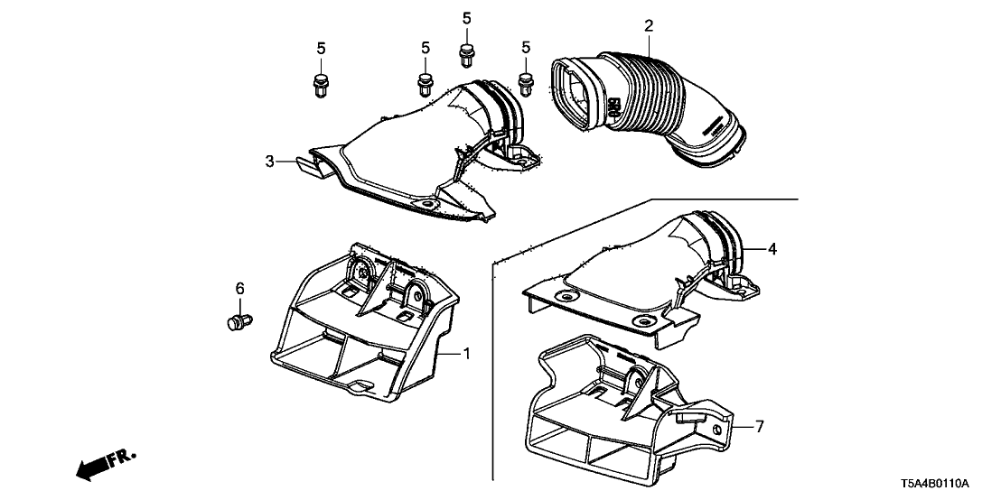

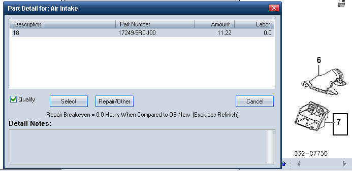

Just an FYI, this is only applicable to 2018 MY.
The air intake duct (parts 3,4) as well as separator assembly (parts 1,7) are different for 2015-17 vehicles.

PN's for the duct assembly are indeed diff ... but the diagram shows they are identical. That said, this mod the OP did, should work fine for 2015-2017s.
Parts 1, 7 appear to scoop air from the grille area upward into the duct, with the mod that would technically bypass the need for all the below as, the air now scoops from the hood area (similar to a seminole ram air duct)
I'll be testing it out within the next few days
