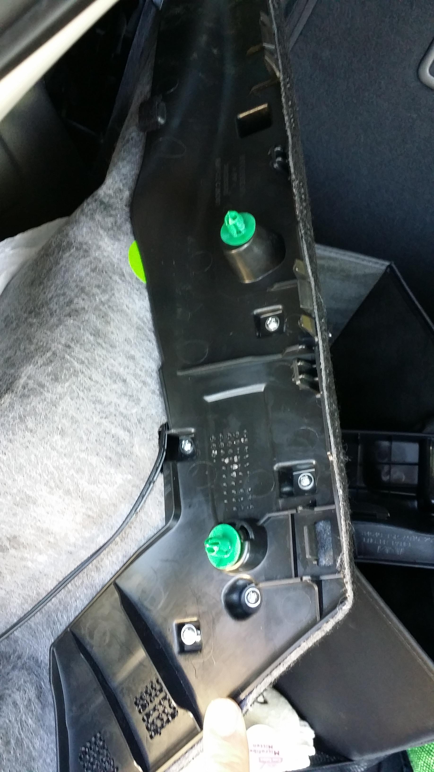

Lower the rear seats first. You're going to have to pull apart the left side plastic panel in the trunk. Use something flat, slip it under the plastic, pry up, then use your fingers to pry it off slowly. It will also pull part of the interior fabric with it. This is ok.

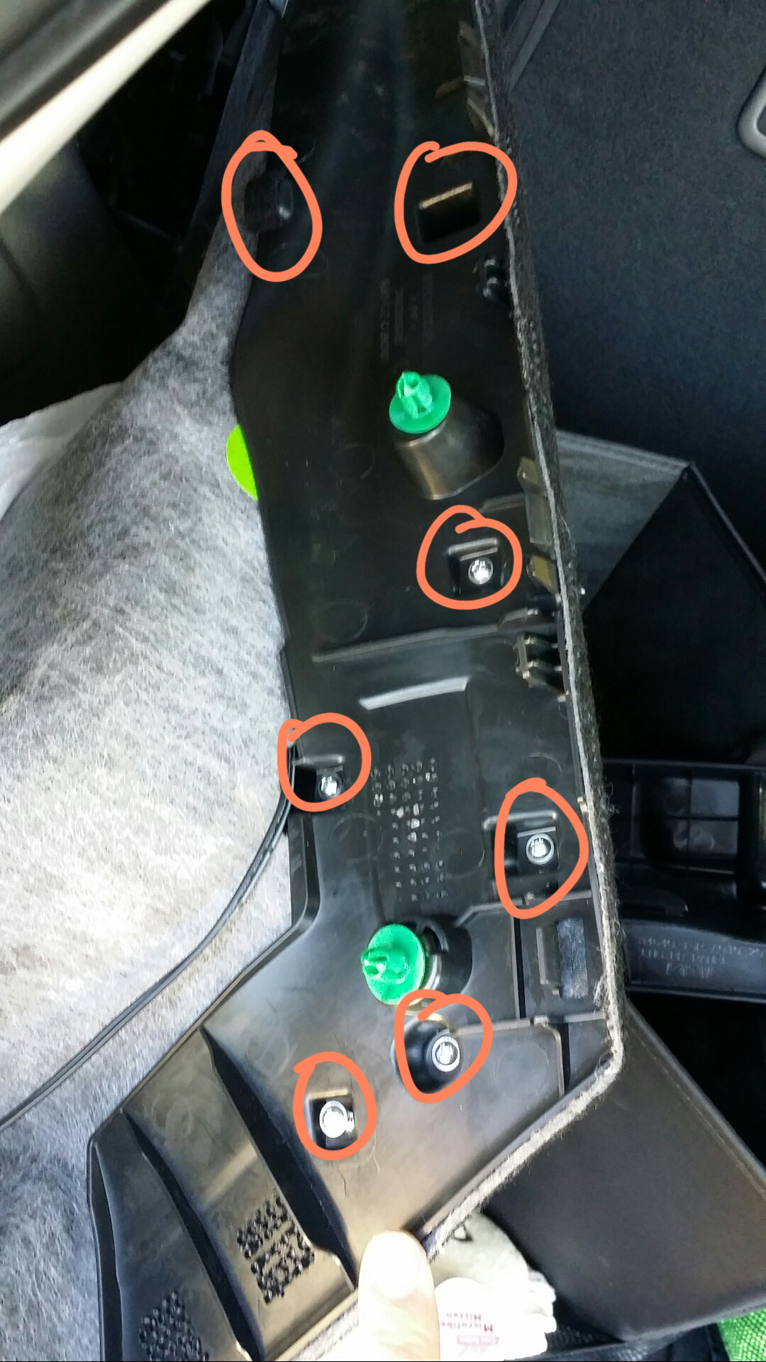

You will have to remove 7 screws circled in orange. One is hidden by felt tape.

When you have removed the screws, take off the plastic covering.

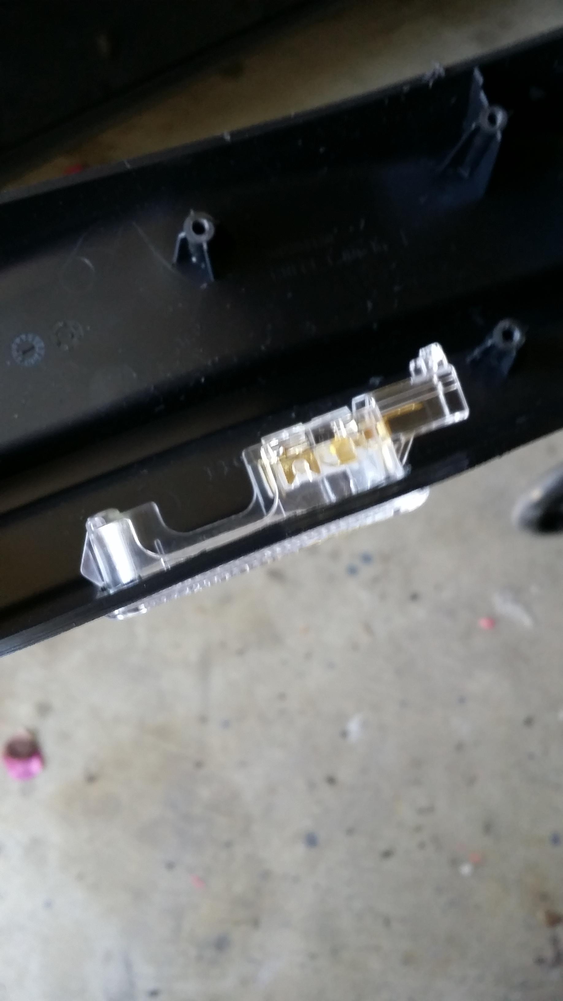

Place a lens assembly or lamp assembly of your choice on the plastic and mask it with some painter's tape so you know where to cut/dremel.
Dremel or cut off the piece with your favorite stress relief tool. Sand off and make it look pretty. Or try to.

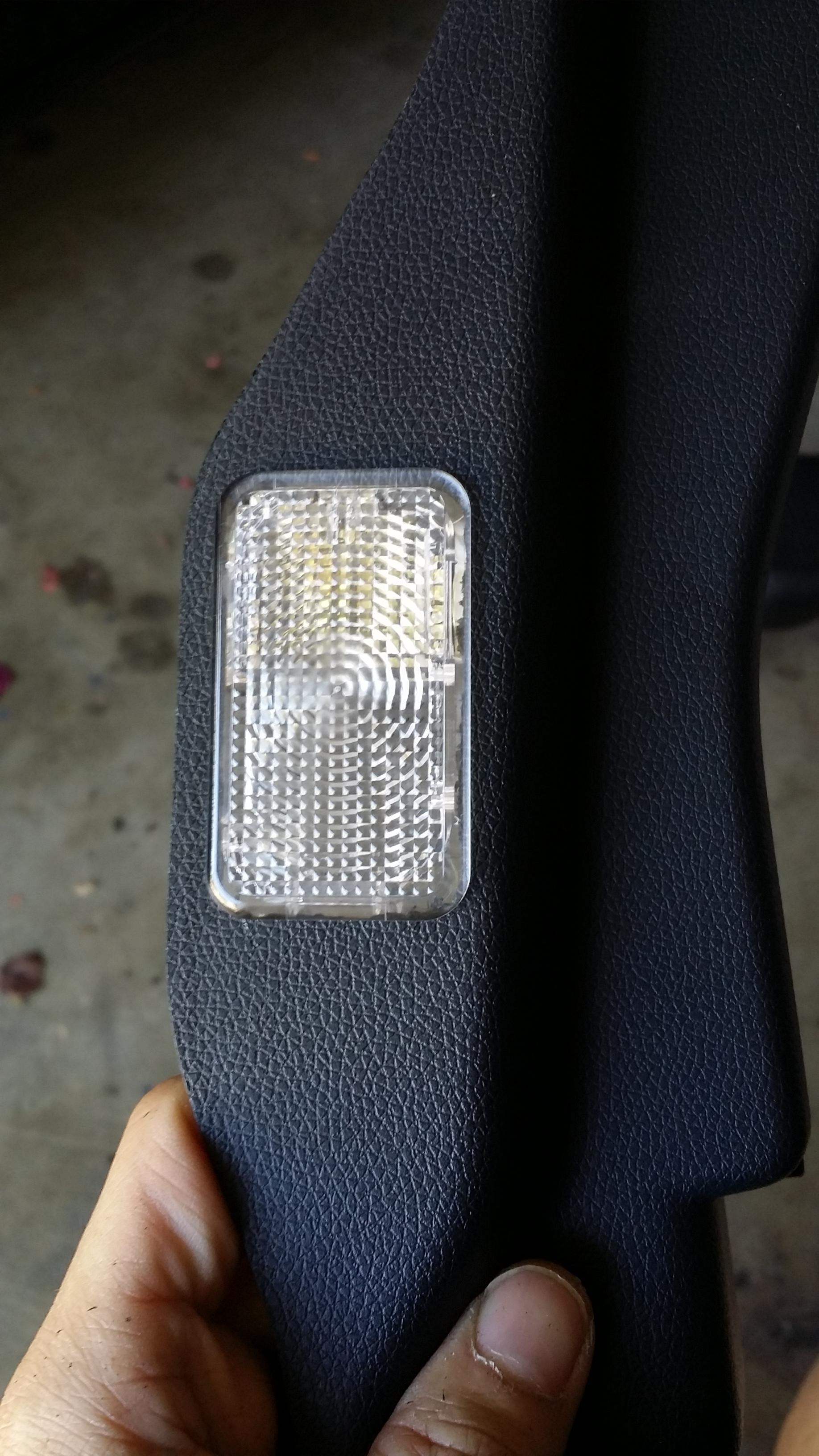

Test fit your assembly to make sure it's a snug fit but also capable of removal.

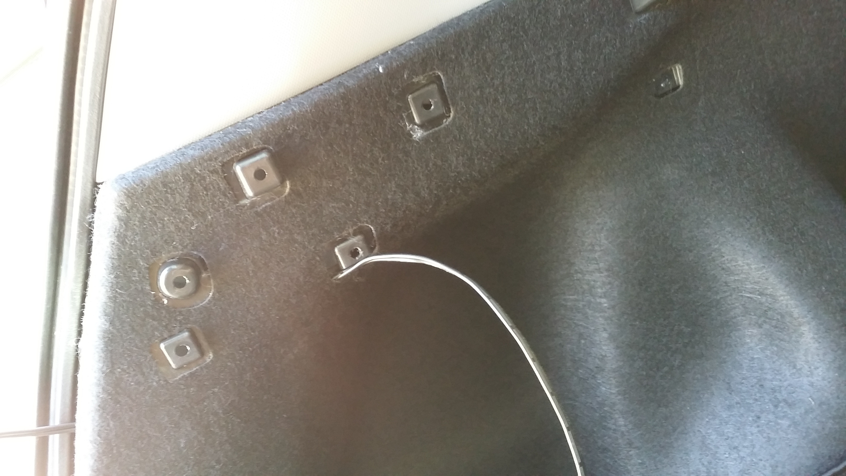

Now pull back on the other plastic with the stock light. You're going to have to tap the wires there to power up your upcoming new trunk lights. It's the same method as the first step, except you don't have to unscrew anything. Just remove the stock lens assembly, unplug the OEM harness and then tap the wires. Then re-route your new tapped wires to the other side.

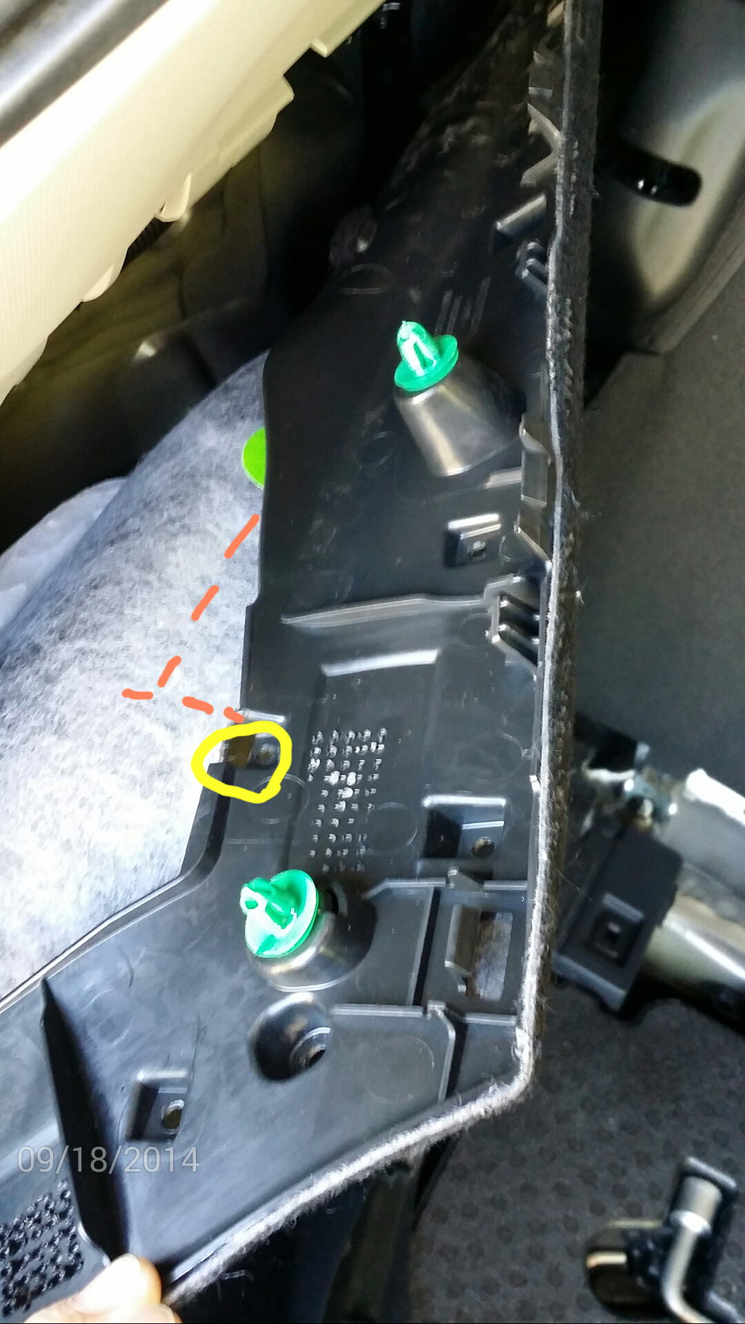

The best place to put those new tapped wires through is the hole that is circled yellow. That hole will allow the wires to go through and into the plastic shroud once you screw it back on. If you are using the OEM lens assembly, you will also have to cut the fabric covering along the dashed orange lines to allow room for the assembly. So just cut and make a flap. Don't have to worry about a "hole" in the fabric since once you put the plastic shroud and screw it back on, it will cover that "hole".

Wired through. You can choose to connect the new tapped wires to the OEM connectors for that "OEM harness look" or just female connectors you can pick up at home depot. They fit fine but a bit snug.

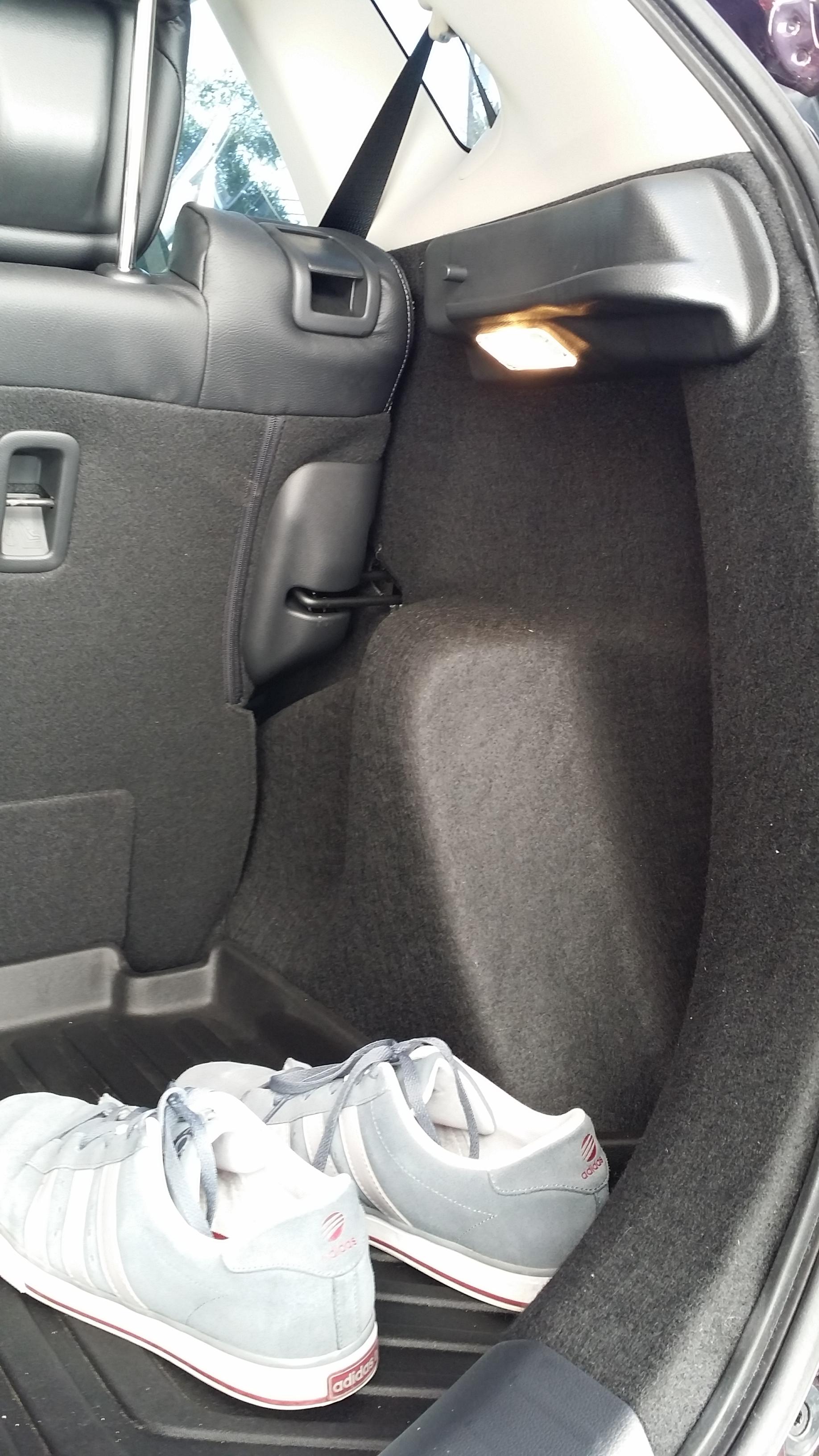

Just reassemble connect everything and the lights should work.

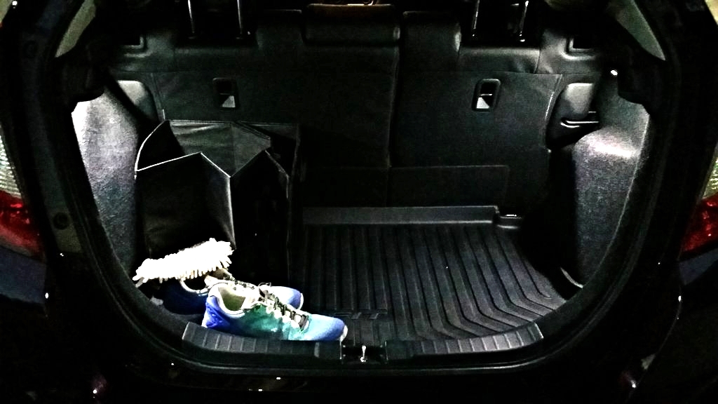

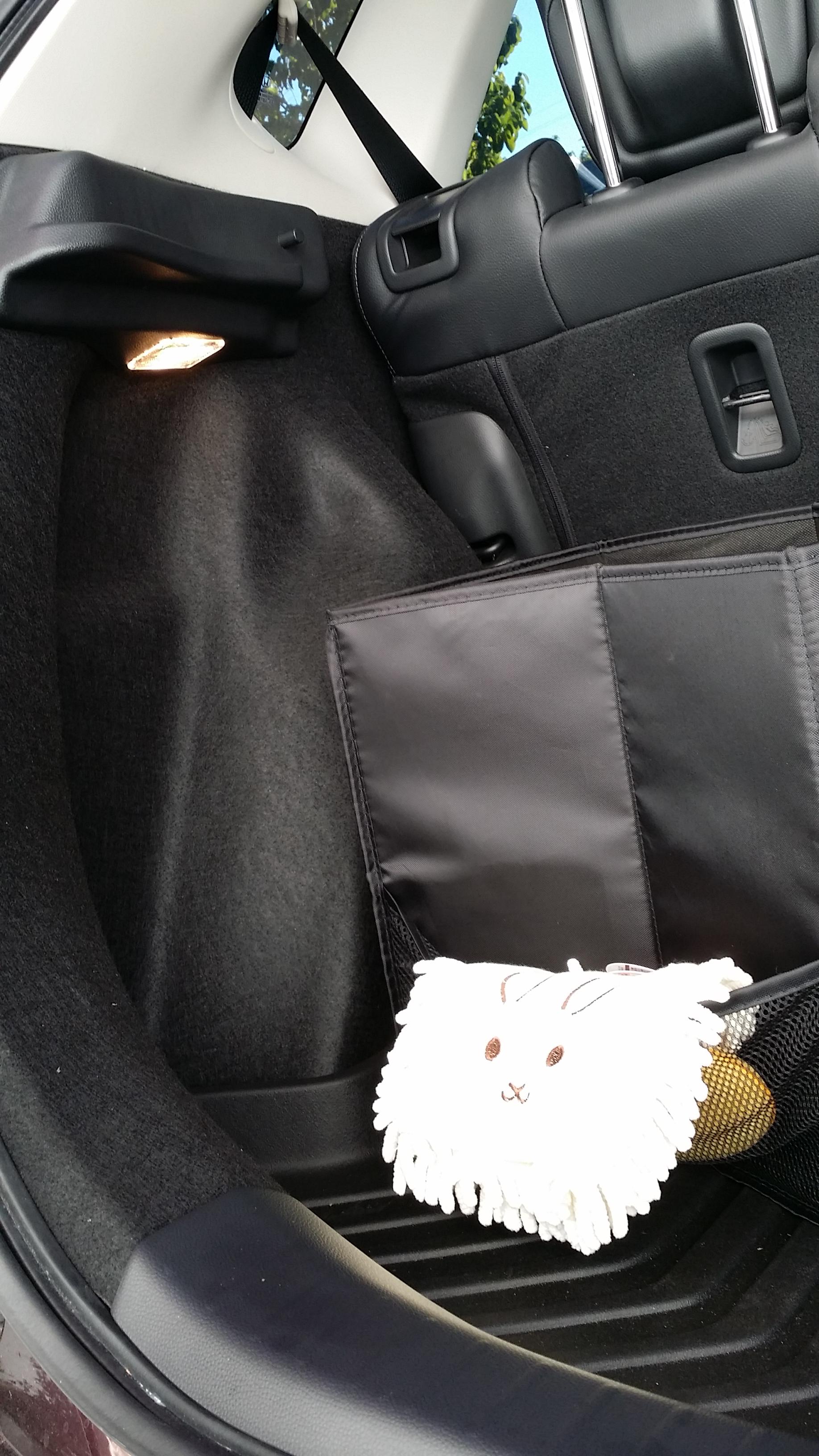

Per you guys suggestion, I swapped out the "warm white" LEDs with the "white" LEDs. I also used the ones I linked up there Lemonbest white LEDs. I had to mod the housings a little bit to fit them in.
I took these around 6 in the afternoon yesterday. When I opened the tailgate this morning at 5, my eyes were complaining they were too bright and my brain was complaining it needed more sleep.

Just wanted to add that in doing this mod you might want to use rubber grommets to the two holes the wiring goes through (pic 8) so that somewhere down the line the wiring doesn't wear through and start blowing fuses
