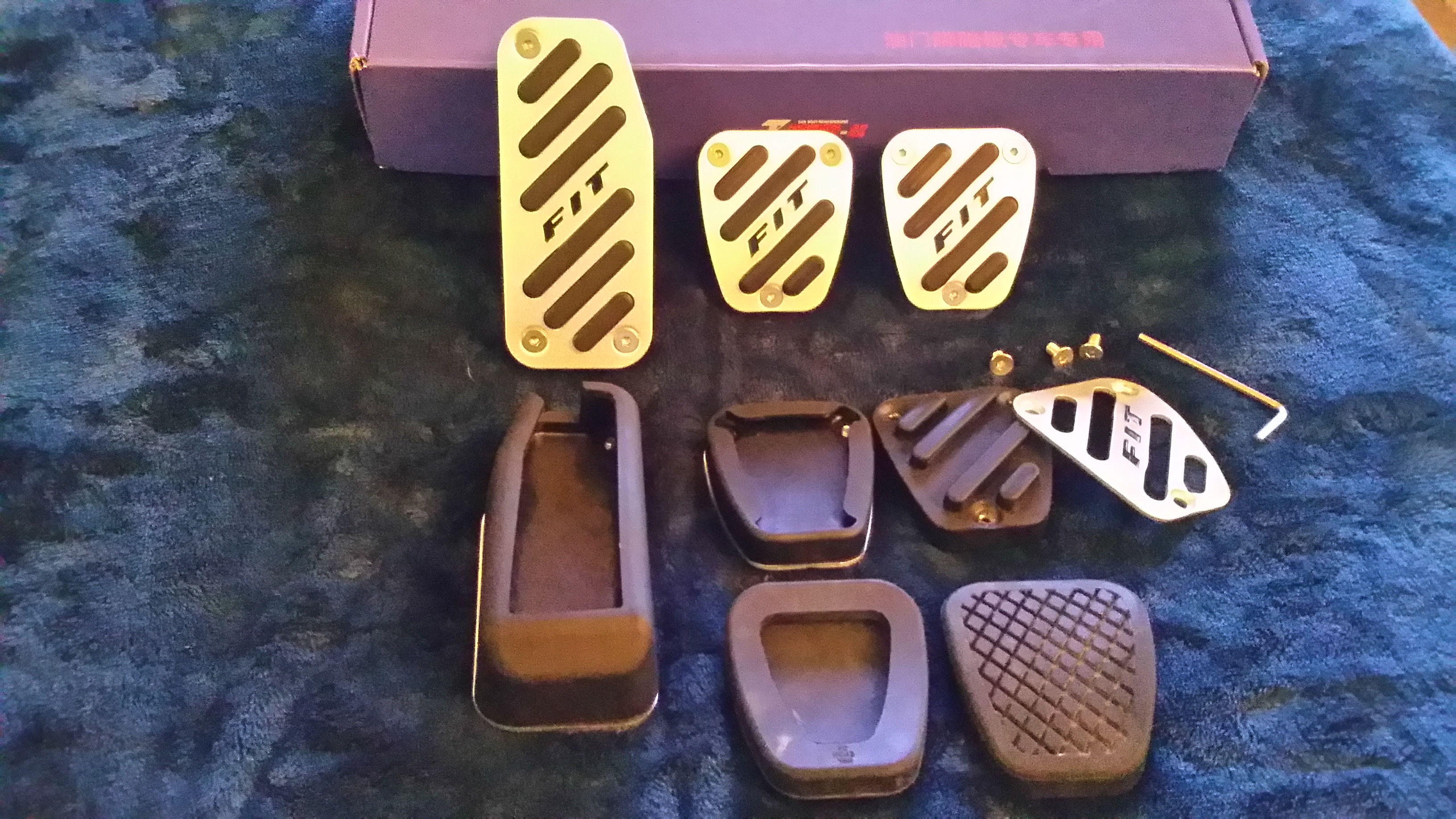

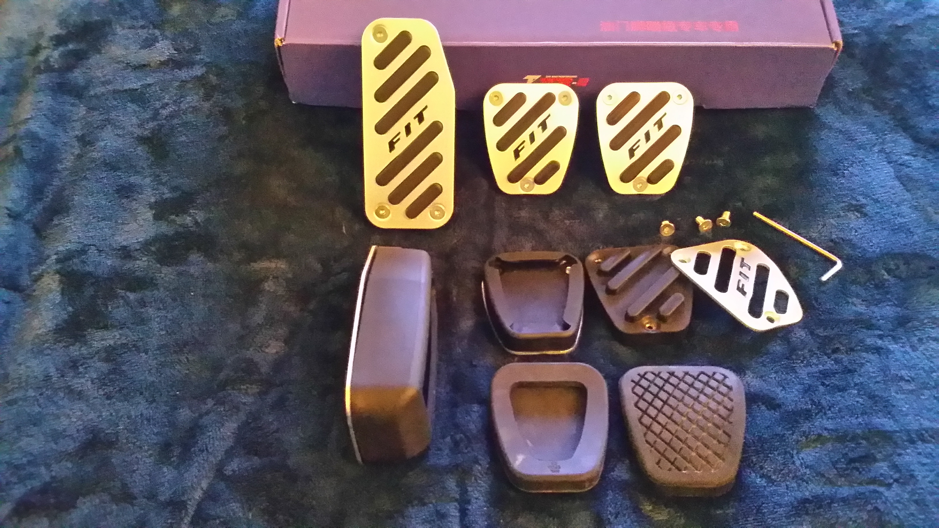

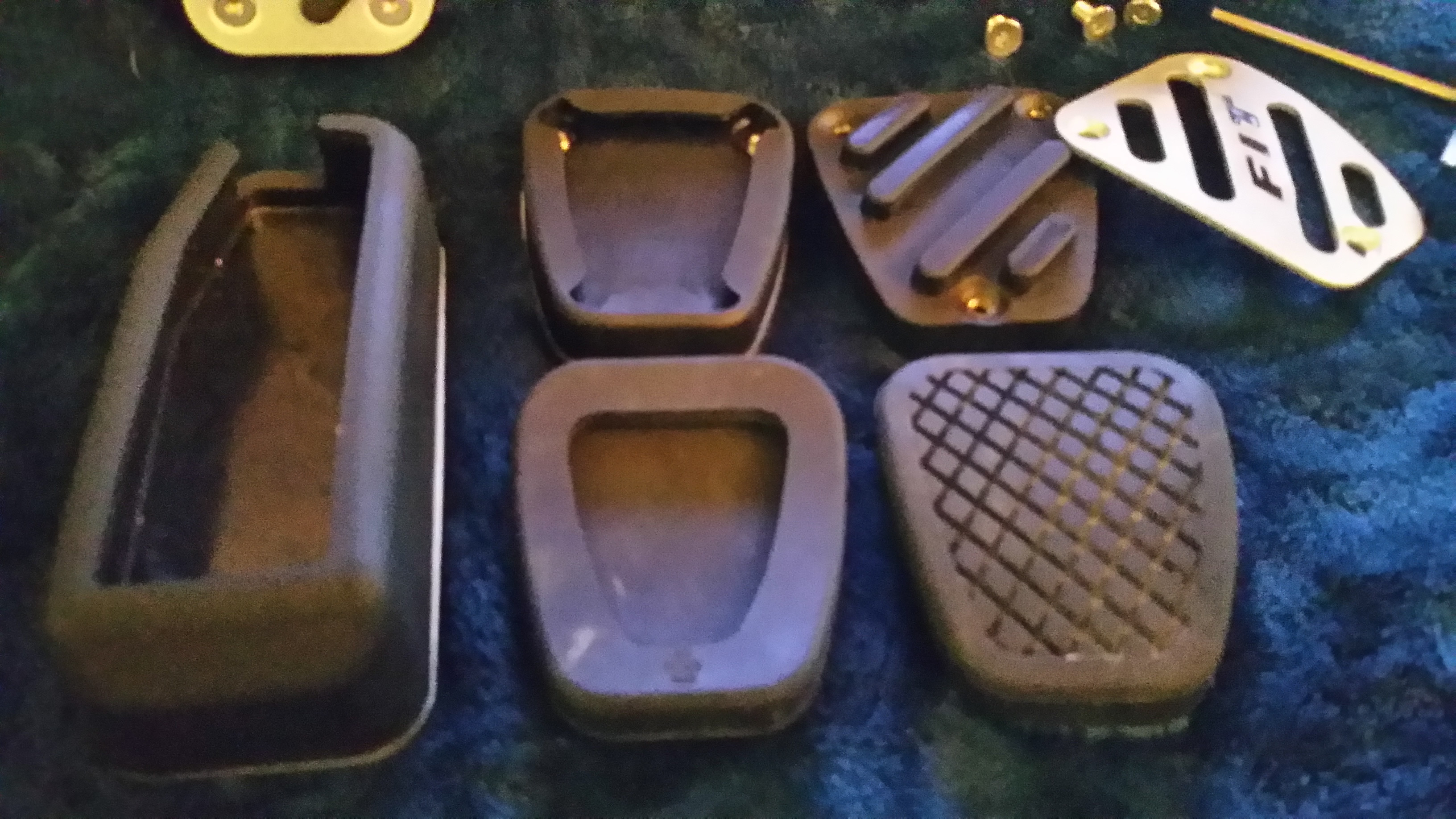

Wink Pedals easay install !
Ebay (28.50$)
1-Easy Install Fuel Brake Foot MT Pedals Pads For Honda FIT Jazz 2014 2015
2-Easy Install Fuel Brake Foot AT Pedals Pads For Honda FIT Jazz 2014 2015
Product Description:
The Ford Performance Stainless Steel Pedal Covers match the new design of the footrest make a striking addition to the foot well. The asymmetric, three dimensional design of the rubber sections gives the foot well a truly dynamic feel. The pronounced rubber profiles of the brake and clutch pedals offer good grip and protect against slipping.
1-The package included: 1 X Brake pedal 1 X Gas pedal 1X Clutch pedal
2-The package included: 1 X Brake pedal 1 X Gas pedal
Compare with pedal Honda FIT !

For the China replica pedals, do they slip over the stock rubber pedals? Or do you have to remove the stock rubber pedals first, then put on the new ones?

They're pretty nice!
You have to take the rubber off of the clutch and brake pedal and then drill holes for these. I also bought different nuts and bolts because the ones that came with it were stripping too easily. The one for the gas just goes right on and long bolts have to go through the whole thing and nut on the back. Cut these as short as possible to make sure "floored" is still available.
Loving the finish though.
