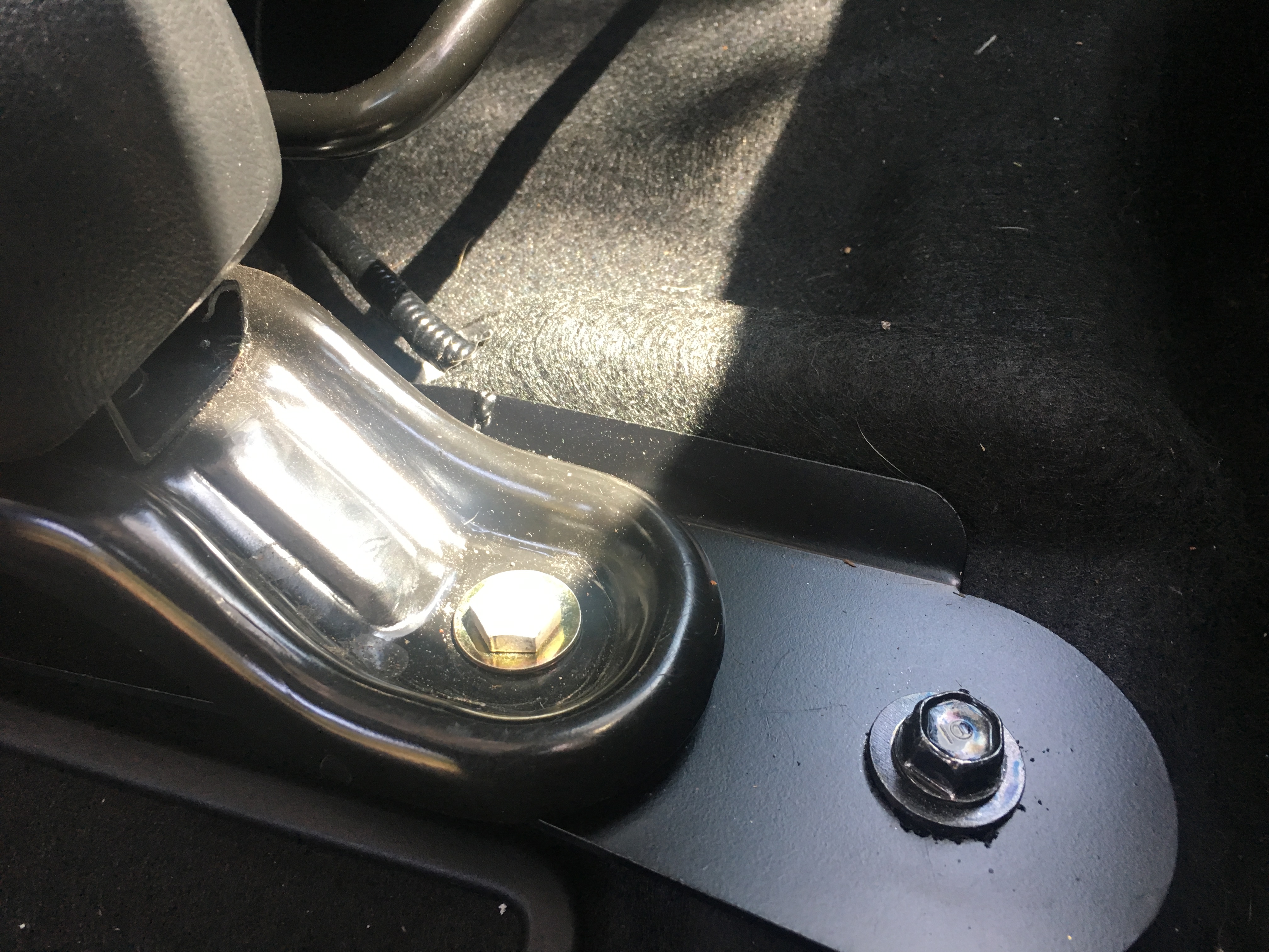

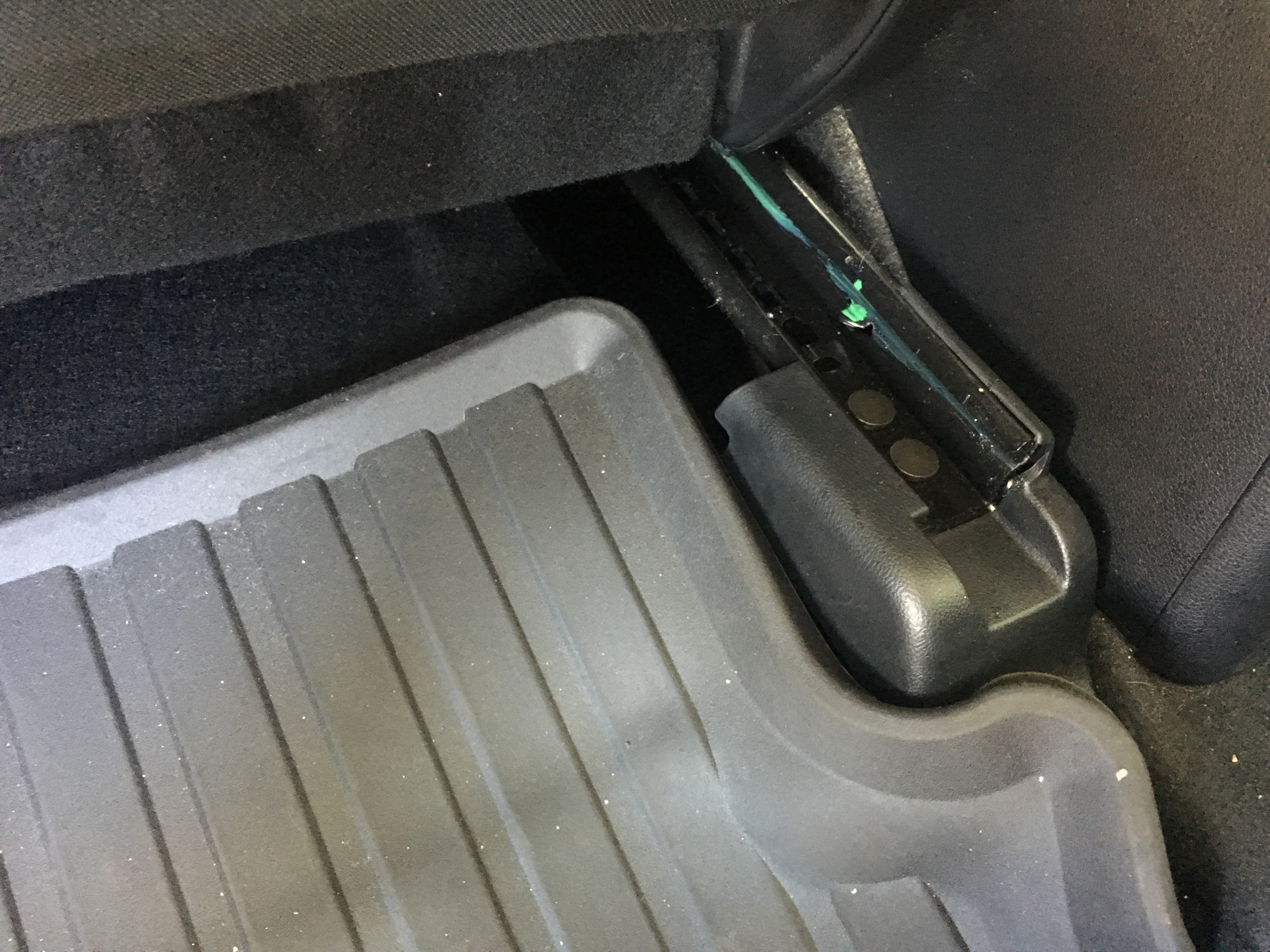

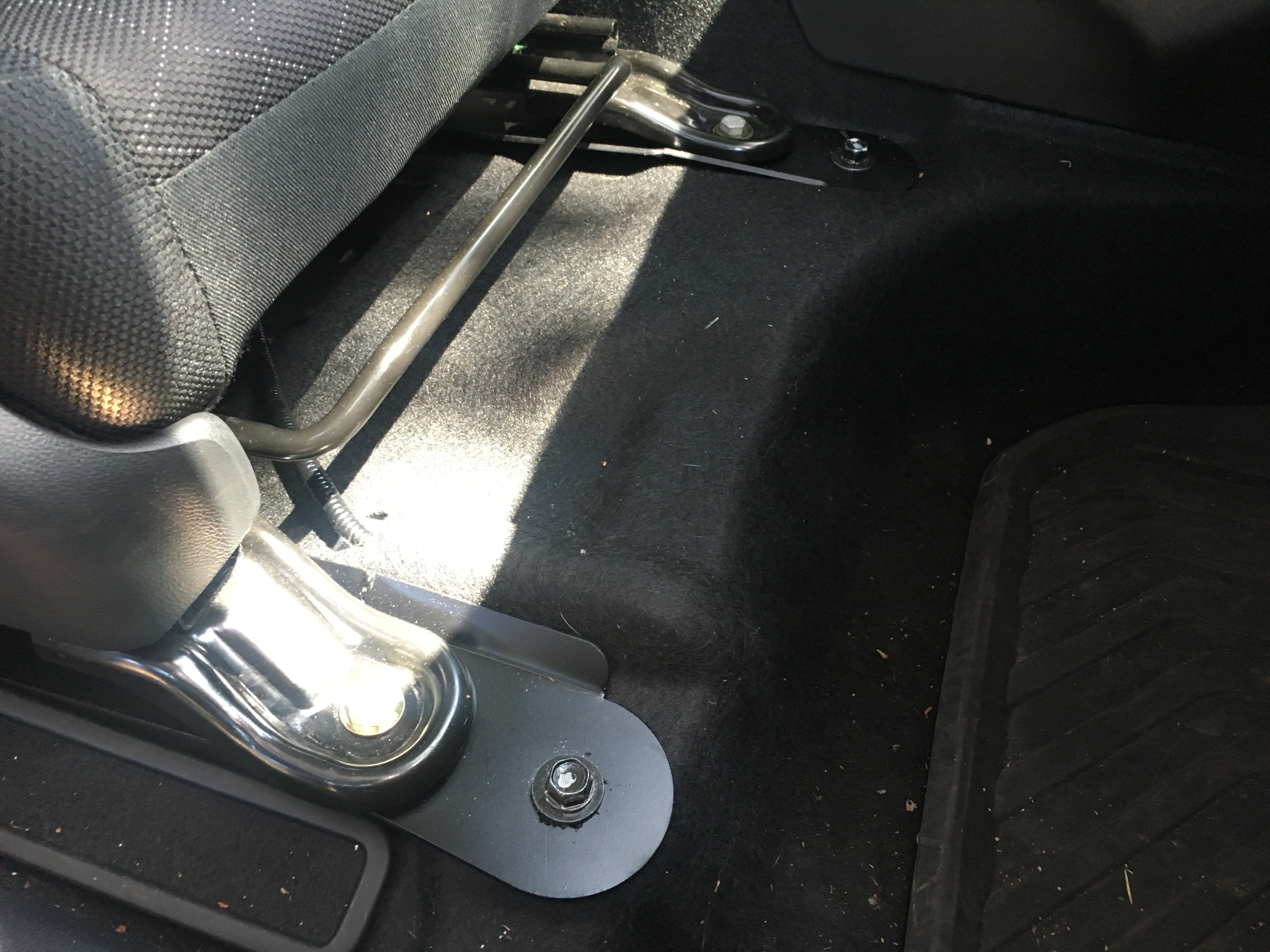

Here you go:
Changing my life!

Nice! Yup, looks like they did the strap design. Might have to pick up a pair myself. Even though I'm proud of my DIY solution, it seems pretty unanimous among experienced fabricators that you have to do it this way to be safe. Thanks for the pics, and I'm glad you're fitting into your Fit!
Did you get the driver and passenger sides done? I'm confused looking at the pics; seems mirror image or it must be of the passenger seat.

Yeah, sorry the top 2 are passenger seat, the third pic was behind the driver's seat. Here is the front driver side:
