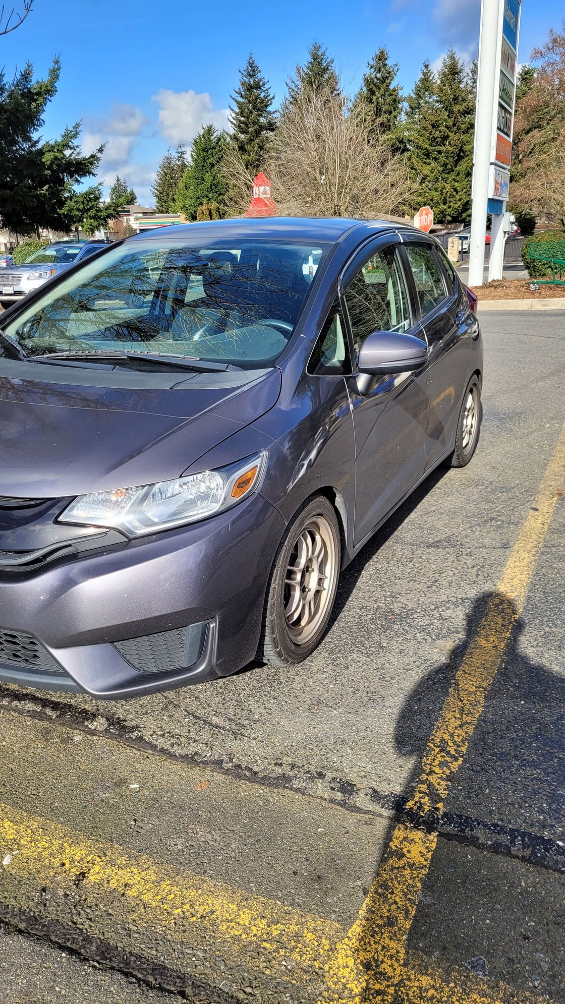

Strange, wonder if it's all in the tire profile? Took some photos of mine this morning, and it looks like significantly more difference than the 2mm in the specs.
I have Megan racing springs and as much negative camber as the adjustable bolts would allow up front, but the springs won't make any difference in the rear for this.
OP, my car has a Fastbrakes rear disc conversion. Uses Sentra discs and 9th gen Civic Si calipers, if you want rear discs its either that or having JDM parts imported. No idea what kind of pads JDM calipers would take, though.
Also, if you're looking at wheels, take some time to figure out what kind of tires you want. I wanted to go with 15x7 wheels to save weight, but I also wanted higher performance tires that just aren't available in those sizes. That left me only one option, but if you're looking at regular all season tires you have your choice. Tires on 16" wheels still have enough sidewall to keep the ride relatively soft.

I personally prefer this fitment over what my car looks like. Mine looks a bit mad-max-y and it looks more boy racer rat-ish than track day car look :s... but I meant it drives well so there's that. Wish I had fender flares on mine, but yeah your car looks like its more like 2cm not 2mm difference... weird.
