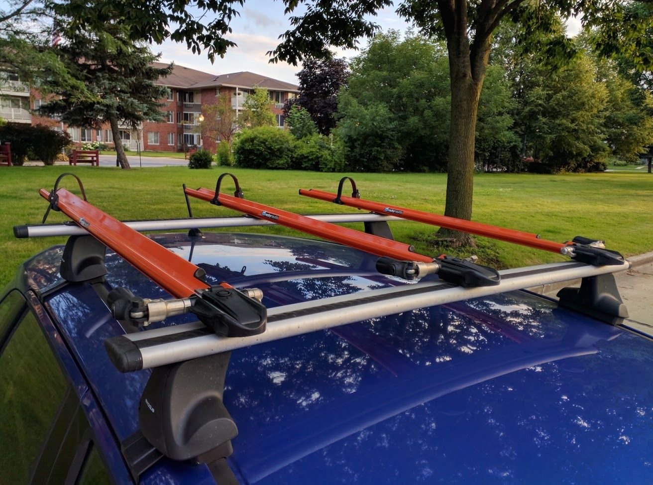

I put together a Thule-based roof rack as well, from odd components: Thule ARB47 load bars, Exodus FP4 feet (UK house brand, identical to Thule 480R), Thule 1541 Fit Kit adapters for the feet, and Rocky Mounts Jetline bike trays.
Could I remove the bike trays and install a cargo box instead? Sure, that's what it's made for.
The usual rooftop rack negatives: Decreased mpg, wind noise, weird howling occasionally. I take it off when the bike season ends.
The problem with using a cargo box for baseball supplies might be more about securing loose items than anything else. Never used a rooftop cargo box before, but you probably don't want loose balls, bats and gloves flying around as you corner. Can't be good for either the equipment or the cargo box.
Now if you fitted a cargo box with sleeves, mesh pockets or compartments for your specialized gear, different story.
I see a fair amount of used cargo boxes online. You could probably get one at fair discount this way and still have it work to your needs.

Besides a Yakima roof rack with cargo cage, I've gotten rid of the useless styrofoam jack tools holder, raised the rear hatch floor to store a lot of things. I've also got a "storage box" from Aliexpress that fits just under the rear cargo cover. Both of the latter two do eat into the vertical storage capability of the trunk a bit.
If you are carrying passengers with equipment that fills up the trunk, I'd suggest a roof rack system.
And you are right about how easy it is to dent the roof. Very thin sheetmetal.
