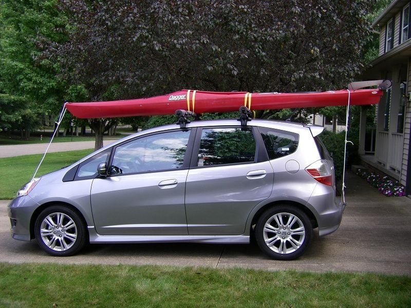

A roof rack on a short car carrying long items is not a problem. Kayakers do it all the time.

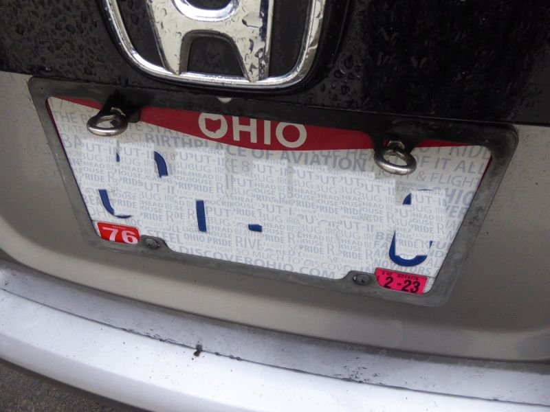

And, to hold the hatch down, just replace one or more of the license plate mounting screws with eye bolts. They're M6 thread on my '09 fit and probably the same on a 2016.

Great suggestion Ultrawolf! From there I could go to the anchor point under the car at the rear. I don't need to really crimp down on the thing, just enough to stop it from bouncing up and down while I drive 5 miles on city roads.
Is the front line on the kayak also going to the front plates, or are you using the shipping anchor behind the circular port on the bumper?

For my front tie down, I was able to feed a loop of webbing in through a slot in the grill (below the bumper) and anchor that to the framework that holds the hood latch mechanism. But it's much easier to use "hood loops". Just search for "kayak hood loops" on Amazon. I would not use the license plate method for the front tie down as that tie down needs to be pretty strong.

@Brain Champagne Did you have a way for keeping the hatch mostly closed while doing that? I've had one suggestion so far but would welcome others addressing that specific issue. Right now using a ring bolt to the license plate bolt hole and then connecting this to the shipping anchor ring under the car seems to be the only way. When my wife gets back with the car I could see if it might be possibly to instead attach the upper connection to the middle passenger seatbelt, over the top of the hatch, then lead it down the outside of the hatch to the shipping anchor connector. It used to be a lot easier with the old style bumper where I just looped the whole thing around the bumper. These new ones may help with reduced drag but you can't tie anything to them.

I'm interested in some of the ideas shown but I don't like the idea of making the license plate mounts do that much extra work. I also have a problem with the hood attachments shown. They are neat and I like the ingenuity of them but I don't want extra stress pulling the hood up especially on the highway. Again, I like the thought into these ideas but I wouldn't trust them.

Note that I don't use this method. The latch mechanism looks kind of plasticky and I'd rather not risk damaging it. I'd much rather risk damaging a license plate mount using the ring bolt method.
