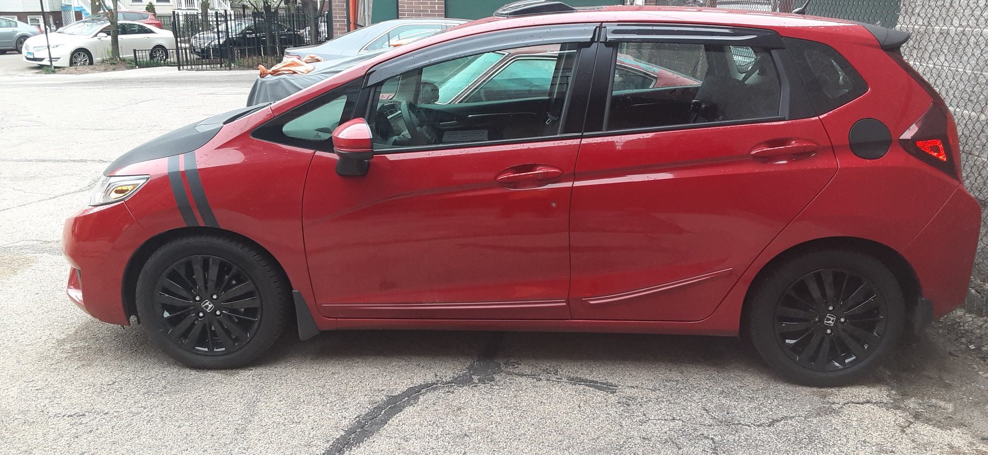

Old Jul 7, 2023 | 12:04 AM
  #49
Chitown Fit's Avatar
Joined: Jan 2015
Posts: 1,028
From: Chicago
2015 EX Stick With Black Sport Wheels.
