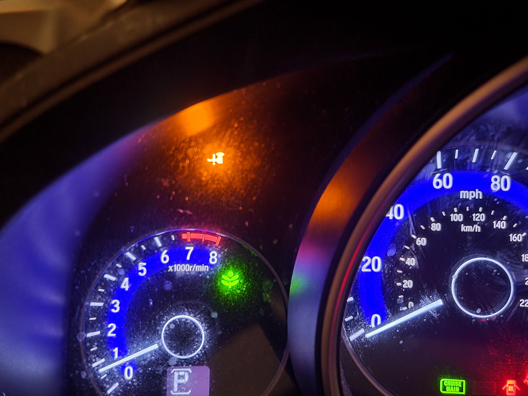

Is the start symbol in the instrument panel lit up and stays on? Then that's the switch issue. (had mine replaced and the previous owner had the starter replaced.)

Start symbol is not displayed. In fact, nothing is displayed and there is no code whatsoever. I've been working on cars for years and this is the one of weirdest problems I've ever seen. The only thing I've noticed is -10% fuel trim at idle which might be pointing to fuel injectors.

Well, I was just at Walmart and 5 presses in a row the car started then died within a second. IT is the smart system with a key light I've been waiting for. It is not the MAF sensor I don't think at this point. I'm dropping off the car tomorrow morning to get this warranty fixed.

Which now confirms my theory of the bad start switch.
Same issue as the Jeep I had which started up then ran for 1-2 seconds then cut out due to immobilizer issue. Key RFID reader not authenticating with the Key ID.
In this case.. the push start switch is probably not authenticating with the Key ID.
