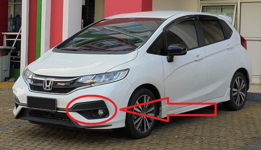

Hey,
how can i remove the Foglight Cover from the Fit Rs?
I Found many YouTube videos but nothing from the Fit RS.

I do not own an RS but I recently removed the fog lights housing on my base model Fit 2019.
The fog lights are attached with several clips around the edges and a single screw which holds in place.
As a result, it would be nearly impossible to remove the fog light housing without first removing the front bumper.
