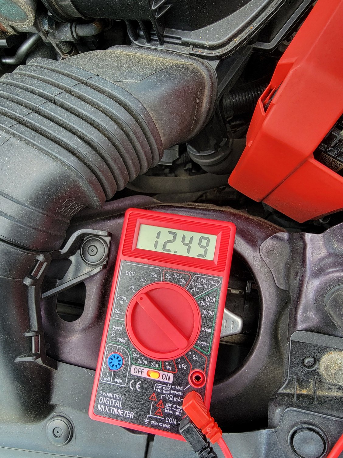

Testing
Originally Posted by woof
Total baloney from the guy at Autozone. The Fit will run equally well on either the smaller OEM 151R battery or the larger 51R battery. The larger capacity battery simply gives you better performance in cold weather starting, a longer lifetime, better resistance to small parasitic drains, etc. and since it costs virtually the same it's a better buy. Your problem does not appear to be battery related unless as mentioned it is a bad ground or a parasitic draw (technically neither is the battery's fault). I have incidentally put an oversized battery in virtually every car I've ever owned. I even had to bend the radiator on my old Camry in order to jam my bigger battery in - not really a smart thing to do but that was in the days when I was young and stupid. (Now I'm just old and stupid)
So honestly I'm just stumped. I tested the battery, alternator and looked for a parasitic draw.
So I tested the alternator directly and it's reading out 14.3-14.4.
The battery was around 12.49 after letting it sit for 45 minutes after I got back from work. As I was reading to let it sit for a while before testing to rule out anomalies from the computer etc.
I tested for a parasitic draw and at first got a read out of 0.91 and it settled to 0.23 and dropped bottoming out at 0.17 or so, but never went back up.
We have been experiencing temps in the upper 90s this week and 97 for the past 3 days or so. So I'm wondering if the little guy is having problems in this heat. When I went to test the alternator the car started right up with 0 issues.
Battery before testing
Output under load at battery and at the alternator it was reading out at 14.41.
Parasitic first read out
Parasitic after a few seconds
