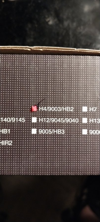

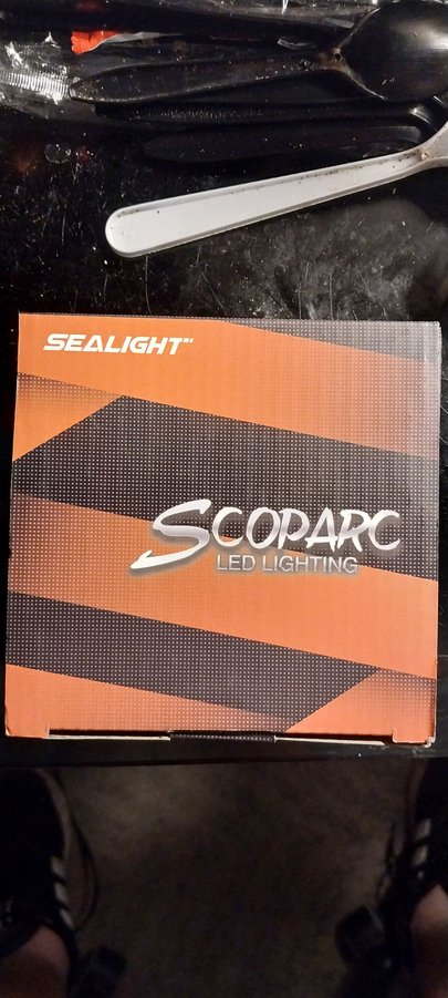

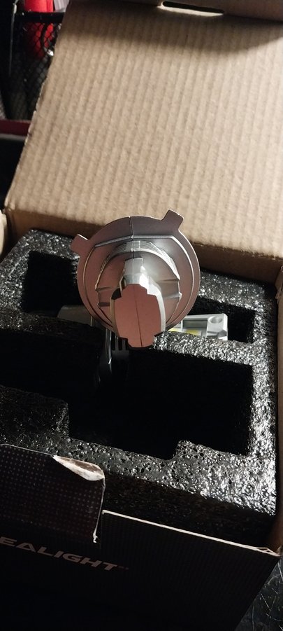

My LED Lights.
These LED lights are non adjustable. They fit right into the three headlight tabs like the Halogen bulbs. So there's no adjusting needed.

Thanks! I have to write more to make this an official reply. I can't think of anything to write, though! 😳
EDITED: Are these the ones you got? They list quite a few, but most are listed as "Fog Lights."
Amazon.com: SEALIGHT H4/9003/HB2 Bulbs, 36000LM Super Bright 9003 Driving Lights, 6000K Daylight White with Cooling Fan, HB2/H4 Car Fog Bulb 5 Min Plug-N-Play, Pack of 2 : Automotive Amazon.com: SEALIGHT H4/9003/HB2 Bulbs, 36000LM Super Bright 9003 Driving Lights, 6000K Daylight White with Cooling Fan, HB2/H4 Car Fog Bulb 5 Min Plug-N-Play, Pack of 2 : Automotive
The US Department of Transportation (DOT) has no standard that allows for LED retrofits in headlamps designed for halogen bulbs. The requirements for auxiliary lighting (driving lights, fog lights) are apparently less stringent, or at least confuse the issue enough to sidestep an outright ban.
