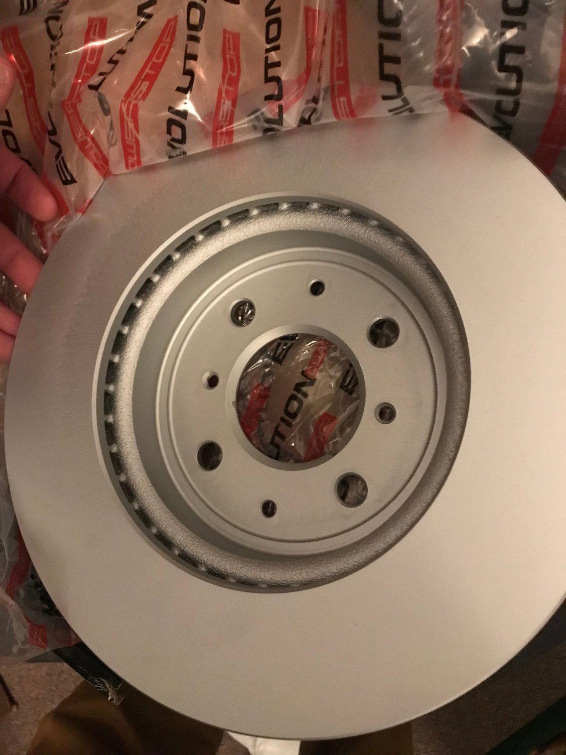

I always buy fully coated rotors. There,s power stop and Raybestos with their Evolution Geomet and Element3. I'm sure these are probably equivalent and I was very impressed by the quality. I've bought the partially coated/painted rotors, even higher end ones and they always rust to $h**. The fully coated look great and do resist rust longer.
One reason that I'm not going Akebono is that they have a very long longevity. Seems counter intuitive but my rotors end up being all crusty and rusted and need replacing and my brakes will still have a good 1/4 inch of meat on them. So its pointless to pay a premium for great pads if they outlast the rotors. I do drive manual transmission so that is part of the reason I don't wear my brakes down very fast.

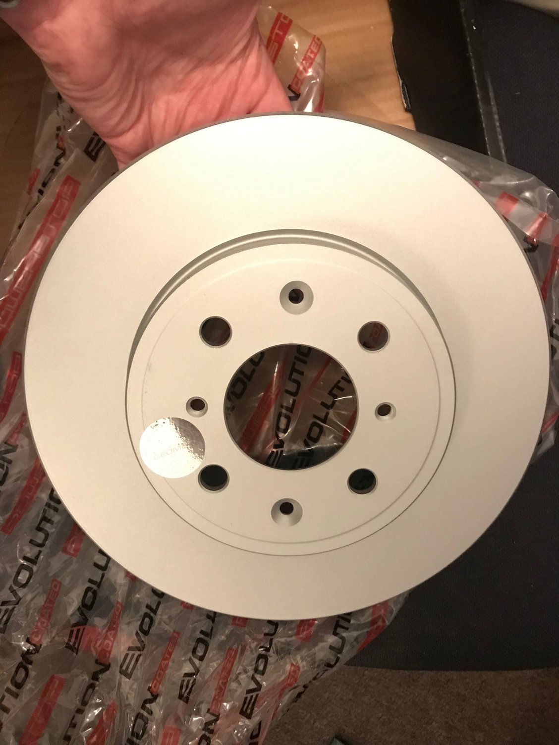

here are some pics of my Powerstop Evolution Geomet fully coated rotors. A great value rotor with good corrosion resistance IMO.
