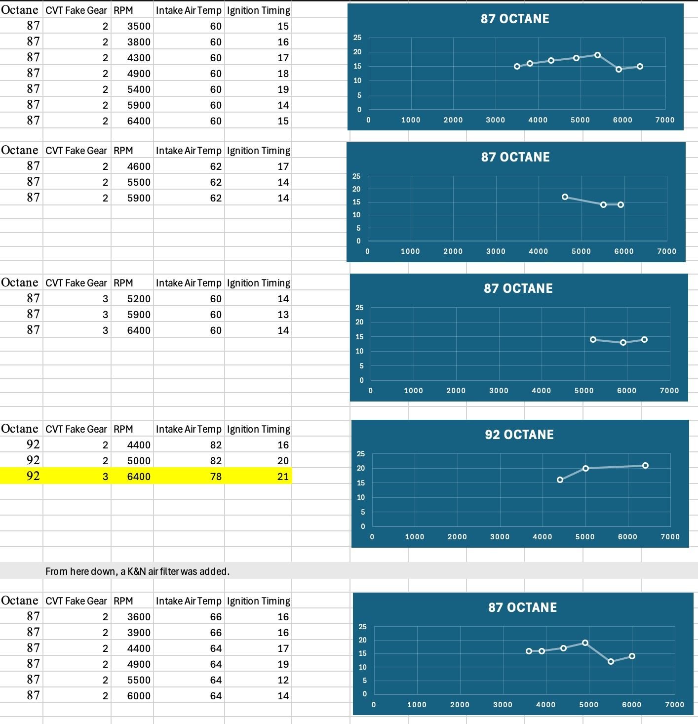

The ‘what octane? - what gas?’ questions will of course go on for as long as we burn gasoline. This thread is not an attempt to start another one of those threads. I am also not going to attempt to deep dive into engineering terminology and more. I simply want to share a little about my experience and share fairly accurate data I have accumulated.
Car: 2018 EX CVT, using Sport Mode and Paddle Shift. Mileage is around 75,000 miles.
Modifications: No performance Mods
Future Mods: Changing to K&N Filter from a Wix that has maybe 10,000 miles.
Controlling what octane is used: I am attempting to fill up when I need about 9 gallons of gas. So…. It’s not perfect, but now you know.
Data gathering: iPhone on video, pointed at a ScanGauge2, then review video later.
Acceleration method: Pedal to the floor
Location: A safe place. Also, flooring a Fit in 2nd gear isn’t going to wake the neighborhood.
The primary reason using an octane rating is talked about is because it is the method used to explain at what point gasoline detonates when heat and pressure are applied. Years ago, like 30+ years ago, and further back, it was common to “advance the timing” of the engine and then commit to running premium fuel. I believe 2-3 degrees was common, and just like today, increases in horsepower was debated. Usually people saying, “I think I can tell.” So, my curious side wants to know if the Fit will advance the timing 2-3 degrees when the sensors can tell there is higher octane fuel being used. I believe the “knock - detonation” sensor is critical for supporting this judgement. I’m sure MAF and Intake Temp come into play with this too.
I will edit this original post as I gather more information. Each group of numbers is data from a single acceleration. I only get a tank of fuel every 2+ weeks, so octane changes will not come in too quickly.

Fascinating.
Please continue gathering data.

Indeed fascinating. I don't know what we're talking about yet, but I will try to follow along.
Are we supposed to see the Ignition Timing column produce higher numbers with the higher octane fuel?

Yes, sort of, probably…. Haha.
Generally speaking, the ECM is going to take a look at the mass airflow, knock sensor, and intake air temp and try to make good decisions. There could be more to it, but generally speaking octane is going to influence it along with those other readings.
And in most cases, I believe you’re right in your question. Higher octane, more advanced, higher number.

Current short-term goals, so everyone knows where I hope to go with this:
  • Gather 5-10 more pulls with this 87 octane that is in the car now.
  • Drive through gas station from last tank of “premium” and see if it was 91 or 92, update table if needed.
  • Next tank go to 93 octane
  • The VERY tiny amount of data gathered has me curious why the timing pulls back so much around 5300rpm. I am sure I need to understand variable valve timing and where it starts to step into the equation.
  • The microscopic amount of time I have with higher octane, the car did not pull timing at higher RPM.
  • I want to see what differences occur with 3rd and 4th high rpm, probably merging onto the highway.

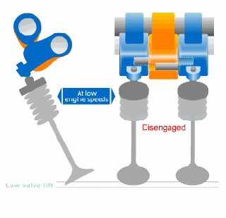

Due to EPA regulations no. Cam profiles are small to minimize pollution and make your car run efficient at low rpms. V-Tech is nice as it adds a second profile that really opens up the flow of air at higher rpms. See illustration:
V-TECH
V-TECH

I like that image. Thanks.
I love VTEC.

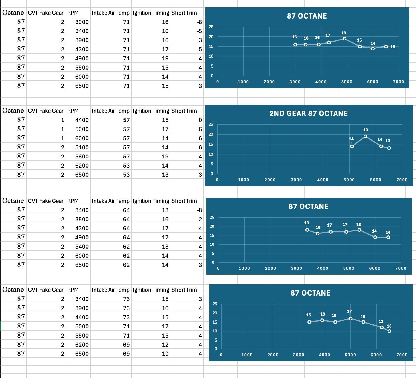

Posting in the thread seems easier than editing the first post each time. I accidentally deleted the entire first post for a moment…. Luckily it was open on my laptop.
A lot of 87 octane data…. 93 octane coming soon, hopefully less than a week.

interesting study . in the 92 octane chart does that air intake temp have to do with the ambient temp at the time ? i remember reading about a test with
a Honda CRV using different octanes . it did show a slight increase in performance and mileage with the higher octane fuel , which is counter to the
general narrative that it makes no difference . at any rate the Honda's computer is doing some very clever stuff with it's ignition and fuel mapping .

Air intake temp is really the air intake temp. If I idle it will go well above ambient and even if balanced, it will fall quickly just by jumping on the throttle.
It does increase performance, I think most just don’t see the value in the small gain, or maybe cannot feel the gain.
More to come….

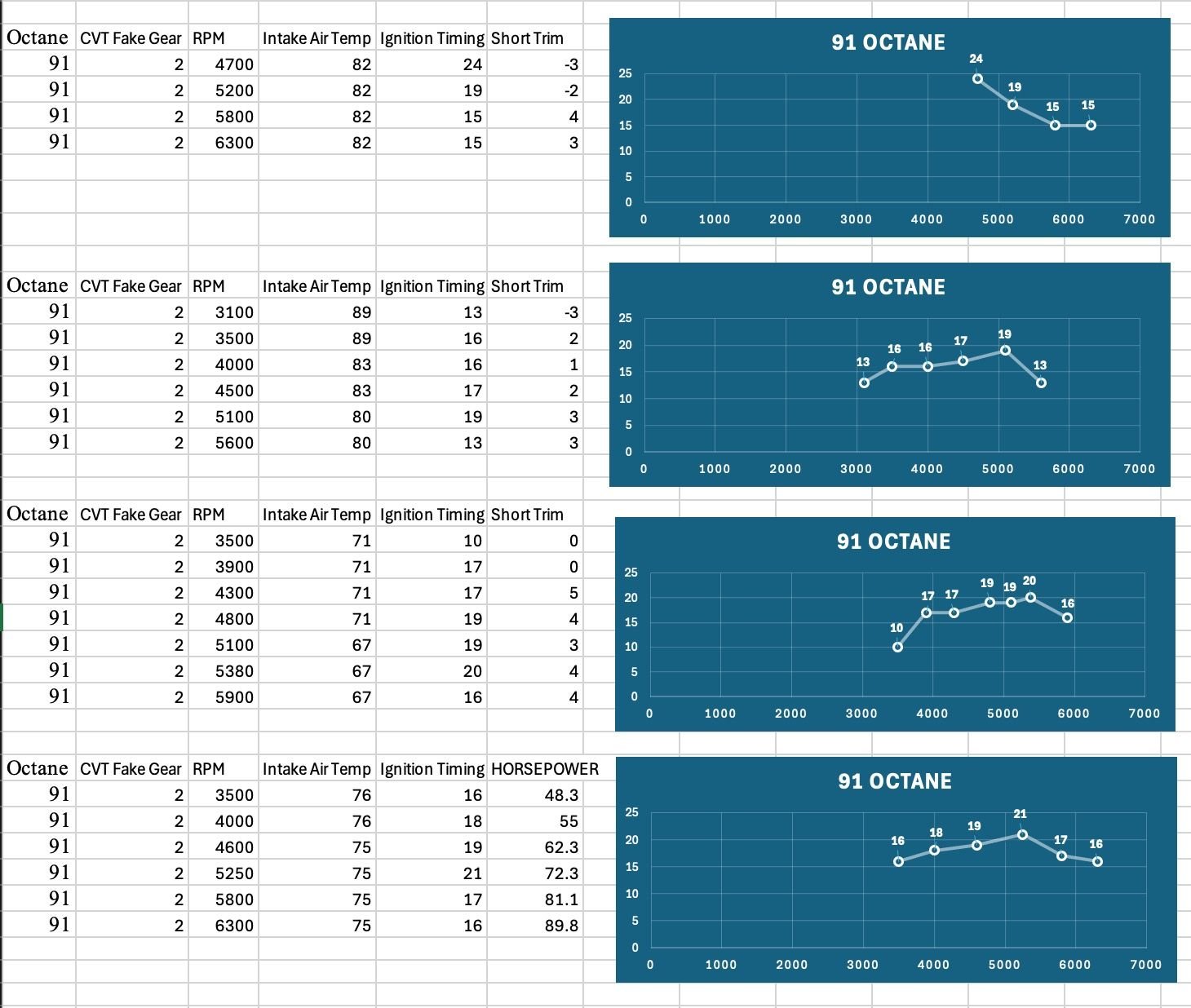

91 octane in the tank for this post…. I did the math based on adding 93, multiplied by the gallons added, and then added the gallons that should have been left, with those multiplied by 87. Then divided by the tank size. It worked out to 91.2. It is not scientific, but as honest as I can get.

I don't have them side by side, but it appears your timing hangs out closer to 20 deg. for longer than the 89 octane.
