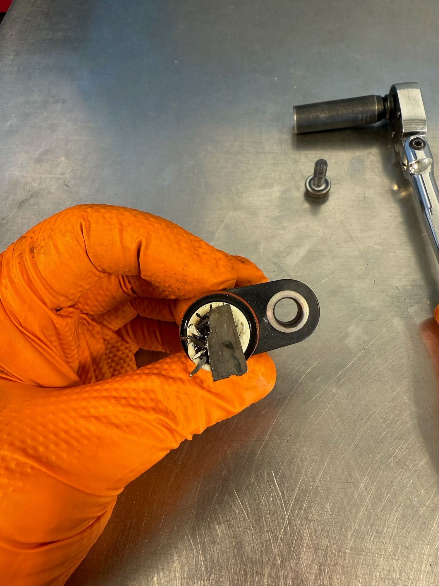

Hi all,
I was just recently driving up a hill, felt my car stutter and buckle and after a second of regaining my composure my spider sense said the transmission just shit out. I've had the car since it was brand new. There was an issue with the fuel injectors which was covered under warranty luckily. Otherwise it's been really decent, had to do the starter this past summer but it wasn't crazy and I've gotten a lot of good miles out of it.
For the first 70k or so miles I had it serviced at dealership only. They did transmission fluid at 50k, brought it to another dealer at 98k for another fluid job. I had been warned about all the issues with CVT ( of course after I purchased it ) but felt like I was keeping up with it.
Anyway I was able to make it back home in limp mode - ran the codes and got P0793 and P0796... sensor and a solenoid. I figured I'd just bring it in to the dealership to let them run through the real procedure to troubleshoot instead of trying to replace the sensor on my own and maybe not even fix it.
They got to work on it today and sent me this image from when they tried to remove the sensor. I don't know "exactly" what I'm looking at but it looks like a whole chunk of the exterior pulley casing and a ton of shards from the death of my belts ? In any case this thing is fucked.
r/hondafit - sad. sad.Ok so that's the situation. Of course Honda dealer at first says 6k for the replacement and they could cut a great deal at 5.5k. It goes without saying that that's not an option for me at all. I haven't gotten quotes from smaller shops but I'm sure it wouldn't be that much less.
So I'm pretty fucked here. My only thought is to try and find a reasonable replacement so I can get some more life out of the car. As far as I can tell everything else is in decent shape; e.g. just got new tires, brakes and start in the last 10k miles. My options with replacing it as far as I can see from here are:
  1. Shop around for a good mechanic/shop that will take pity on my sorry situation and find a decent option.
  2. Grab a used/refurbished box and try to find a mechanic that would be able to do the work.
- With this and the next option my greatest concern is that any transmission that's reasonably priced has 100K + miles on it anyway !
3. Grab a used/refurbished one and wrench on it myself over the summer. I know this is a kind of crazy option and I've only done way lighter work on my cars in the past but this kind of seems like a total loss situation anyway ( i'm likely going to get a different car ) and maybe being able to salvage it on the cheap will work out decently. The transmissions look pretty hefty too so this also seems insane without a lift and decent shop space.
Anyone have experience going down any of these roads and able to provide some guidance? Aside from this godforsaken CVT trash that they stuck it with I really do love the car. I've got a kind of 4th option too as I live close to Tijuana and have some friends who know mechanics down there... do I go that way? I've seen several threads where this issue is brought up and also just wanted to post this to vent/commiserate with those about to go through it too. Thanks for reading!
tldr: fuck CVT.

Here's an image of the mangled trans the dealer sent:

That is unfortunate.
Do you have other transportation? You mention trying to do the repair/replacement yourself "over the summer" which implies you're not in a hurry. That would certainly be cheaper than paying the dealership or an independent mechanic to do the work, with the downside that that you have to DIY with all the pain and frustration that can produce.
It would certainly be worth investigating getting the car repaired in Mexico. Replacing a transmission is not difficult, assuming you have proper facilities, tools, and/or a lot of gumption. Most of the price you will pay a mechanic comes down to labor, so if you can pay less for that labor you will save money.
It would also be worth calling around to junkyards and spending some time on Craigslist, Marketplace, or similar. Cars get in accidents all the time, so it's not unreasonable that you could find a lower mileage Fit that had been rear-ended and get a good deal on a transmission.
Having said all that, you also mentioned that you're probably going to get a different car, in which case you should spend some time thinking about the economics of paying a professional to repair your car or your time investment if you attempt to DIY. In either scenario, will you recover your investment of money/time through continued use of the car or a higher sale price?

Shop owner here. Your best route is just a used swap and maybe re seal. Lots of times that's not necessary, but it wouldn't hurt. Hardest part is most CVTs have a somewhat technical fill process - get it 1/4 of a qt of, it can act up. So follow it as closely as possible. You could probably get away with taller stands (make sure to lock em good), I think you'll drop the subframe. After that it stays pretty simple.
I tell people shoulda gone manual. Theres a price to pay for convenience! (Almost 205,000 mi on stock clutch for mine). Be well man. Hope everything works out.

I've found a few used ones for 1200-1800. Factory re-manufactured it seems like Honda wants 4200 . In that light the shop quote of 5,500 for full install doesn't even seem too bad
