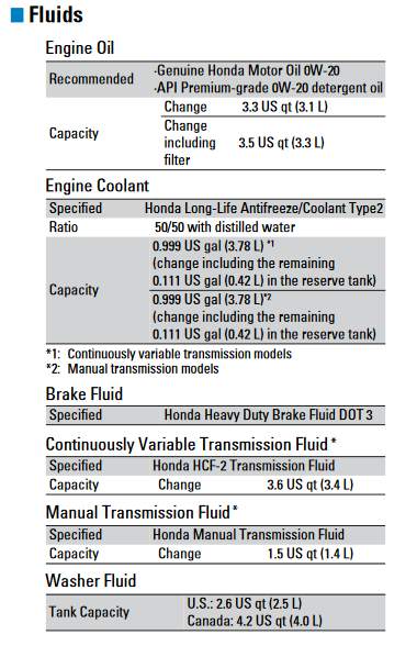

Did you do the work with the front of the car on ramps or with the car lifted and level? You always check the transmission level or do transmission work with the car level.
I don't know anything about the capacity of your CVT so can't speak specifically to whether 4 quarts should be enough for a drain and refill. Your owners manual should give you that information.
OK, here's a screen capture from the 2016 owner's manual (easily found online) that says the CVT fluid capacity is 3.6 US quarts. If you added 4 quarts and fluid isn't running out of the middle fill-level hole something seems to be wrong.
