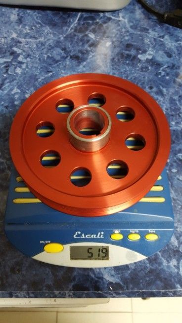

Stock crank pulley --> 3.41lbs
Custom NST crank pulley --> 1.14lbs -2.27lbs
