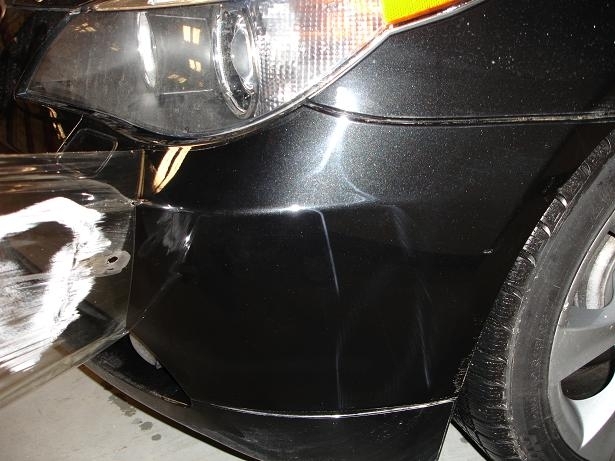

I plan on installing a clear bra.

Google clear bra saved paint.
