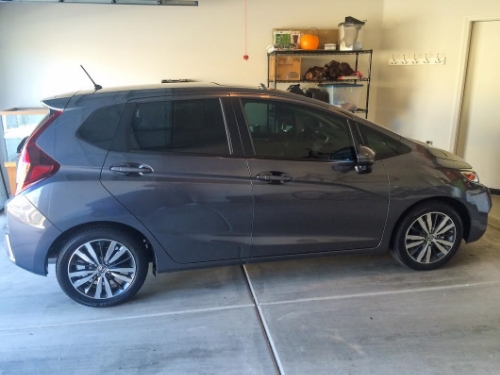

Hey guys, I'm new to the forum and just purchased my Fit about a week ago. Name:  d6b86b4a-21ab-4070-b6dc-eec79fff6a64_zps57a68f02.jpg
I've been following the forum for about a month now and I'm excited to start my mods. I'm new to this all and had a couple questions.
I know the first thing i want to do is lower it. I've done some research on my own but I'm still a bit hazy on a few things. I've been looking a different coilcover sets trying to compare and thought I would get some other opinions. I've included the links to the two options that I could find below (don't hesitate to suggest other options as well).
And just fyi this is my daily driver. I'm not going to be taking it to the track but in the future I do want to make some performance mods. If there is anything else I might need as far as lowering the car to prevent camber issues/any issues down the road suggestions are greatly appreciated.
