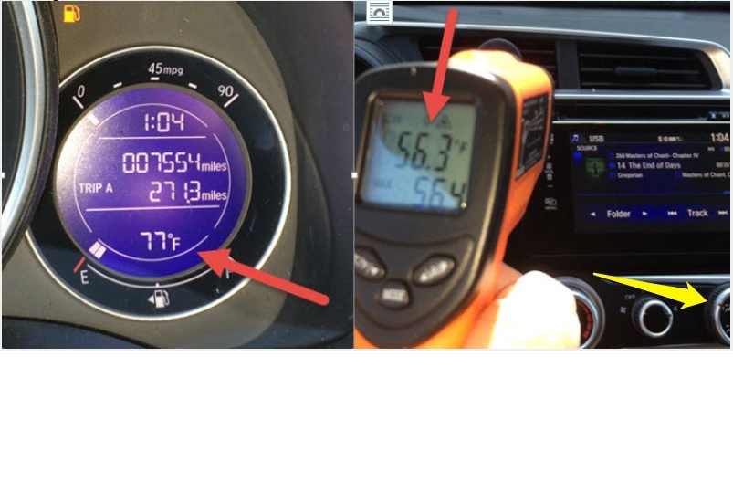

So I did a measurement today on the AC:
1. I had the AC on full blast for over 30 mins while I drove to work today (25 miles).
2. When I got to the parking lot, I moved to re-circulate air.
3. I took out the non-contact infrared digital thermometer and did a reading while the AC is blasting at max cold/fan. Please see picture for ref to outside temp and what I am getting off the AC.
4. Looks like I need to take it into the dealer to check it out. Seem like others are saying, I should get around mid 40s blowing from the vent if my AC is working as it should.
Ref Image:
Hmm
Maybe you should try a lower fan setting. On "full blast" you are probably pushing the air through the evaporator so fast that it doesn't have a chance to cool. For this reason, I seldom run the AC fan over setting 2, and I seem to get plenty of cold air.

42 is a good vent temperature. With at least 35 degrees difference (40 is better) between input air (either outside or recirculate) and output air (the vent)

Here are some facts applicable to the situation. I am not a novice when it comes to automotive AC. I owned and managed a shop specializing in automotive heating and cooling system repair for thirteen years. When I performance test a system, it is done in the following manner. (1) Car parked in shade. (2) Blower fan set at one position above low with the system running in recirculate mode. (3) Digital thermometer inserted into center dash vent opening. (4) Engine speed held at a steady 2000 rpm.
The vast majority of vehicles will display a 5* variance in temps as the compressor cycles on and off during the test. The compressor cycles to maintain safe refrigerant pressures in the system and to avoid an icing up of the system.
I tested my car when I came home today in accordance with the steps shown above. Additionally, I had the Economy mode turned off. My vehicle would pull down to 42*F before the compressor cycled off. The temp would climb to 47-48*F and the compressor would start again. That sounds like pretty good cooling to someone not familiar with AC capabilities; but it wouldn't hold the interior temps of my car at a comfortable level while the outside temps were only a balmy 87*F. When I had my shop, I tried not to let any car leave the shop unless it would pull a vent temp lower than 40*. Oh, I failed to mention that my car is white and has all the glass tinted at 35%.
I will put some gauges on it tomorrow and see what's happening. R134a is very sensitive to pressure irregularities; so, maybe, it's something as simple as that. I just hope Honda hasn't fielded a less than adequate system.

I did finally get some gauges on my car and found it to be a little low on refrigerant. I added a few ounces; and now the compressor cycling range varies between 38*F and 43*F. I haven't tried to drive it with everything heat soaked to see how quickly it will cool down yet.
