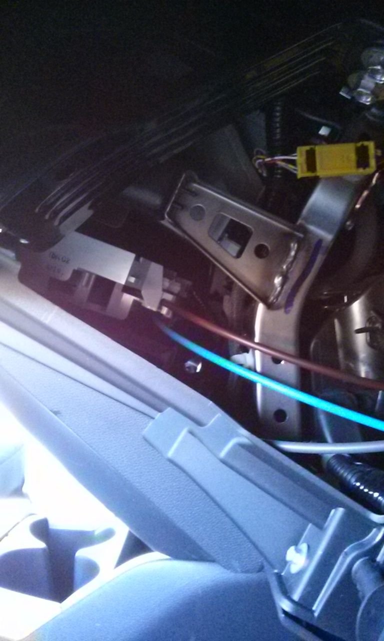

1. Take the glove box out by pinching the sides in to tilt it out of the dashboard and then pull the hinged bottom to remove it - follow the blue wire to find the climate control unit.

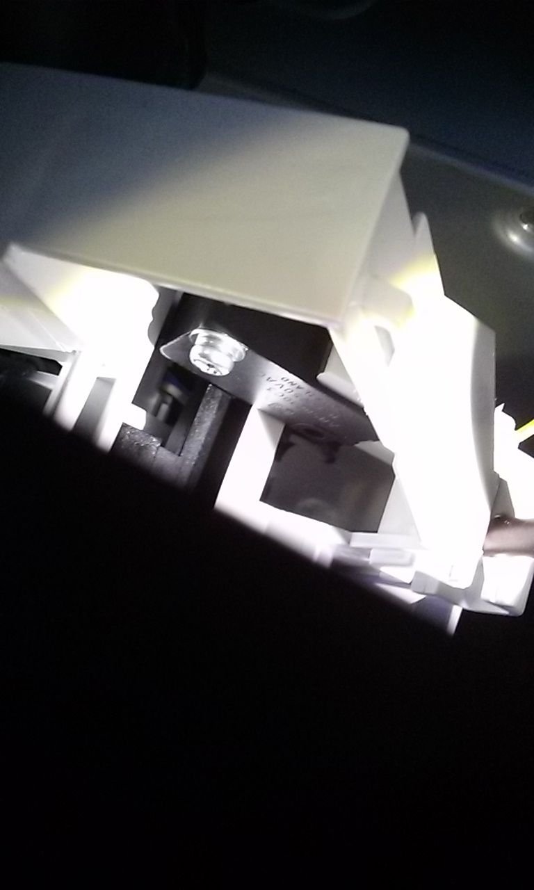

2. Here is the back of the climate control unit, white plastic structure on passenger side.

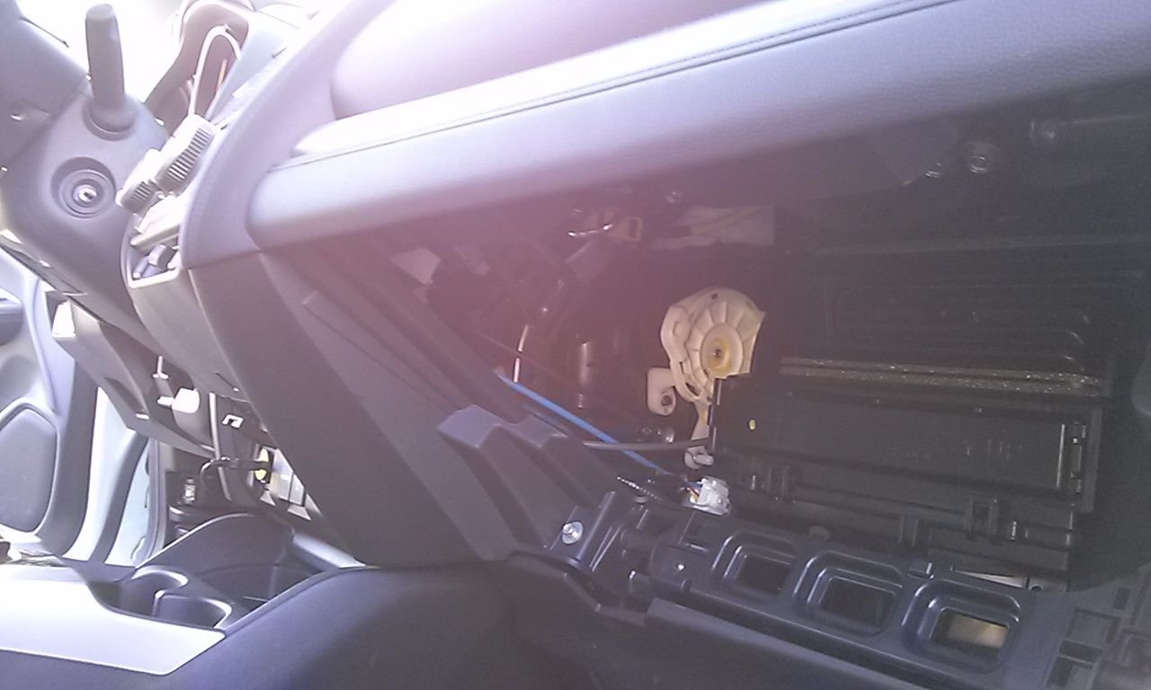

3. Behind the mode select knob there is an ordinary microswitch to turn on the A/C, you can hear it click when you when a defrost mode is selected.
4. Good luck pulling out the plug, I gave up and just cut the yellow wire.
5. Close up of the cut yellow wire.
Success !
Now I can run the defrost modes without A/C, and the A/C pushbutton still works to turn it on manually.
