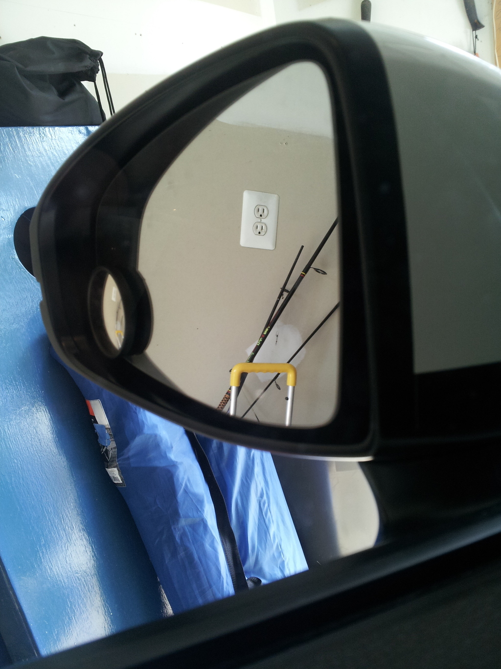

I am scheduled to get my driver's side window replaced under warranty. There is a deformity in the glass. It's a little bump out that's hard to see unless you're looking for it. At first I thought it was just dirty, but tried to clean it off. Also tried to scrape if off with a credit card. The dealership tried to scrape it off with a utility blade and said it bent the blade. I've tried to frame it in the Yellow/Silver box:

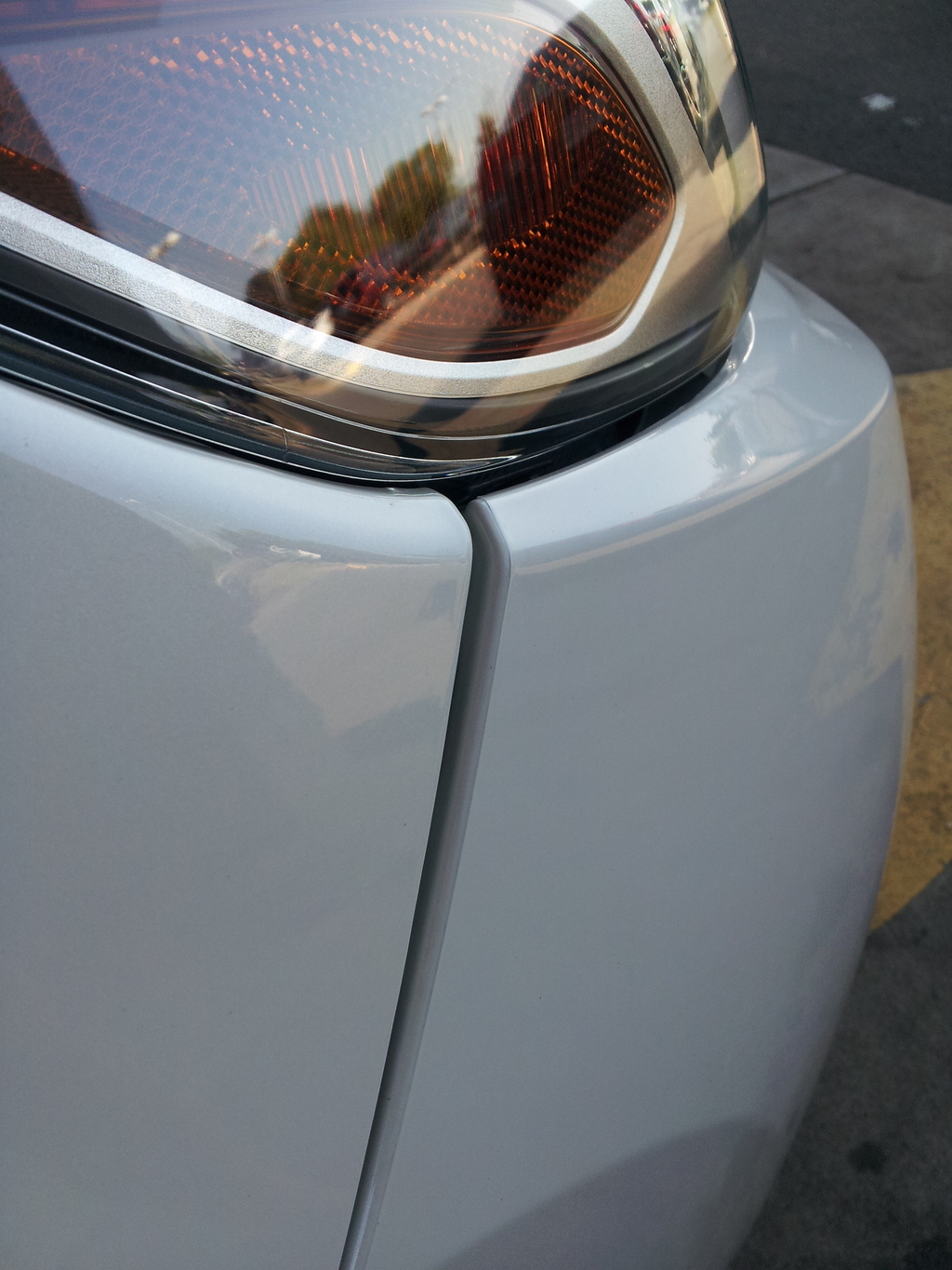

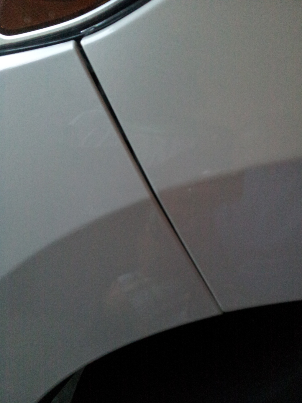

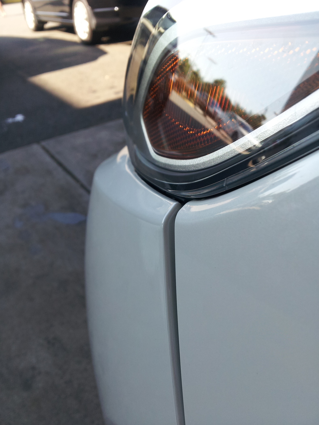

I've also tried to get them to look into the front bumper being misaligned, but they're pushing back on it. They say other vehicles are similar. I'm not happy with that answer and I'll have them look at it again when I'm getting the other warranty work. Seems quality control is not a priority these days at Honda...

At 9K miles, my front bumper has a larger gap at the top as well, maybe not as much, but it did grow a bit from new.

does the bumper physically move if you push up on it to try to close the gap?
if so i'd slip a few pieces of VHB mounting tape and close the gap.

Yes the bumper physically moves. No I will not be putting a band aid on this problem. Honda should fix it right, not have its end users Macgyver something. My concern is that it will just get worse and become a bigger problem over time.
I have to say that I am really displeased with Honda's level of customer support on the front bumper issue. I'll be calling to Honda USA's customer service line as I don't seem to be getting any help from their dealer. I hope this is not the new status quo as this is my first Honda, I've only ever owned Toyotas. This experience is underwhelming and I'll remember it when shopping to replace my 4Runner.

I don't have much confidence but at least I want a paper trail that I brought up the issue before my warranty expires. If for some reason a fix is found post warranty, I want to be able to say I brought this up prior and you couldn't fix it then, fix it now. Probably won't get far with that either but I'll do what I can.
I've already called them because my window rattled and they couldn't fix it. They told me they've had reports of complaints but no fix, sorry. So far after having the window replaced the rattling hasn't resurfaced, but we'll see...

Originally Posted by 2Rismo2
Apparently they've got a bunch of misaligned bumpers and have no action plan to fix it.

My front bumper has the same exact misalignment as in your photo. When I saw the Made in Mexico sticker on my car, I was pretty dissapointed. Did not even bother to go to the dealer on this issue. I just took video footage when I purchased the car brand new, that's all.

I have a (very) little theory that the bumper misalignment is the result of the bumper upgrade to meet the small offset frontal crash test score. I don't think mine had it before I took it in to be upgraded and I wonder if they had to stick something in there on all the cars at the 11th hour that makes the gap bigger at the top than bottom. Mine's solid and very small so it doesn't bother me.
That's funny you bring that up because I mentioned the same to the tech. I said there was a rush to fix that, they must not have buttoned it up correctly. As I understand it, cars built after July 2014 were supposed to be fixed. Mine was built 12/2014.

My salesmen called me to see how I was looking the fit. I told him about the bumper issue and he said bring it in. I met him at the dealership and they happened to have a red fit right in front. I showed him my front bumper and how I could lift it up and get things to fit flush. Then we walked to the one they had for sale and he could clearly see the difference. We showed the sales advisor and he showed another service advisor. They asked me if I had hit anything or any incidents that would have affected the front bumper and I said no, other than driving over 11k miles. They joked about the down force generated etc.
So I'm hanging out on my day off and going they can do something. If nothing, I'll complain to Honda na customer service again. Not that has accomplished anything in the past for me, but it's the most I can do.

Swing and another strike. So tech checked it out and everything appears to be correct and he can't see any damage or damages caused by an accident. There isn't any adjustment to be made they say. They even ran a car fax. Not surprised since I know there was no incident involved. They called the tech line and no answer so they will follow up and get back to me. I reiterated that this is not a one off issue and others are reporting it online.
So I'll call up Honda na customer service and open another case just to keep them on their toes.

I think that more than likely it is simply a matter of the clips not being attached. See
for how the clips look on the fender-side-panel. There is also a clip that attaches the bumper to brackets directly under each headlight, as well as the several clips that attach the bumper to the fender-side-panel. The bumper needs to be clipped to the clip on the headlight bracket, as well as to the clips on the fender-side-panel bracket. If the bumper is not securely clipped to the headlight, perhaps that is why there is a gap at the top where it clips to the fender-side-panel. It is very easy to miss the clip under each headlight. Who would think that the headlights might be used to help support the bumper cover!
