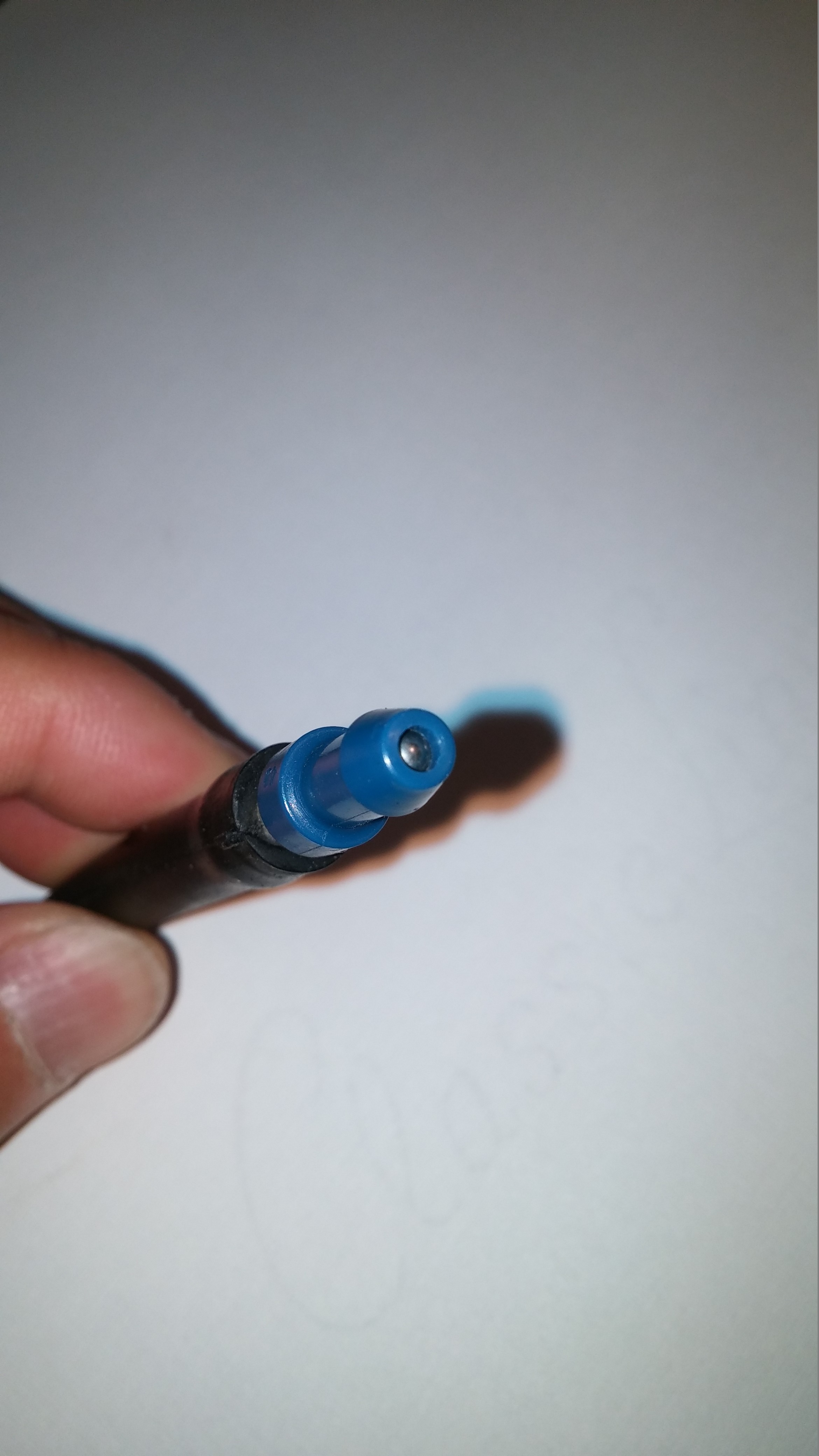

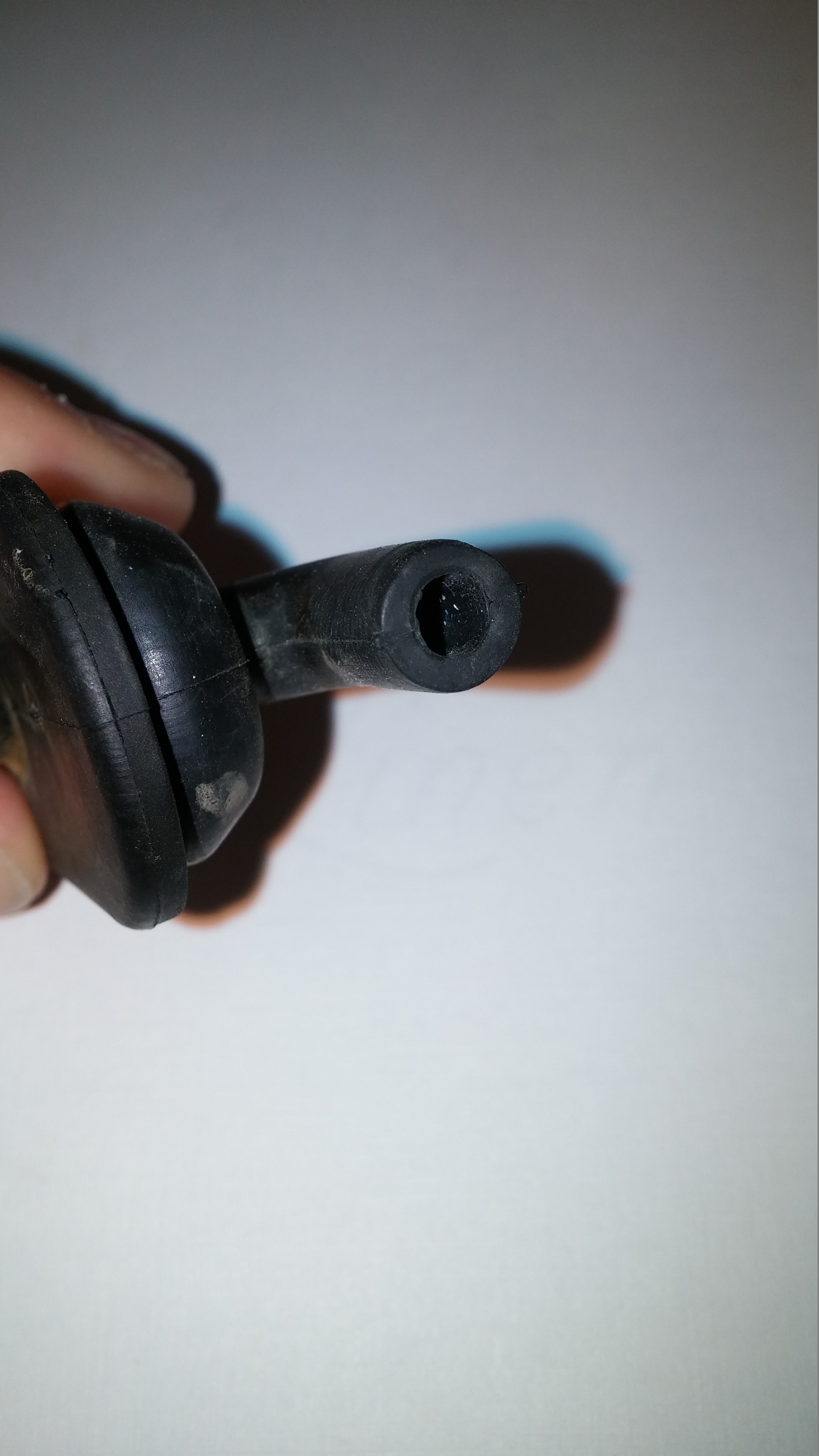

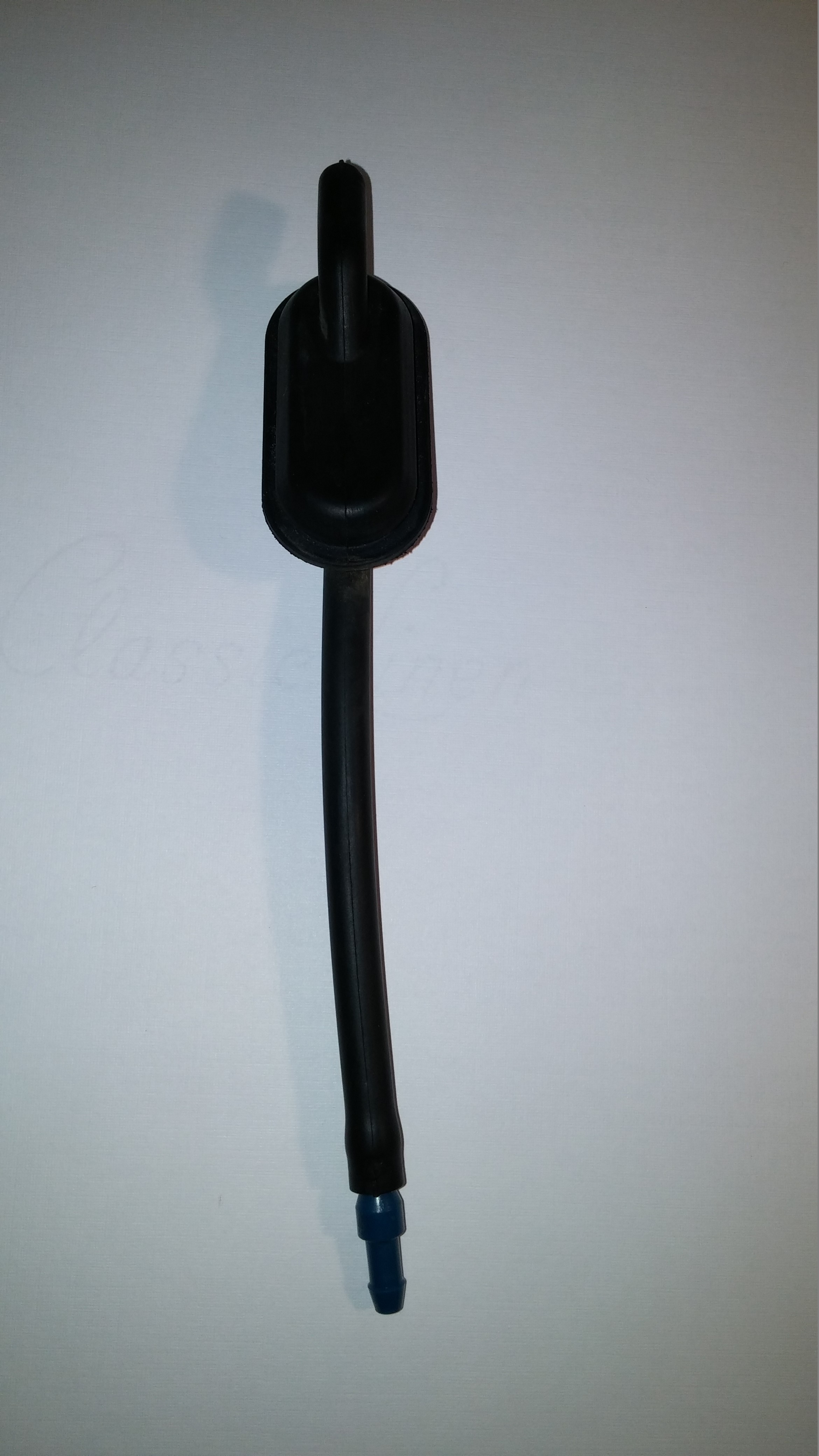

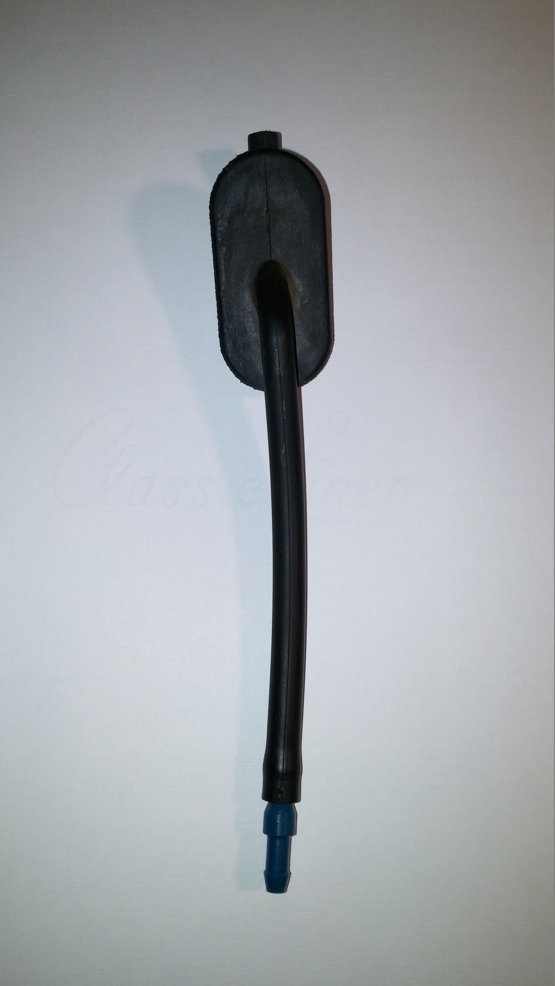

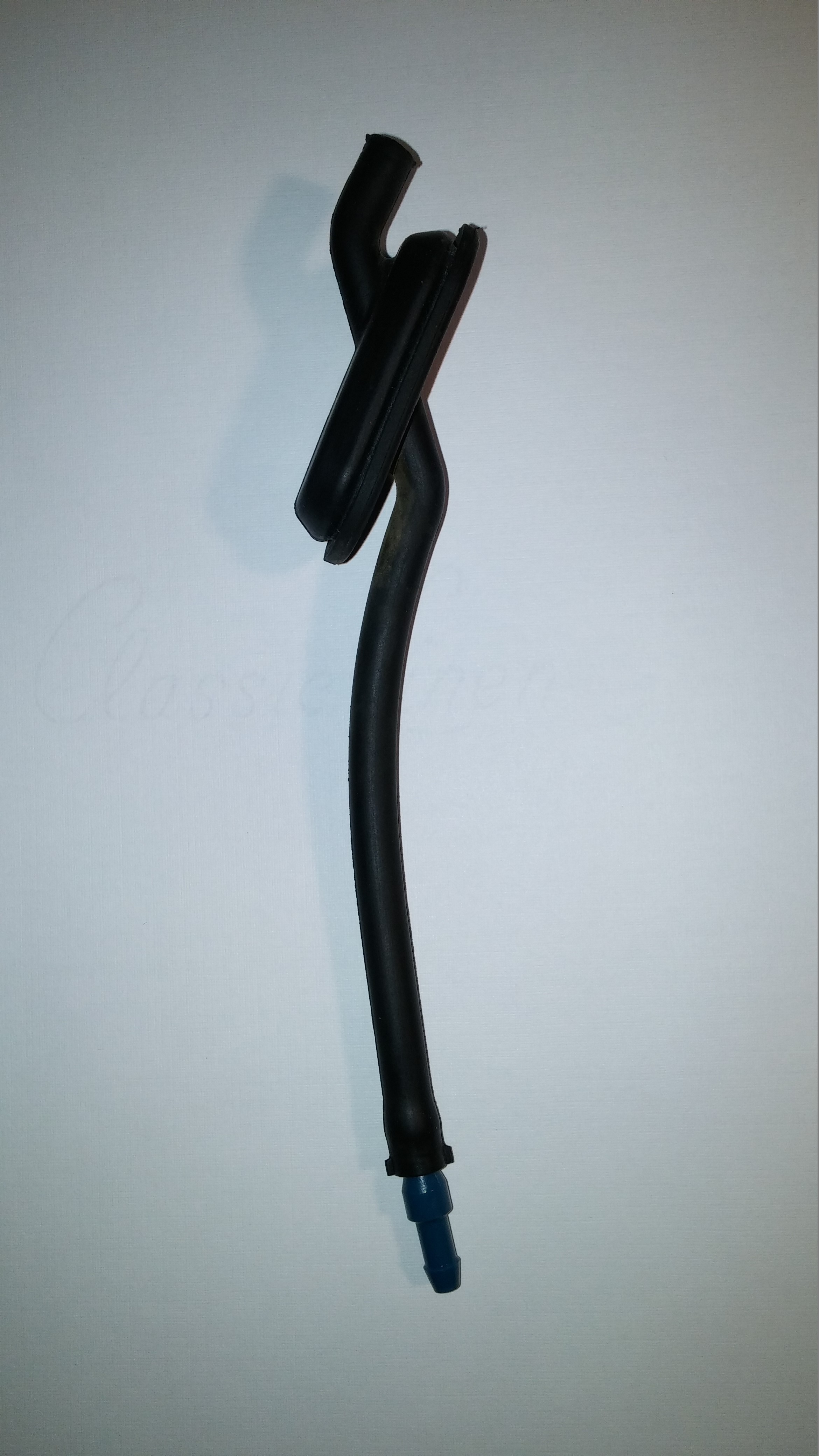

Found this just sitting in the back trunk area after a rear end damage was repaired. Any idea what this is? It probably belongs in the back area somewhere. It is 7 inches long.

I think it is the feed tube for the rear hatch window washer.

I just looked at my Fit. That tube is what conducts washer fluid from a line under the headliner to the hatch. The oval part snaps into an oval hole at the top of the hatch. It's ABOVE the rear window, not under the inside panel.
Doesn't look like whoever "fixed" your car did a very thorough job.

You think I can snap this in without taking anything apart?

It depends on where the connectors are located inside the roof and the hatch, and if you can fish them out to connect them.
