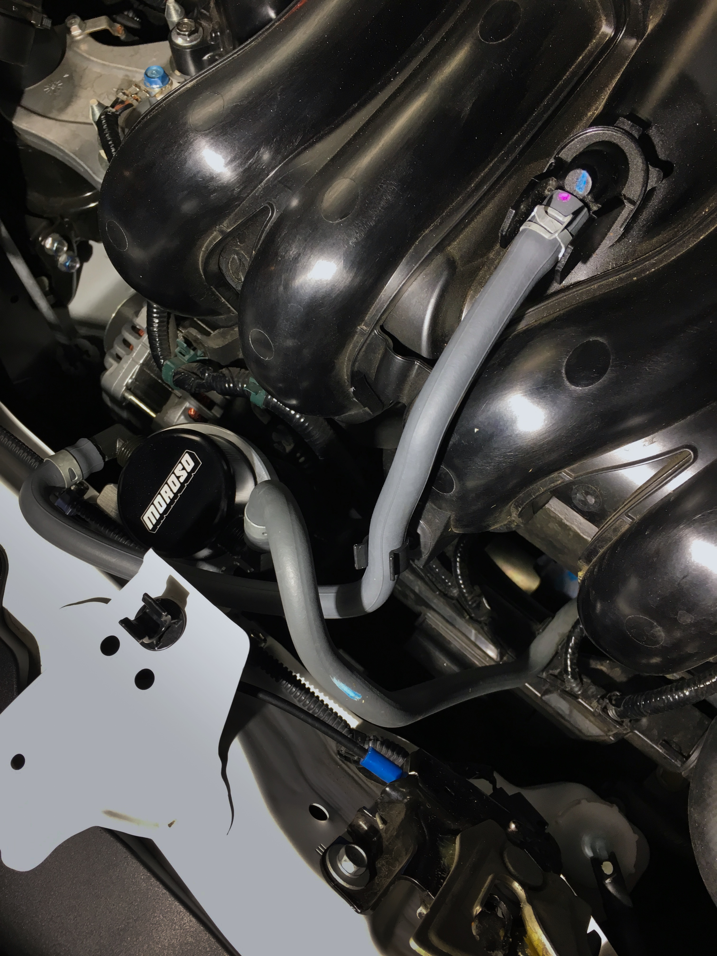

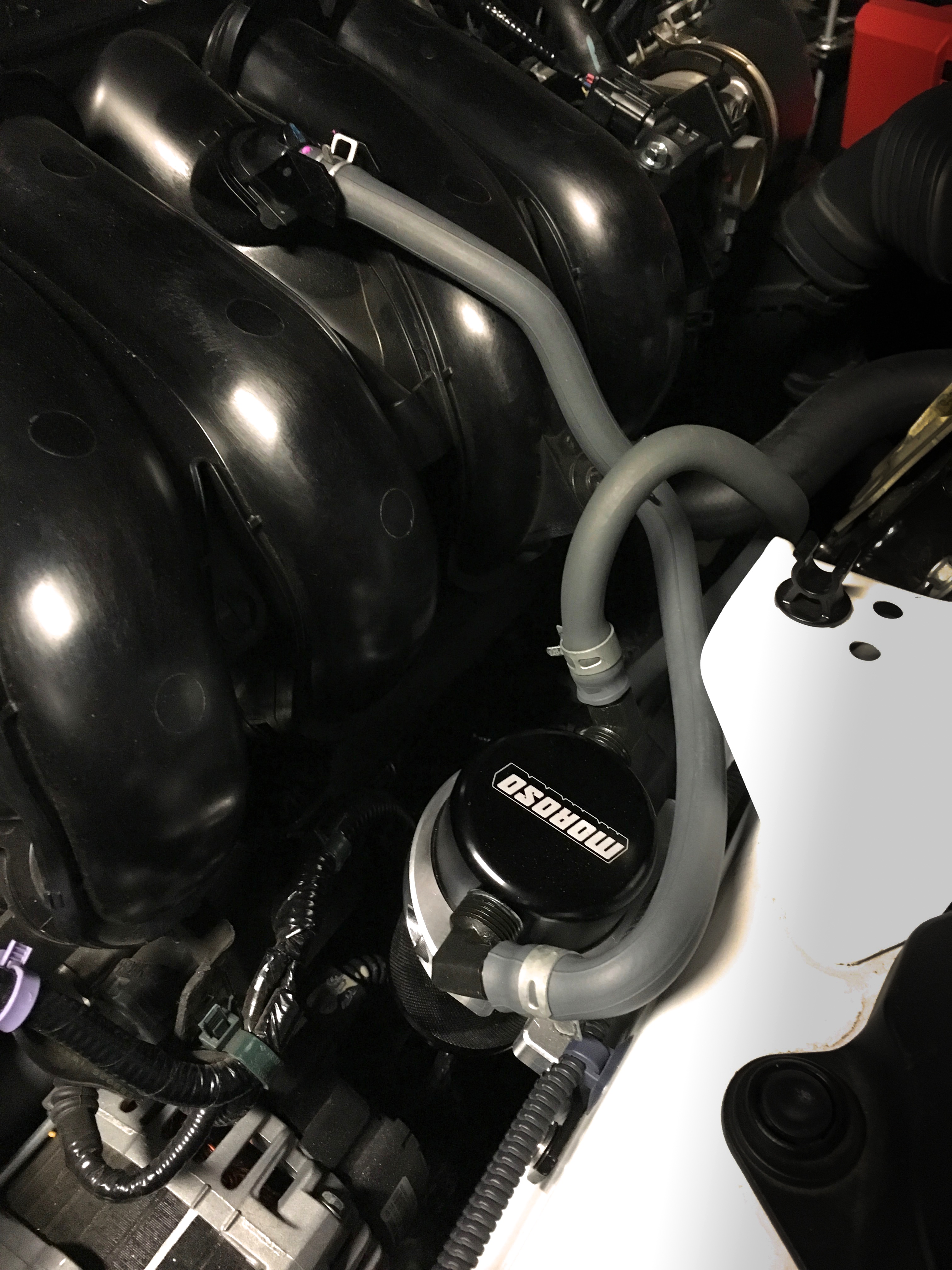

I installed a Moroso oil separator on my 2016 EX 6MT using two hex head stainless cap screws, nylon hex lock nuts and flat washers.
There was half a teaspoon of oil in the separator at 150 miles. It works as expected!
The larger Moroso oil separator on my 2007 Tacoma 2.7L 4x4 captured two and a half teaspoons of oil at 700 miles.
Parts List:
Moroso universal small oil separator anodized black: 85497
Moroso 3/8” to 3/8” 90 degree fitting (2): 65382
(the 85497 is supplied with 1/2" fittings. If you want
to use the smaller Honda PCV hose order 65382)
Honda PCV hose: 17131-5R1-000
Honda PCV hose clamps (2): 95002-41250-04
Attached Thumbnails Oil Separator Install 2016 EX 6MT-os1.jpg   Oil Separator Install 2016 EX 6MT-os2.jpg

Fairly simple with the right tools. Drilling the two mounting holes for the separator mounting bracket was the most difficult. With minimal clearance for drilling from the intake manifold side of the engine, I used a right angle chuck adapter (DWARA100) on my Dewalt cordless drill. You can find them at Lowe's and Home Depot for a reasonable price and it should fit any cordless drill hex drive.
I used a small diameter short drill bit that fits the hex drive to make a starter hole. That hole was then enlarged with a Dremmel motor tool with a right angle chuck adapter and grinding bit. The 5mm diameter threads of the hex head stainless cap screws then fit the hole. I touched up the area of exposed metal with Honda touch-up paint. You could do all of the drilling/grinding with either a cordless drill or Dremmel as described. You can find a small hex drive grinding bit to fit your cordless drill or small drill bit for the Dremmel.
