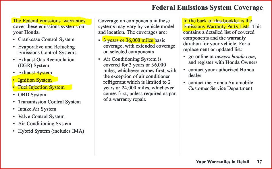

Looks like coils / injectors are NOT covered by powertrain...
Page 17 http://owners.honda.com/Documentum/W...s/AWL50465.pdf.

I see that....
Covered under FEDERAL warranty. (How does that work with Canadians???)
California might be more coverage.
