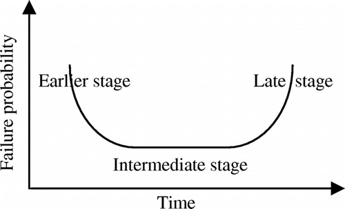

It's not about the miles, but how many cycles of starting the car it went through. Parts are designed to go through a minimum of life cycles before replacement. If defective they will fail at an early stage. If cycled many times and reached the end of it's life cycle it will fail. This bathtub curve will explain it.
Only you know how many times your car has been started during those miles?
A good argument for stress-testing the heck out of anything you buy before the new-product warranty expires, though I don't think anyone would foresee something like this.

Whoever manufactured it for Honda or Honda tested it to see how many times the average starter would cycle. I'm sure they have data that cars get started X amount of times every 1000 miles driven on average? They then decided if that was acceptable longevity before using it in production.
The point I was trying to make is that if the OP works 1 mile from his house then his car is probably started more per miles driven then the average. Likewise, if a car is used as a cab, Uber or some other transportation the car might get started less per mile than the average. Again it's how many time "He" starts his car per miles driven, not that it failed at 38K miles. Take for example tires. City cars turn and stop per miles driven more than a car that has long highway commutes. Tires generally wear out faster on cars that are city driven. It's just the way it works
