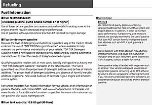

Yes, I agree. The owners manual says top-tier and I will use top-tier. There was on another forum (CR-V) where an individual had issues with his engine, and the first thing the dealership did what determine if the owner was using gas that was top-tier or not, telling me that if they discovered it was not top-tier, they would have refussed warranty work.

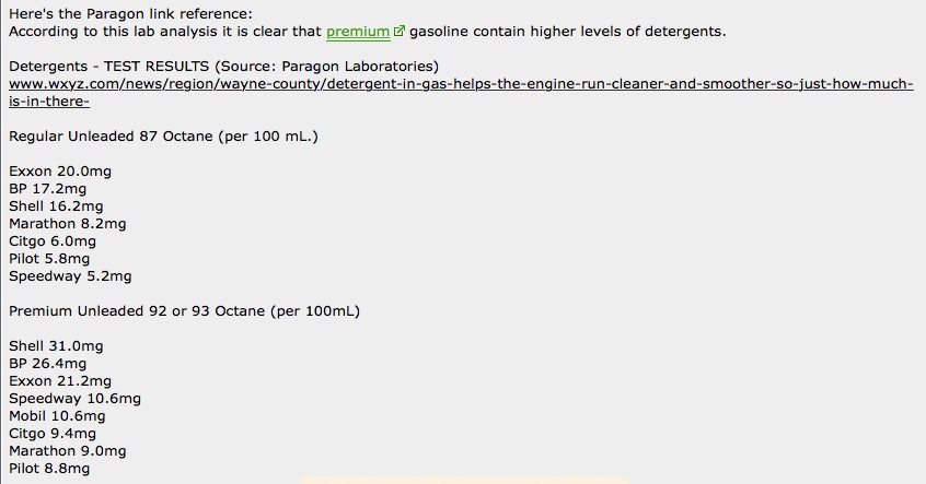

My understanding is that top tier requires a higher level of detergents but I haven't been able to find any info on exactly what the level must be to qualify. I did find this chart that analyzed a few brands - some top tier and some not. It's a very limited list, though, and it's based on a single analysis, so I wonder how consistent the levels are from station to station over time.
Compounding my confusion is the fact that the Fit, like many new cars, uses Direct Injection, which means the fuel is injected directly into the cylinder so it doesn't flow past the intake valve. There has been lots of documentation that confirms that this results in a higher amount of carbon build up on the back side of the valve than previous, non-DI, designs. On older style engines, which have fuel flowing past the valve and then into the cylinder, detergents and ethanol helped to keep that area clean(er).
The higher levels of detergent and the ethanol might still help keep the injectors cleaner and it may help keep the combustion chamber cleaner but the issue with the valves remains. Maybe it's more of a theoretical issue than a real problem. I haven't seen any complaints from owners who had to pull the head and clean or replace valves.
I've run mostly non-top tier gas in my older Civic, which does not have DI. I've seen some posts that say that you don't really need to run top tier all the time. You can just run a few tanks of top tier, or use the injector cleaner, and it will clean things up. Then you can go back to running non-top tier.
Any comments on that?

I don't think the issue is with the injectors, but deposit buildup on valves and the combustion chamber.
FWIW I used to think like you. Drove a SRT-4 219K miles running cheap generic 87 octane from the local chain in a car that required 91 octane. No issues. Had a VW CC and ran the same gas in the car and after awhile it threw codes and generally was starting to run poorly. Had to spend like $1K for the dealer to soda blast the combustion chamber, ports and valves because of deposit buildup. Dealer told me to stop being a penny wise/dollar dumb and stop using the cheap gas. Neither car required injector cleaning.
This is one of the reasons why, if I buy a new Civic in the next year or so, I'll probably go with the 2.0 NA engine since it has the older multi-port fuel injection, not the DI.
