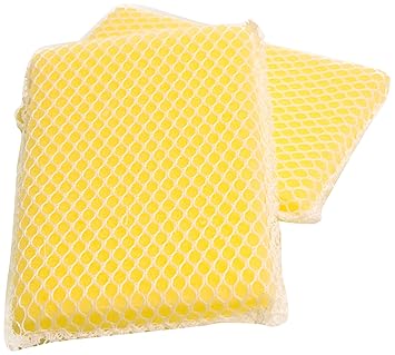

I wipe the blades lightly with the same netting-covered sponge that I clean the window glass with. The netting removes grit from the glass and the wiper blade.
