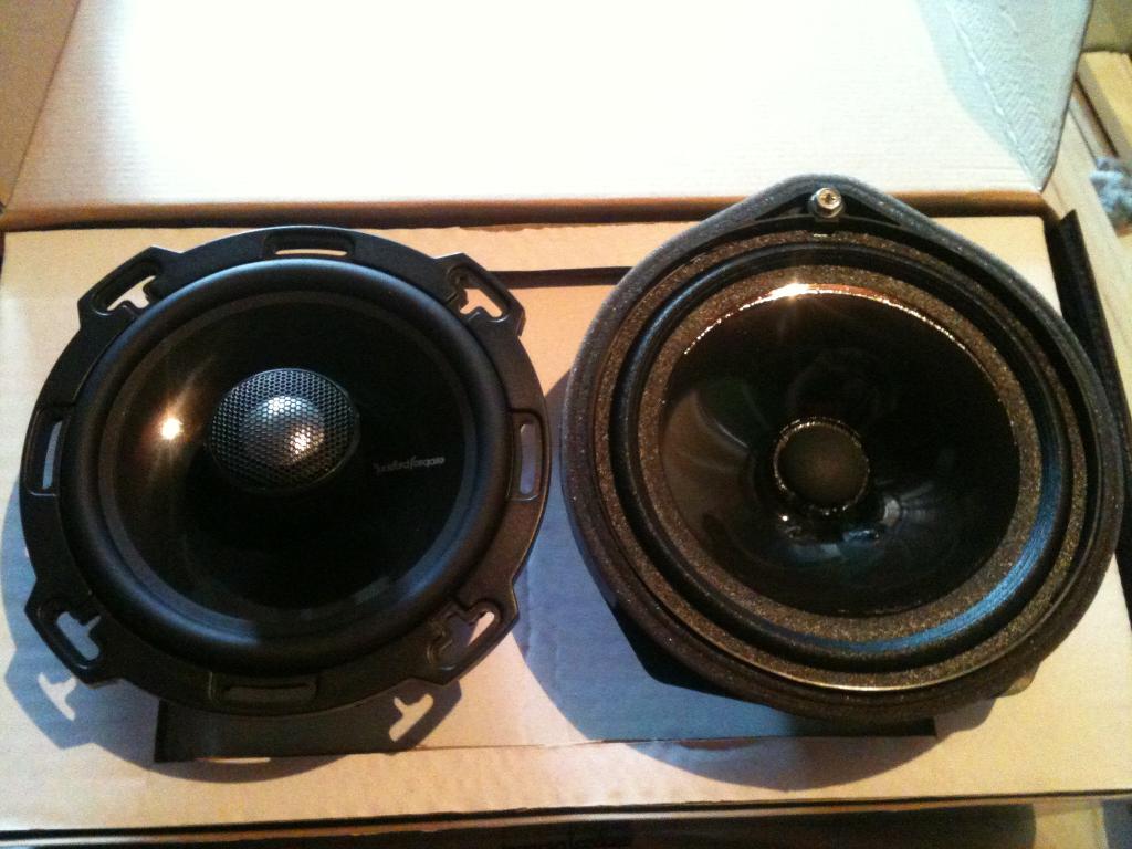

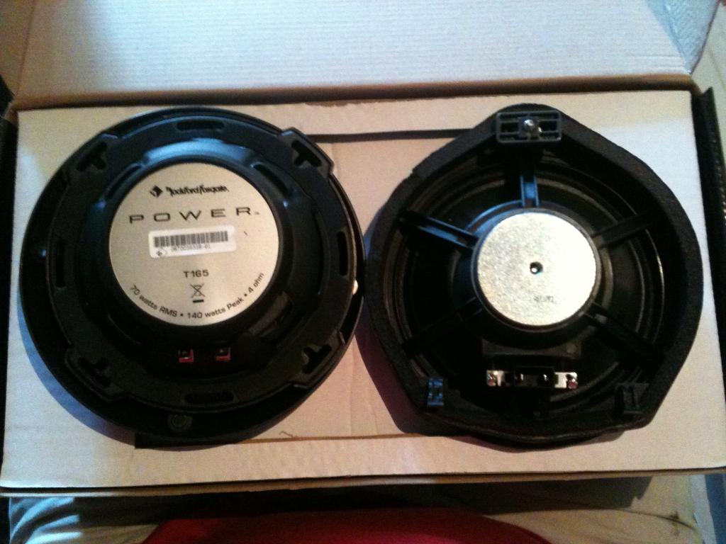

I have upgraded my speakers to Rockford Fosgate Power 6.5's all round run by the stock head unit and the difference is amazing, cost me $250 and everything i needed was in the box. I have a sub to install but haven't been as motivated since doing the speakers. There are pics in the what mods thread.

Cool pics of the replacement speakers. Does it fit with stock grille or you have to use the one that came with the kit?
I prefer to keep everything looking stock.

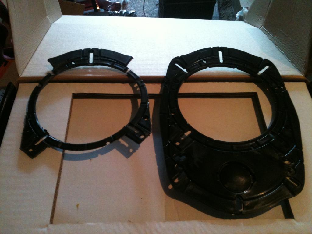

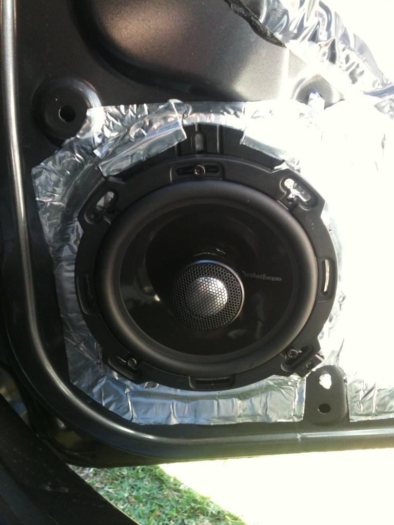

No visible signs of the upgrade. Everything fits under the stock door cards and nothing fowls the windows. I used the adapters that came with the speakers to secure them, they are made to be trimmed down to fit per the pic below

I added sound deadening to the doors and used a little to keep the adapters in place during installation.Name:  78D36E22-559D-44AE-B1A7-983F9F5CF9CB.jpg

what are the stock speakers rated at, and what ohm?
Are you sure you are getting enough power from the stock head unit amp to run those speakers? Most stock systems won't put out 70w RMS. Does it throw off the balance with the stock tweeters?

I have no idea about the stock speaker ratings but I could hear them struggle to cope with highs and lows played at the same time.
I am sure they will be louder with an amp but the stock head unit does a good job of driving them. Mid-high teens is comfortable at low speeds, 25-35 is loud and it will drive clear sound to the max of 40. My VTi does not have the tweeters which is why I opted for two way Power 6.5's instead of the Punch 6.5 splits for similar $.

From the pics it looks 4 ohms.
