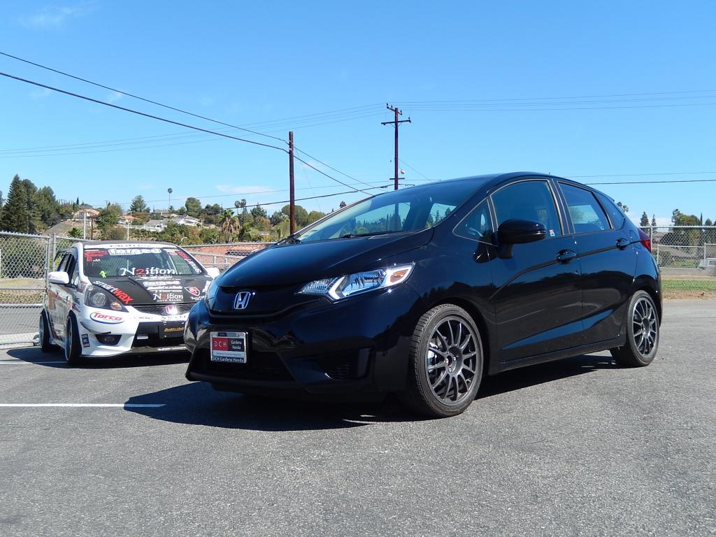

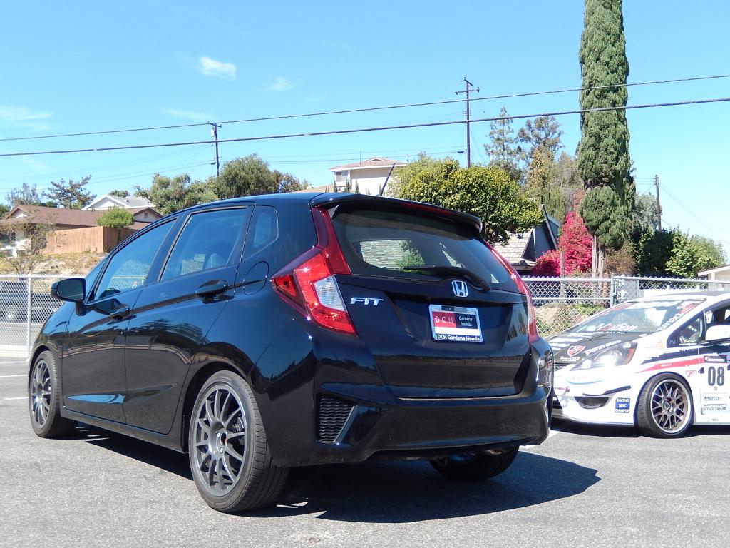

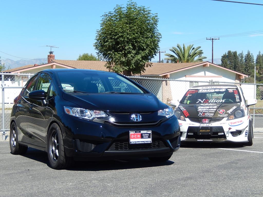

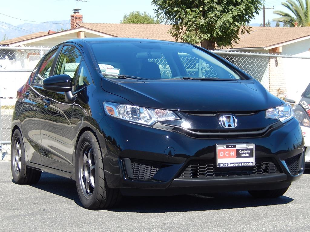

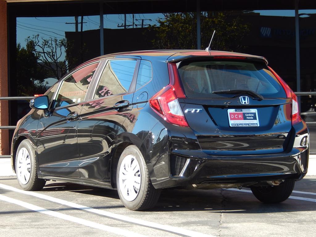

PICTURES:
The driver's side on the first few photos shows a Dynamics Racing 17" wheel, unknown width and offset, but I would assume it is roughly 7" wide with an offset around 40-50 and 205/40R17 tires.
The passenger side in the first few photos show Buddy Club P1 Racing wheels. They are 16x7 with an offset of 40 or 42, 225/50R16 tires are mounted on them. Obviously 225 width tires are MASSIVE, the rear fenders ate up the rubber just fine, but the front is shamelessly protruding. You would definitely need to dial in some front camber and/or roll and pull the fenders if you are looking for low offset or wide tires. But I was able to do full lock turns no problem, I did NOT go over speed bumps or drive over 25mph for obvious reasons, I didn't want to destroy the brand new fenders. We simply wanted to see how it would look and determine what the car could handle.
Although the car is now back on stock hub caps and tires, the car with aftermarket low profile tires felt MUCH more responsive during cornering. I would highly recommend lower profile tires for people desiring more crisp handling response. And without further delay, PICTURES ARE HERE!

Old Oct 6, 2014 | 06:28 AM
rodney's Avatar
Posts: 450
From: new friggin york
you did this just for test fitment, right? because your rear tire is on backwords...
it does look pretty cool though
Old Oct 6, 2014 | 12:01 PM
accordguyintake's Avatar
Joined: Mar 2006
Posts: 3,279
From: Garden Grove, CA
Yes, we drove the car for less than a mile. I was more worried about having 16s on one side and 17s on the other, as it might throw off the stability control haha
