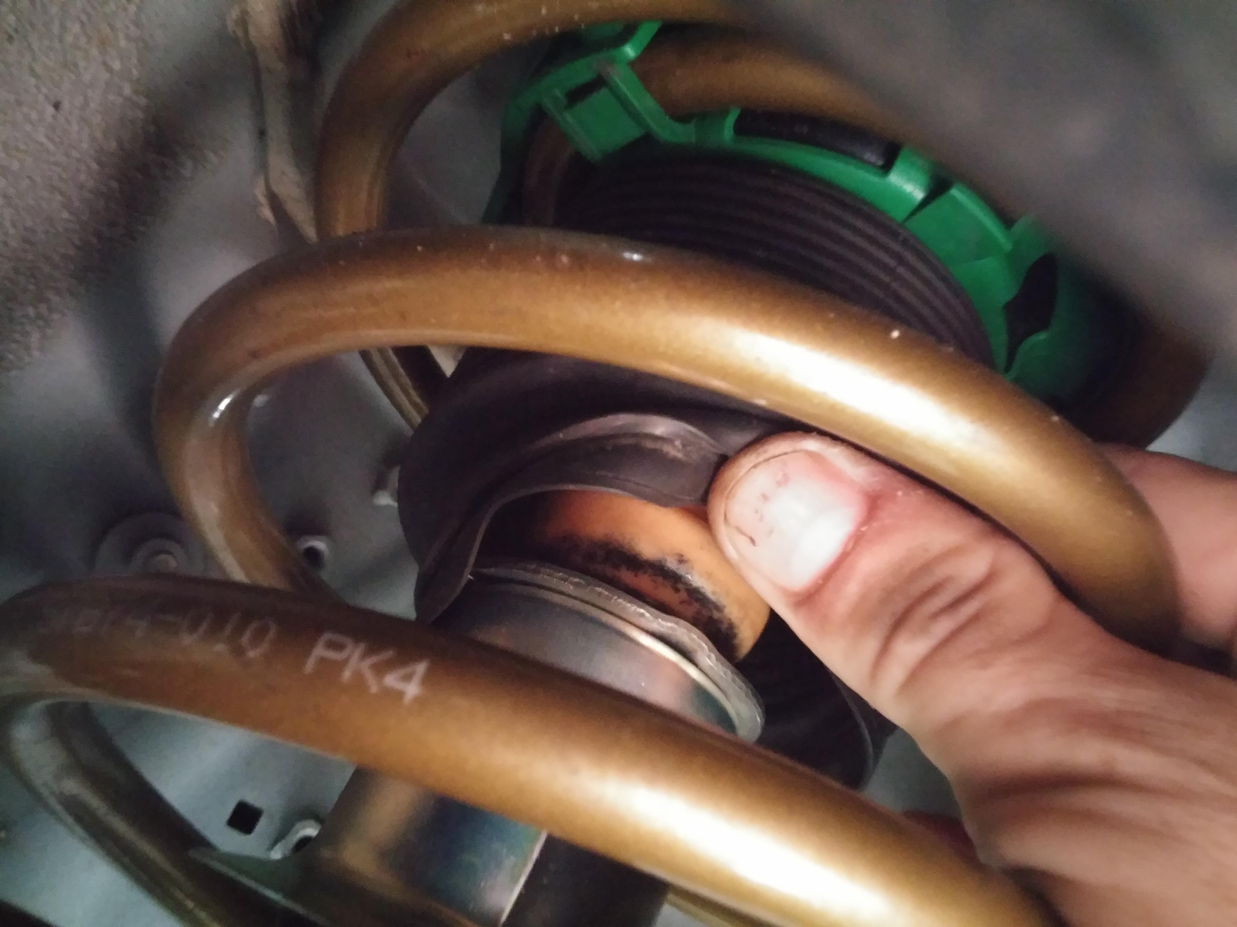

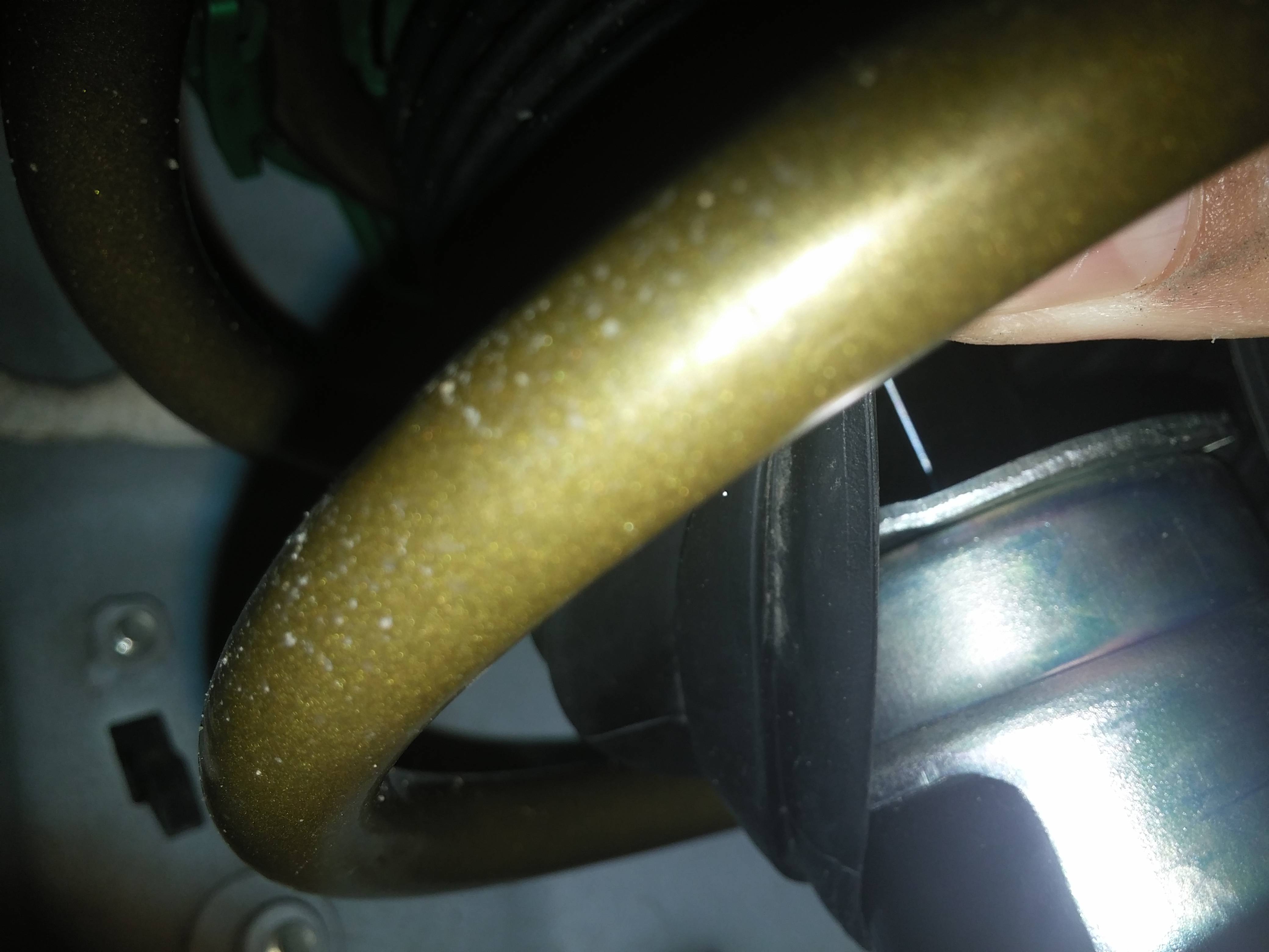

I'm aware, saw the pics. But they aren't engaged on OE, if they would be, your drop wouldn't be there, your ride height would be maintained like OE then.
Less than one inch drop front before cutting (steering turned to lift off the bump):
Size:  924.7 KBOne inch drop front after cutting 15 mm doughnut:
