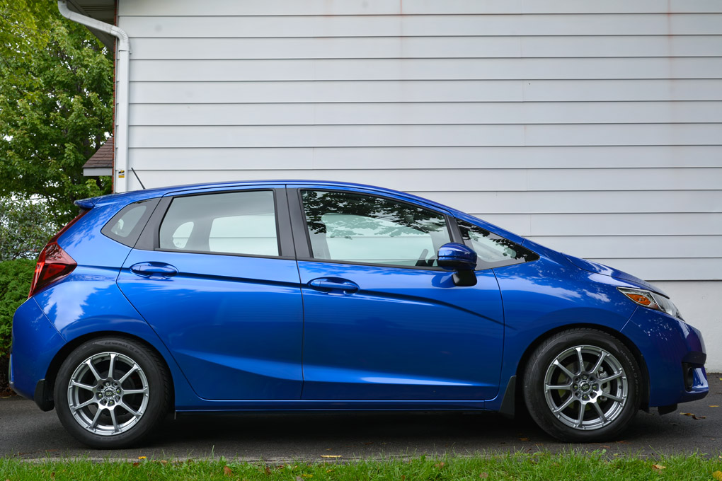

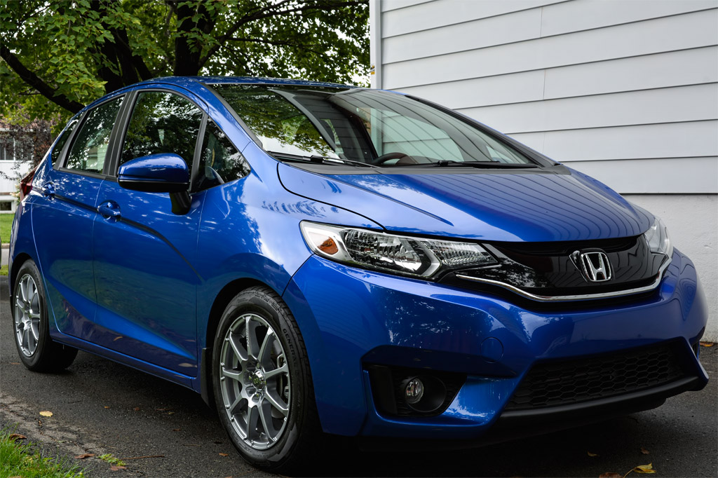

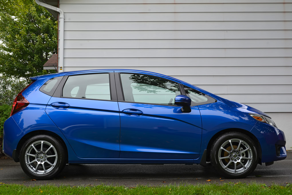

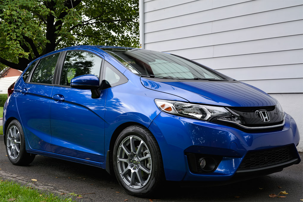

installed (comparison pic between stock and swift)
I got the Swift springs installed on my gk5. An alignment was done as well but no camber adjustment. I haven't driven a lot with them yet as they are just done but I've noticed a few things already: under hard acceleration the front end would go up somewhat with every gear change and that has diminished substantially. Body roll is more controlled. This change is very noticeable too. I was expecting a harsher ride than stock but so far, I have hardly noticed any difference at all in overall comfort level. No rubbing with my aftermarket wheels and tires that I noticed.
It's too early to do a full review on the springs at this time. The preceding paragraph is an early impression only.
I am posting a few pics. Swift says a 1 inch drop on all corners and that seems to be what I am seeing live and in this direct comparison picture. If you can view both pictures alternatively you will clearly notice the lowered stance. I have not posted pictures from the back but there is a more noticeable negative camber on the rear end wheels. I expected this. I don't think it's any cause for concern at this time but I expect the tires to wear out a little faster. The camber is far from being dramatic. It's just there and it can be seen.
So that's it for now. I hope to do more stuff on my Fit but maybe not this year. I feel choices for aftermarket parts are rather limited at this time.

Old Aug 11, 2015 | 08:47 PM
GolNat's Avatar
Joined: Jun 2015
Posts: 1,383
From: Delaware
Looks good. What's the spring rates?

Old Aug 12, 2015 | 01:08 PM
marcn24's Avatar
Joined: Jul 2015
Posts: 18
From: littleton, co
What size wheels and tires? Looks really good.
Old Aug 12, 2015 | 02:59 PM
jhn's Avatar
jhn
Joined: Dec 2014
Posts: 605
From: CD
- camber really won't change with lowering a torsion beam. It's probably in the -1.6 range ( alignment sheet will state it) and that's about what it was stock.
Car looks good. That's a good amount while still maintaining practicality of the car.
Old Aug 12, 2015 | 08:04 PM
mikeDF's Avatar
Joined: Mar 2015
Posts: 143
From: canada
Thanks jhn. I was only going by what I was seeing from the back. It seems like there is more negative camber than before the springs. Maybe I'm dreaming. I know there is some negative camber that is easily seen but I guess it's like that stock.
I essentially wanted a slight change in the behavior of the stock suspension which was too soft, too wobbly for me and I also wanted a lowered stance that was not extreme. What I didn't want was rubbing or scraping of any kind. For now I can say mission accomplished.
Old Aug 12, 2015 | 08:12 PM
mikeDF's Avatar
Joined: Mar 2015
Posts: 143
From: canada
Thanks marcn24. The wheels are 16 X 7 with an offset of 45. They were available with an offset of 35 as well but I wanted to avoid rubbing like the plague so I played it safe. The tires are 195/55 R16. They replace the stock steel wheels and 185/60 R15 tires I had before.
