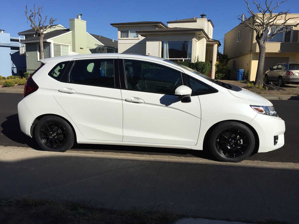

I installed Swift springs and koni orange shocks.
1) First time doing it myself, though I do my own maintenance like oil/MT fluid changes, brakes, etc.
2) Took me about 4 hrs, most of it was spent on the front cause I was being cautious to not pop the axle out and messing with the sway bar end links.
Don't have a before, but got an after. I'm standing so the picture was taken at a slight angle.
