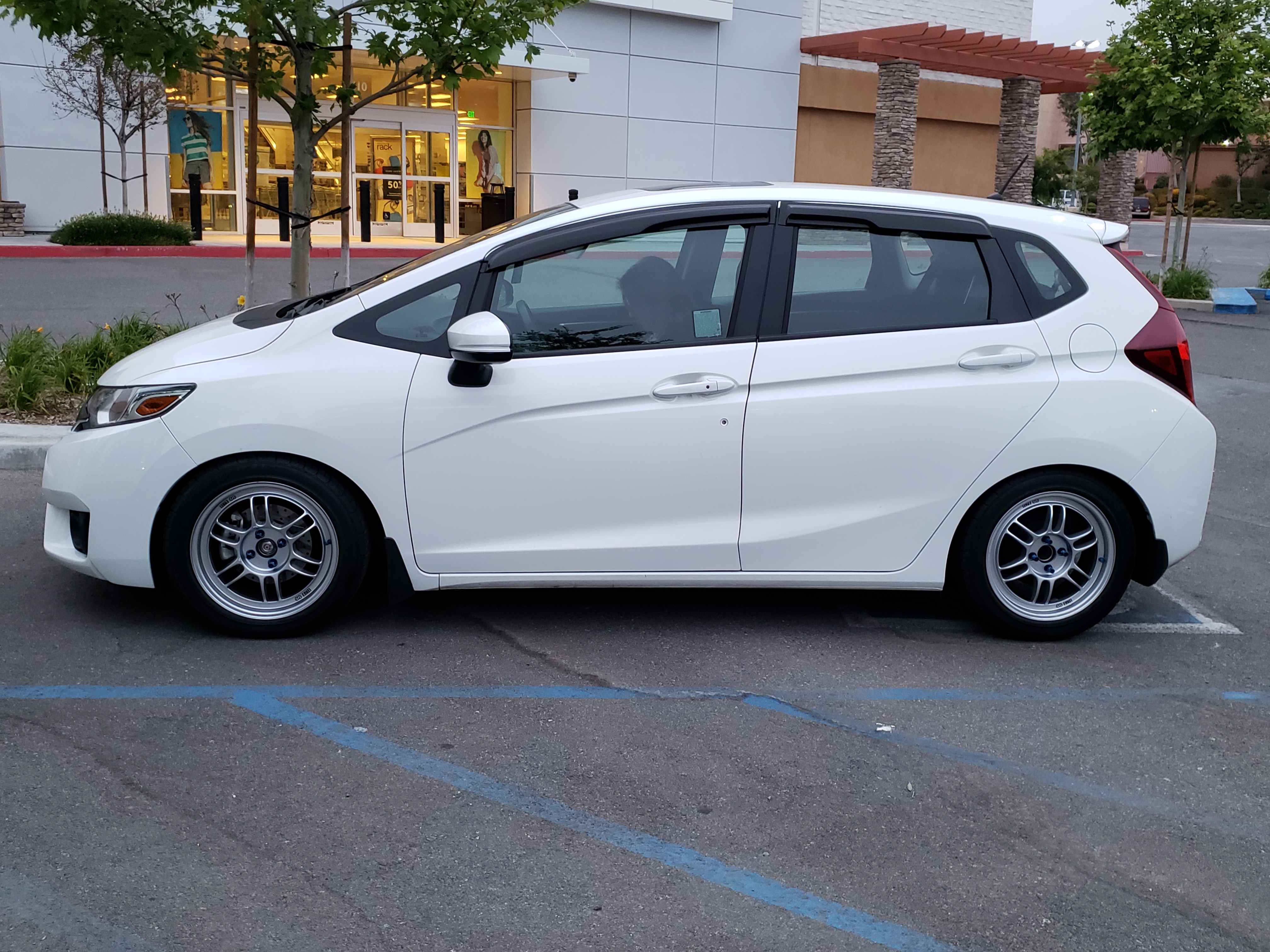

Right now I have Eiback Pro Kit and stock struts and shocks
This is before I installed the Eibach

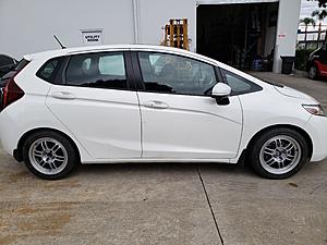

This after I installed the eibachs. Oh and this is before I put 5mm spacers on the rear wheels.
Wheel Spec 16x7 +43
Tire Specs 205/50R16
About 1 finger gap
Had to roll front fenders and cut the lining in the back cause initially it was rubbing alot on dips etc.

in for updates. I know its subjective to ask, but ... how do those eibach and truharts ride?
