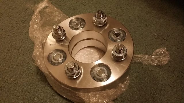

So i got my wheel spacer mailed to me for the backs last night.
Looks sharp. I got them from Amazon 4 x 100 1'' wheel spacer
Amazon.com: (2) 25mm (1") 4x100 Wheel Spacers for Honda Civic Acura Integra Mazda Protégé Miata Toyota MR2: Automotive Amazon.com: (2) 25mm (1") 4x100 Wheel Spacers for Honda Civic Acura Integra Mazda Protégé Miata Toyota MR2: Automotive
They fit just right. The bore size is a "little" bit large but spacer fits just right when screwed on.

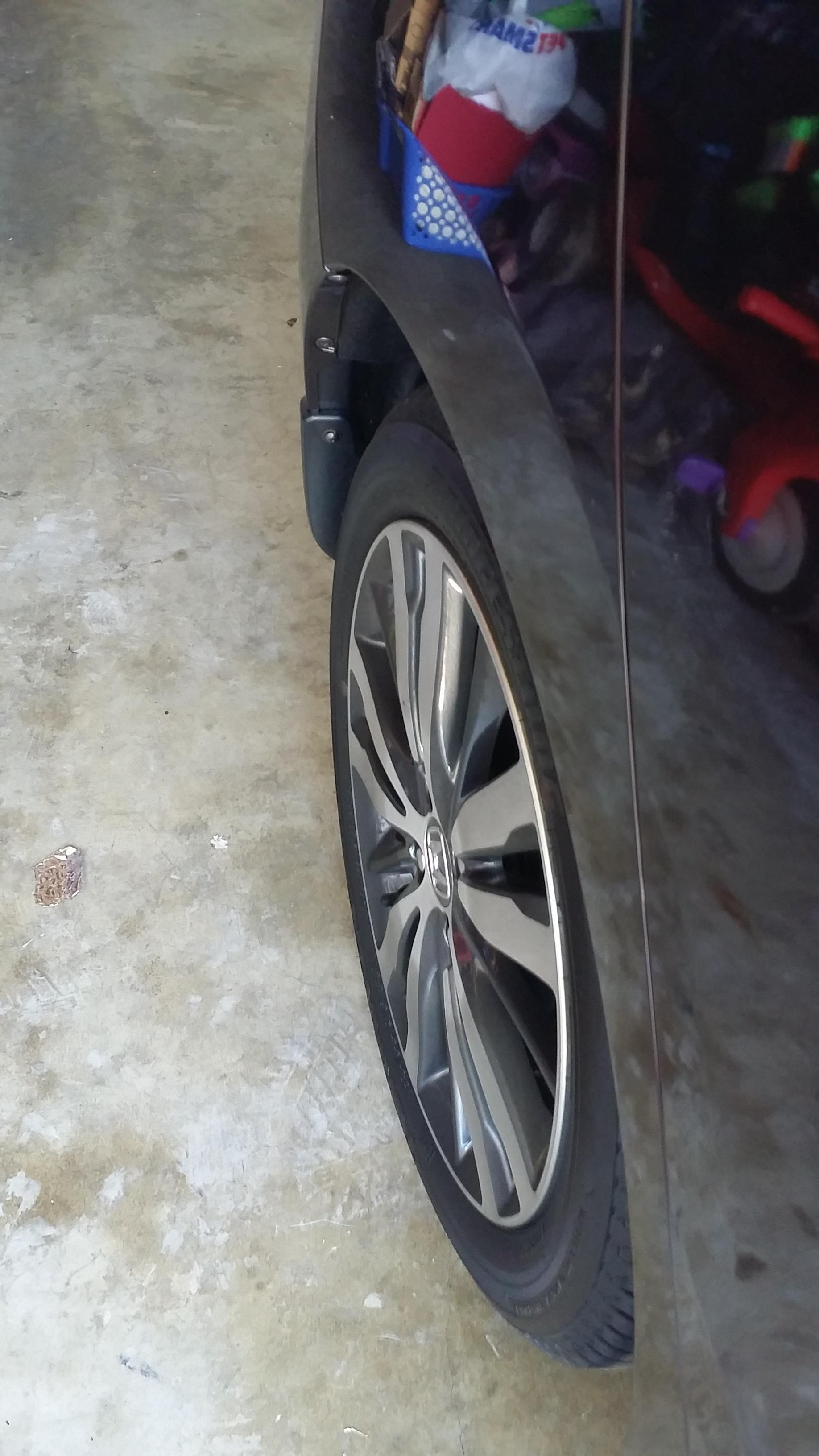

Before wheel spacer

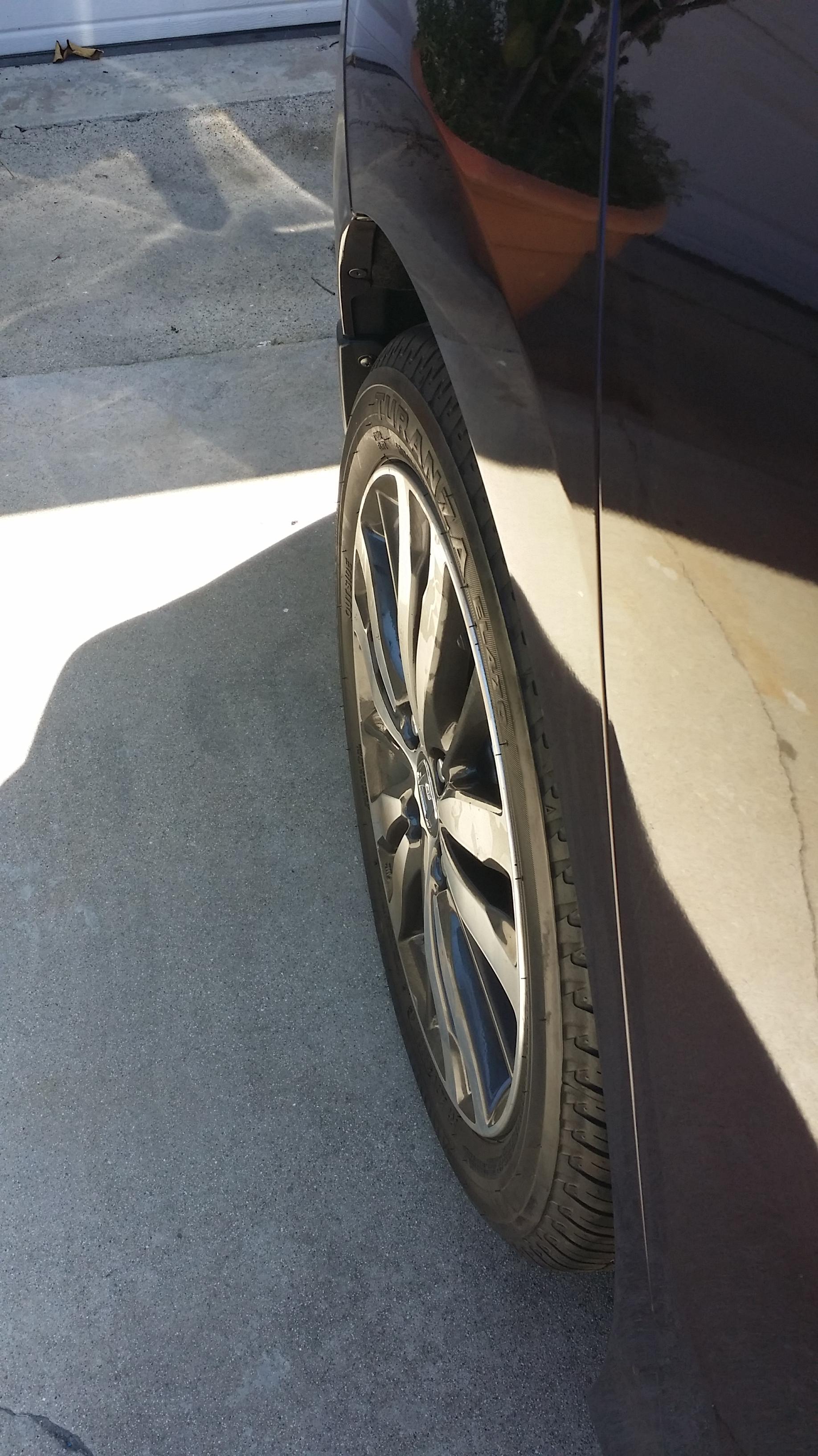

And after
it appears to stick out past the splash guards, but it is quite flush to the side of the body, fender, and rear passenger door. Now I'm curious if the splash guards will do their thing since the tires stick out past their sides a bit.

When you say the bore is a little bit large, how much larger? Do you know the exact measurement of the car hub? You are not planning on using a hubcentric spacer ring?

I believe the stock hub bore is the same as others have mentioned, 56.1. I was thinking of getting hubcentric rings but when I tightened the nuts of the spacers, they pretty much centered everything together. When I say the bore of the spacer is a little bit larger, I mean I can't even stick my fifth finger in between the spacer and the stock bore. So maybe 1/10th an inch?

As for the 25mm spacer. I had measured the front wheels and the rear wheels from sidewall to fender, and I came to the conclusion that 25mm is adequate.
Rear wheels is about 1-1.25 inch from fender
Front wheels is about 0.25 inch from fender.
So I got the 25 mm (1 inch) wheel spacer for the rear wheels. They look better now, but not exactly flush to the point where they look a bit "off" compared to the front wheels.
