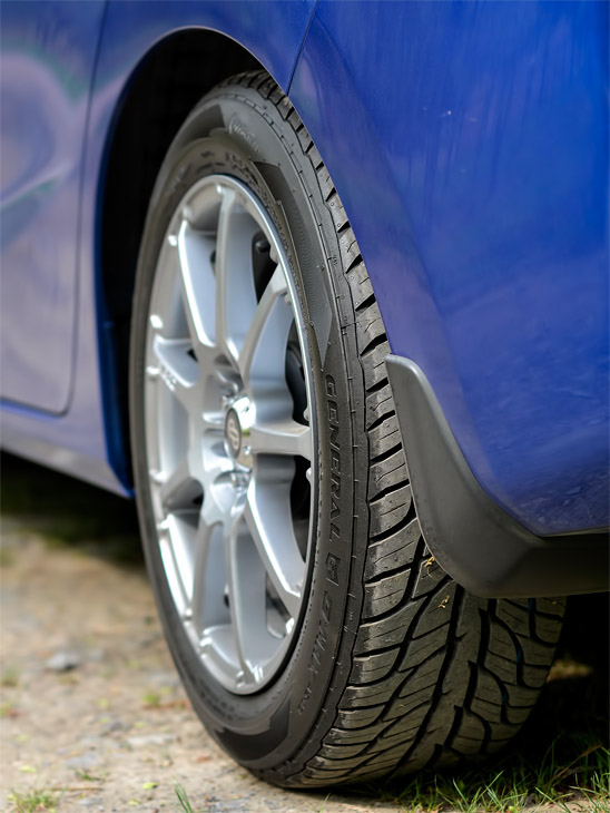

I got these last week after about a month of looking for what would fit without rubbing, look good and not affect ride comfort too much. Anything too get rid of the steel wheels and ugly caps of the LX version !
I debated between these and the 2 Crave machined Mach 5's which are about the same price. I finally went with a company I know better and that is sold by Honda dealer's themselves although I'll admit the Mach 5's look better.
I essentially wanted a wheel of 16 X 7 with an offset of at least 45. It's possible I will lower the car so I figured the closer I am to the stock offset, the better the chances of avoiding rubbing when I lower it. Cost was important too. I dismissed any ultra light wheel for that reason alone. Most of these cost more than $200 each. The Enkei's are about average when it comes to weight at 18.5 lbs. I like the fact that Enkei says the wheels are silver but they are darker than what other manufacturers call silver. They are somewhere between silver and gunmetal.
I put General G-Max AS-03 (195/55R16) on them for a variety of reasons. I wanted a 3 season tire to be able to extend the time I have them on at the limit of the start of the winter season. A summer tire would have to go off earlier because they suck in snow and we get tons and tons of it here. The best 3 season tire according to tirerack is the Michelin Pilot Sport but it was pricey, ugly and heavy so I opted for a tire with a nice tread, good reviews overall and possibly the lightest in that size at 17.1 lbs each. It's supposed to be decent in light snow as well. The price is also very decent.
So far so good. No rubbing as expected even on mean speed bumps. The comfort level is about the same as the original Firestone F740 15 inch tires. Road noise is a little more pronounced but it doesn't bother me. Road feel and cornering is definitely better. I was expecting the tires to give a stiffer feel but they don't. The compound is softer than expected. They are inflated to 35 pounds now.
Here are a few photos. The second one is just to show the tire tread pattern. The gap between the rubber and wheel fender is too big for my liking but that can be fixed later. The car was washed a week before but was already full of dust !

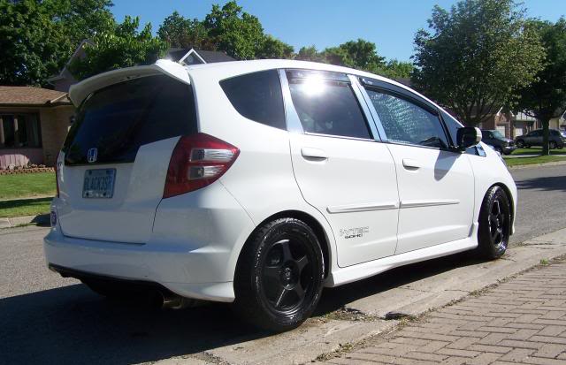

Nice setup. Wise move getting 45 offset. You will have no problem once you drop it.
My GE is on 16x7 with 40 OS. Just occasional rub on the front.

Looks so much better lowered. Small gap, perfect. Is that an HKS I see in the back ?

Yes it is a very expensive HKS. Shipping etc to Canada is just terrible.
