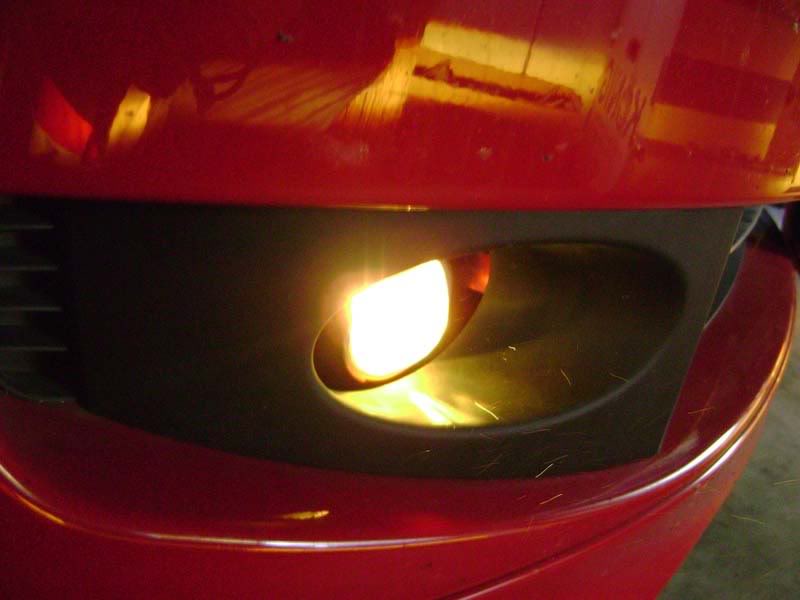

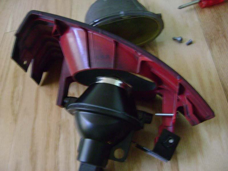

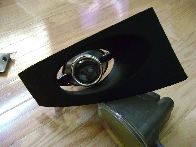

Well yeah, after reading this post i was thinking about it all day at work too, so i picked up a pair of projector and tried to retrofit them to fit, but the thing is i have no idea what i'm doing. so far it looks like this...

it works but it doesn't look good with that gap between the housing and the light. any idea on what i should do??? was thinking getting some black mesh and cover it there.. Should i even try to do this or just put the stock fog lights back on. help me out guys thanks...

You're going to want to take the lens off the stock housing, and cut a hole in the back of the housing to fit the projector, aim everything, then remount your lens on the front. That will keep the water and bugs off your projector, and keep the gap looking stock!
