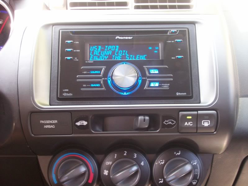

WEll as the title states i intalled the Pioneer FH-P8000BT today. It went pretty well and looks great!
It works great, I've only played with it a little bit but the Bluetooth Phone sounded good and the iPod controls work great, pretty simple and straight forward.

how much was that headunit? why didn't you opt for navi or DVD player?

It was on sale at bestbuy.com for about $290. With tax and shipping $327. I didn't get DVD or Nav cause this is My wifes car, she wanted somethin simple that looked some what stock and she could use with her iPod, she has the base model so no AUX input. Also the hands free bluetooth capability because starting in July is that cell phone law where you have to have a hands free. With a DVD or Nav unit i would still have to either buy seperate bluetooth hands free or get the pioneer unit that is $200.

Looks really nice and clean. Good choice!

Looks good, Did you test out the mic location to make sure your not getting any "fishtank" effect?.

did you have to buy a dash kit to install it?
or you just unplug your old dash and just install as is what you got out of the box
Old May 19, 2008 | 11:32 AM
Injundon's Avatar
Posts: 779
From: Montreal' Canada
you always need a dash kit when replacing the head unit on a Fit,. ALWAYS (Unless it's another Fit head unit)

Looks great! I have the same radio waiting to be installed...just got the dash kit today!
Question for you: I was looking over the wire harness and the Pioneer one has a black cable with a terminal on the end of it...you don't actually have to ground that to the chassis do you??? It just connects to the other black wire, right?
Any tips for installing this? I've got the exact same setup...same dash kit too.

Just connect the black wire to the ground wire on the harness.

Patience, It wasn't that bad, getting the A/C control cables off was the hardest part. They disconnect behind the glove box and have a little tab you have to push down in order to slide them off. There plenty of info and tips in other threads too in case you get stuck on anything. Good luck with the install and enjoy the HU, it works awesome
