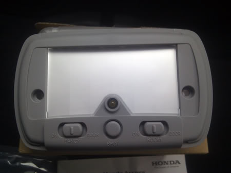

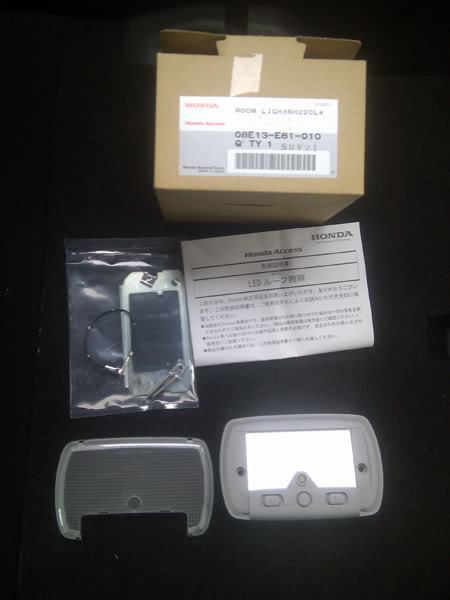

The part number for the light assembly is 08E13-E81-010. Not like it will help at the local dealer; I ordered mine from japanparts.com. This is what I got:

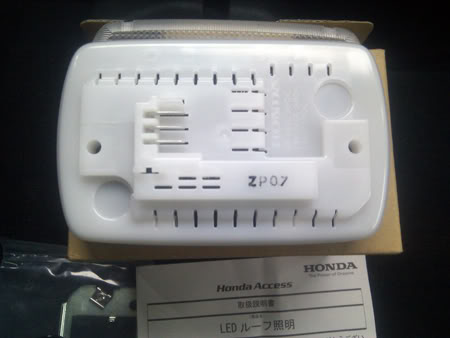

The main light is powered by 6 LEDs that light up the reflective surface, creating a relatively uniform light throughout. The spot light is in the center, and the fancy lights are embedded in the bezel on the rear side.

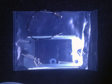

Included hardware should include a mounting bracket, two screw brackets, two screws, two washers, and a ground wire.

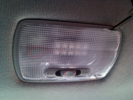

First, pry out the lens of the old dome light

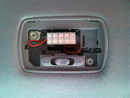

Remove and save the two screws

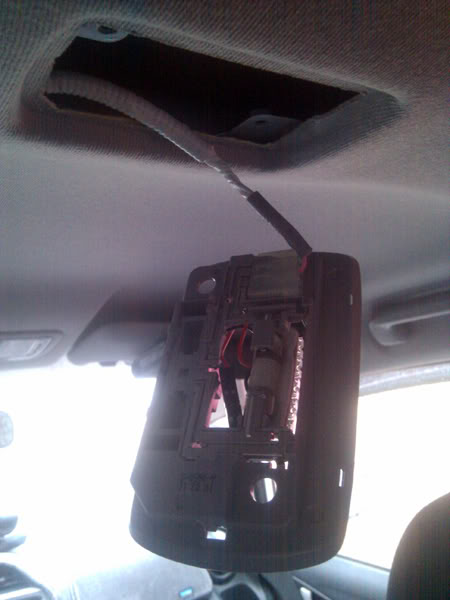

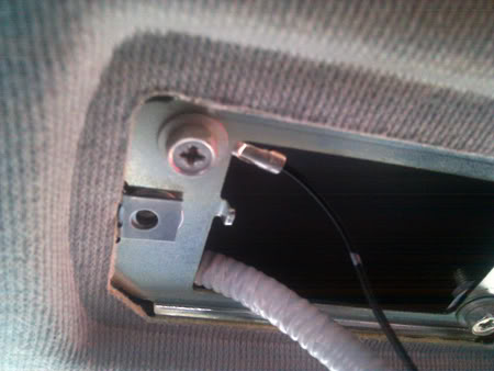

Disconnect the old light

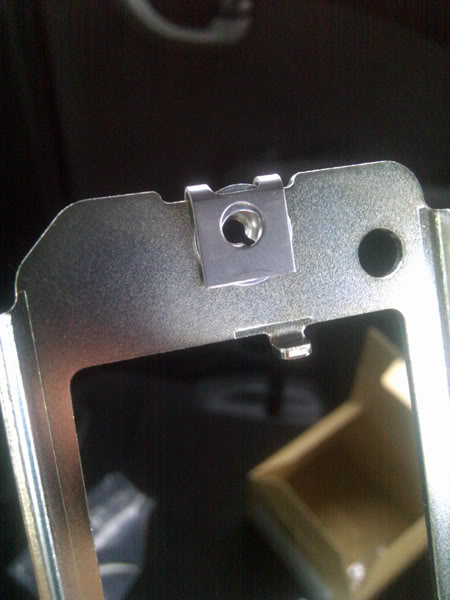

Now for the new setup, take the mounting bracket (where the small tab on the inside is cabin-side) and insert the screw brackets, with the outward bend to the rear, and sandwiching the washers on the near side

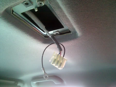

Take the grounding wire and stick the pin into the empty slot in the connector

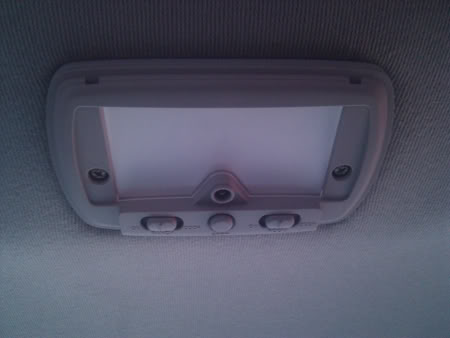

Install the mounting bracket using the old screws, sandwiching the ground wire between the existing mount and the new bracket
Note that if the little tab sticking down is on the left side, the light will subsequently mount with the switches toward the front of the vehicle.

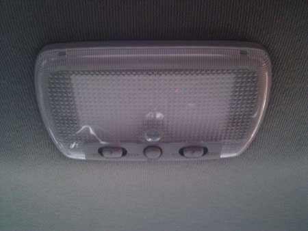

Now connect the LED roof light, test to make sure it works, then screw it in and put on the lens

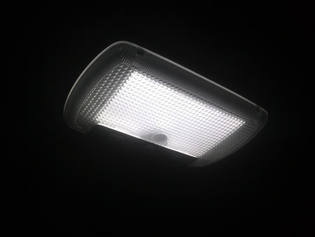

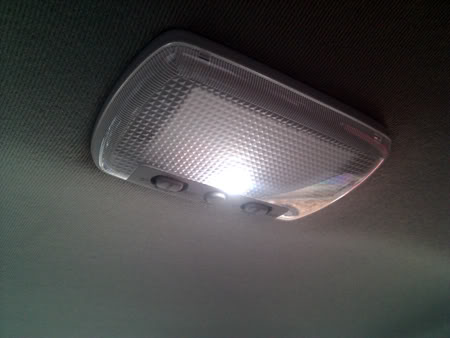

Here's how the dome light looks. It's freakin bright
and that's during the daytime
This is what the spotlight looks like

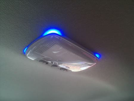

And the "fancy" light
To be honest, I was impressed at the brightness and uniformity of the main light, but equally underwhelmed at the dimness of the "fancy" lights. But I guess that's the tradeoff for taking up only 0.1 W (compared to the main light's 4.1 W), and being able to practically leave it on all night without much effect on the battery. Was it all worth just over $200 for the item and shipping? Probably not, but it is unique to be found this side of the pond =P
