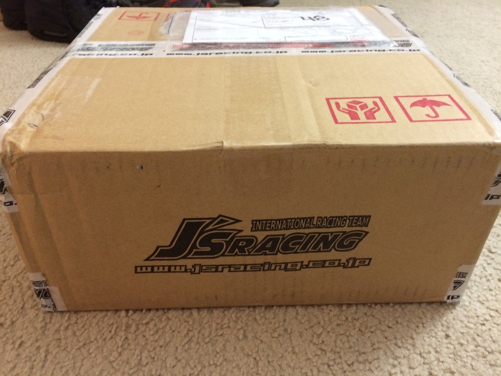

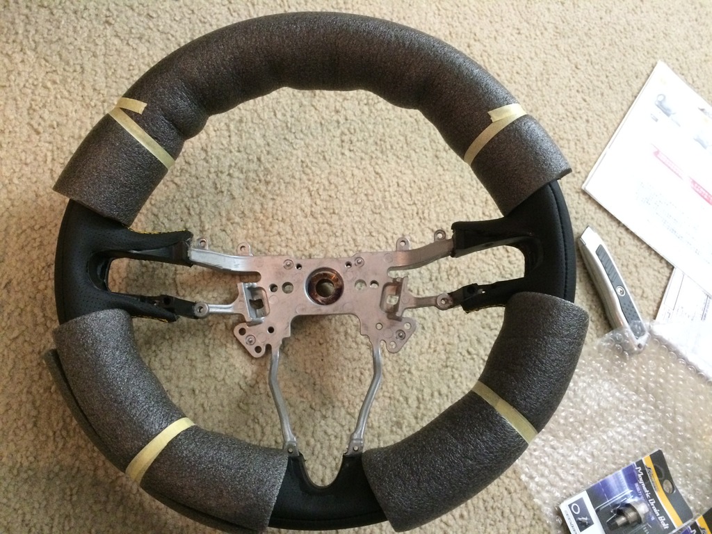

Box and Unboxing:

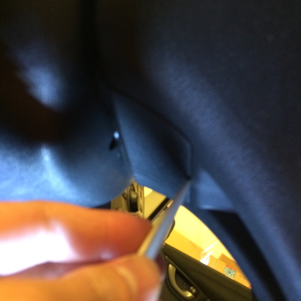

Take out the Plastic Cover underneath the steering wheel:

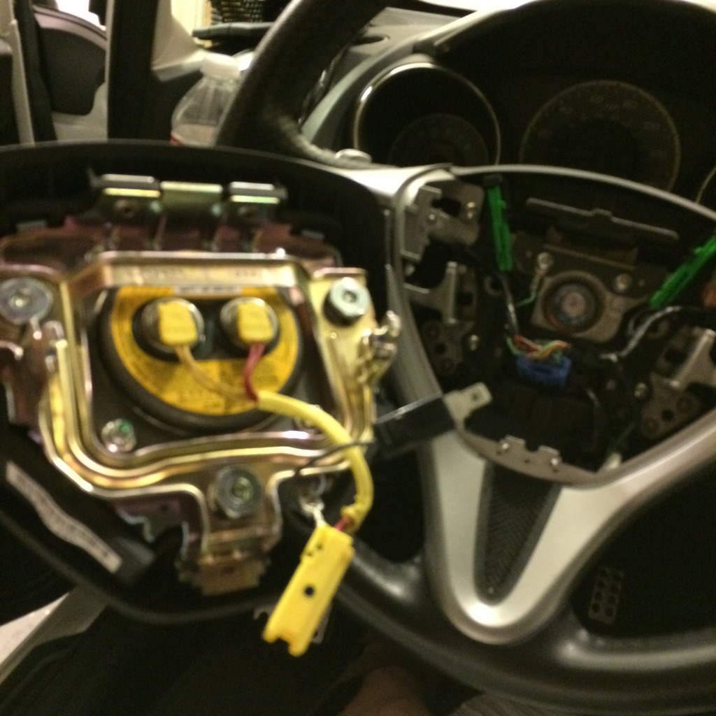

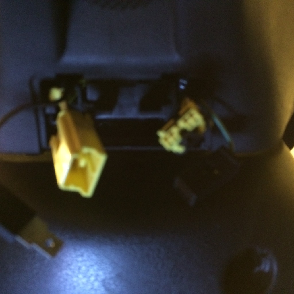

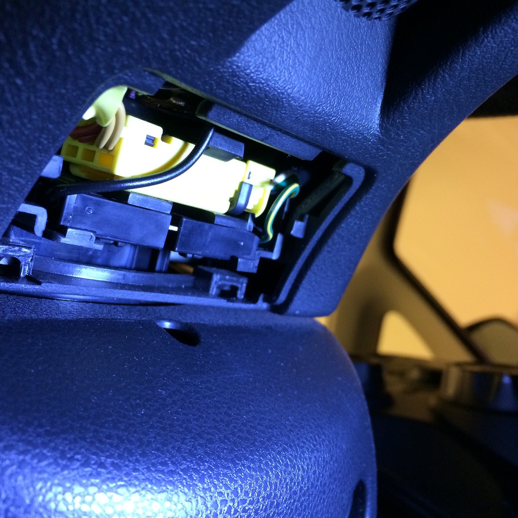

Unplug two socket (Yellow and Black):

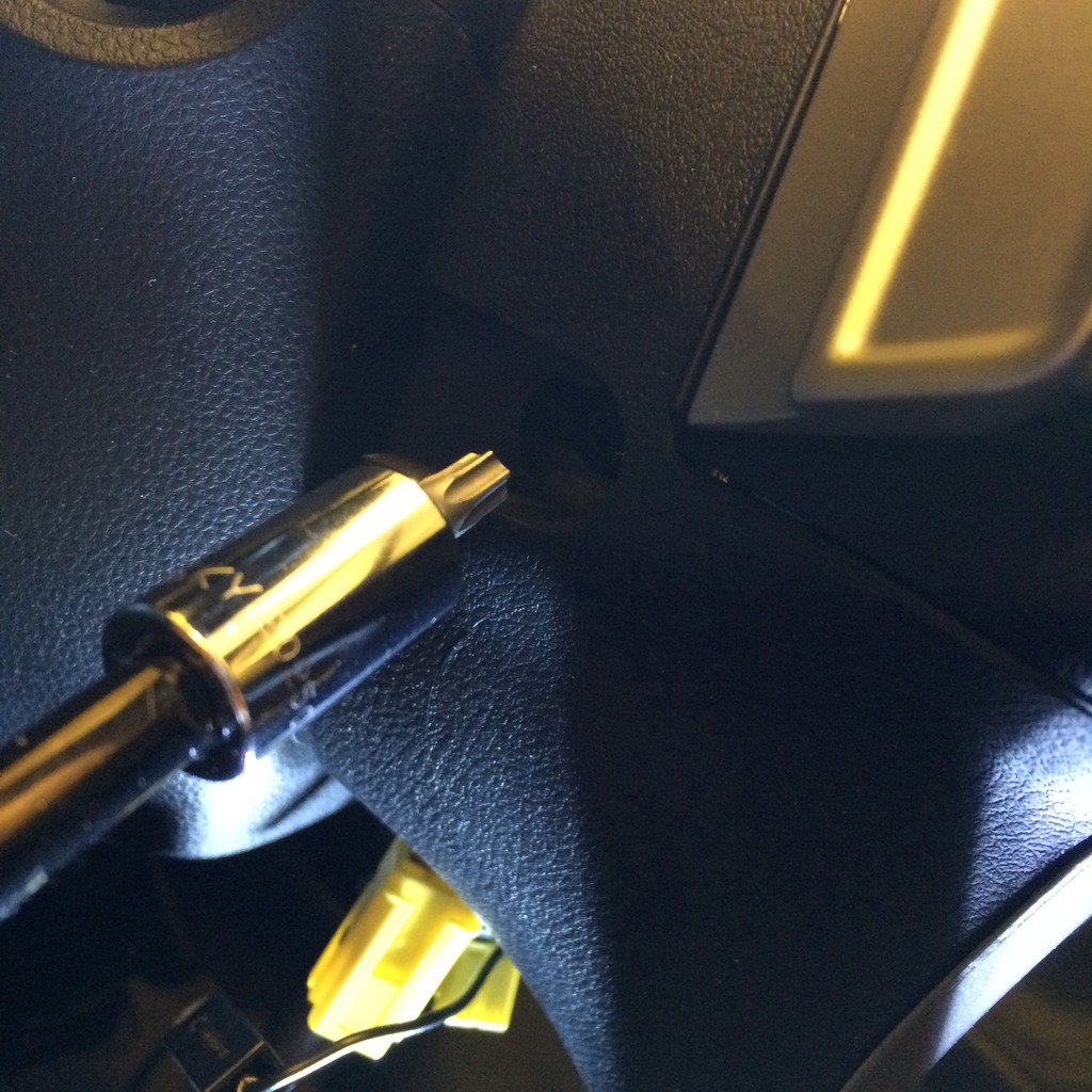

Using Torx T30, open the two bolt that hold the airbag.
There is opening on left and right side of steering wheel to access this bolt:
Take the SRS AirBag Unit out:

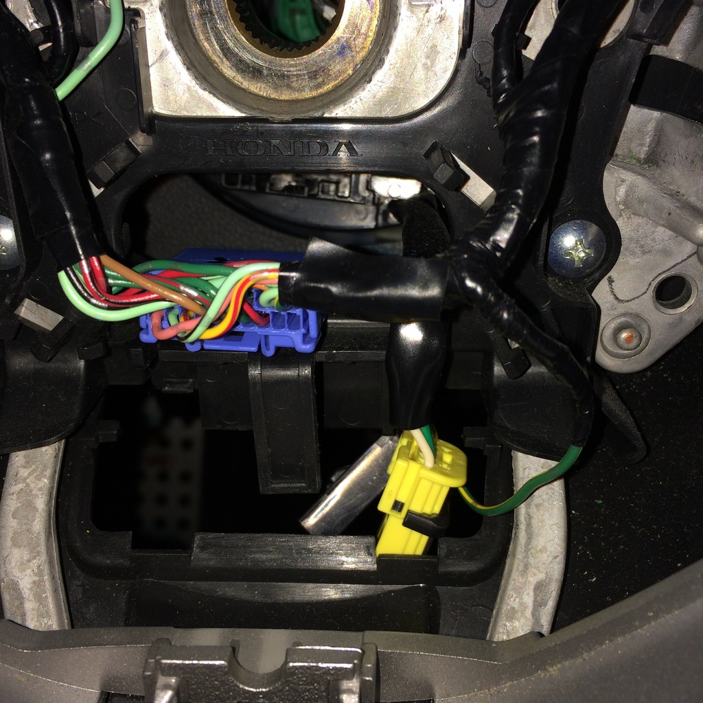

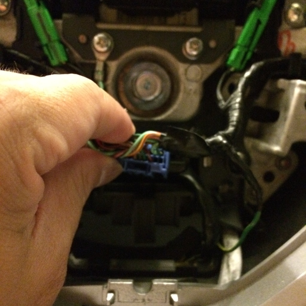

Disconnect the main wiring socket (blue):

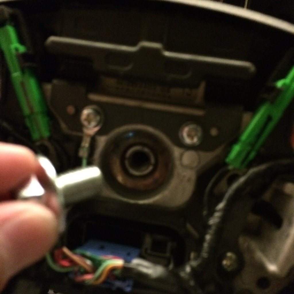

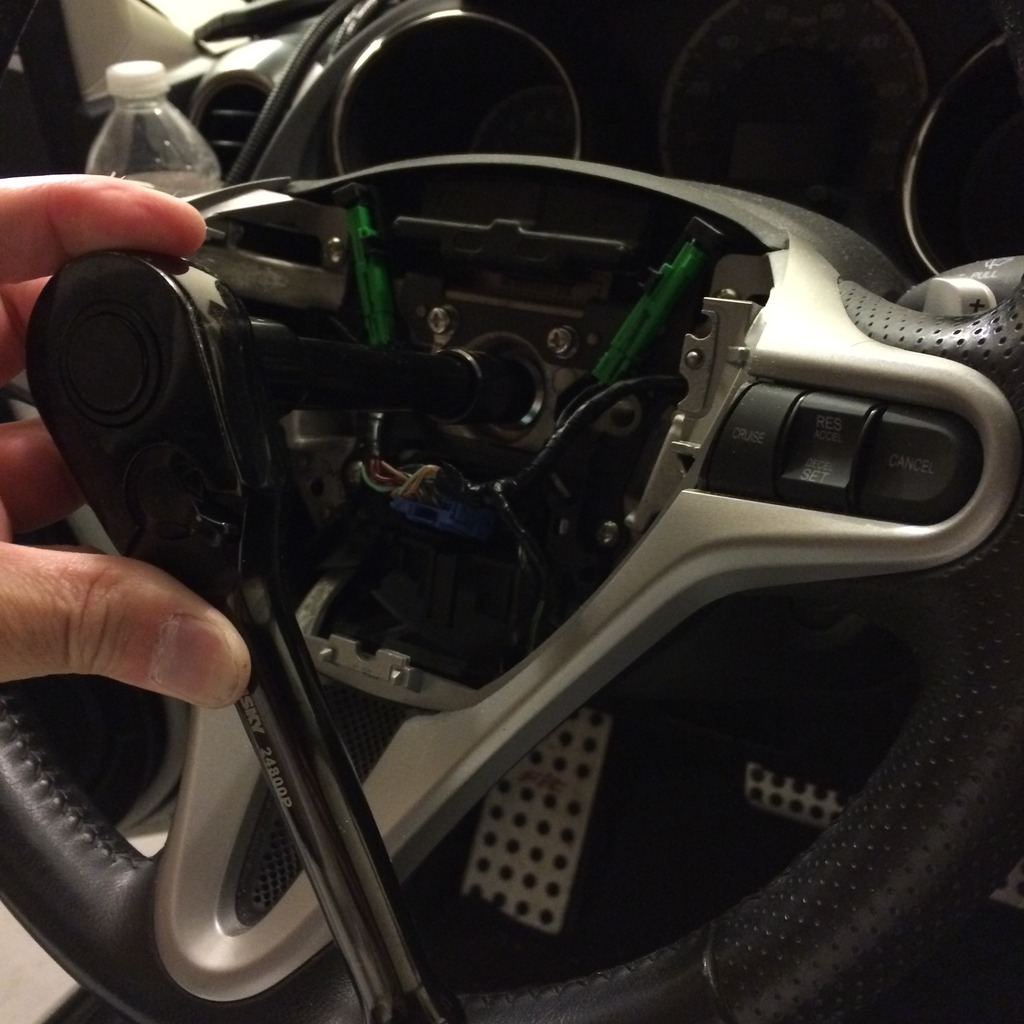

Use Socket Wrench 14mm, remove the main bolt:
Pull out the steering wheel, shake it, wiggle it, pull it until it is off:

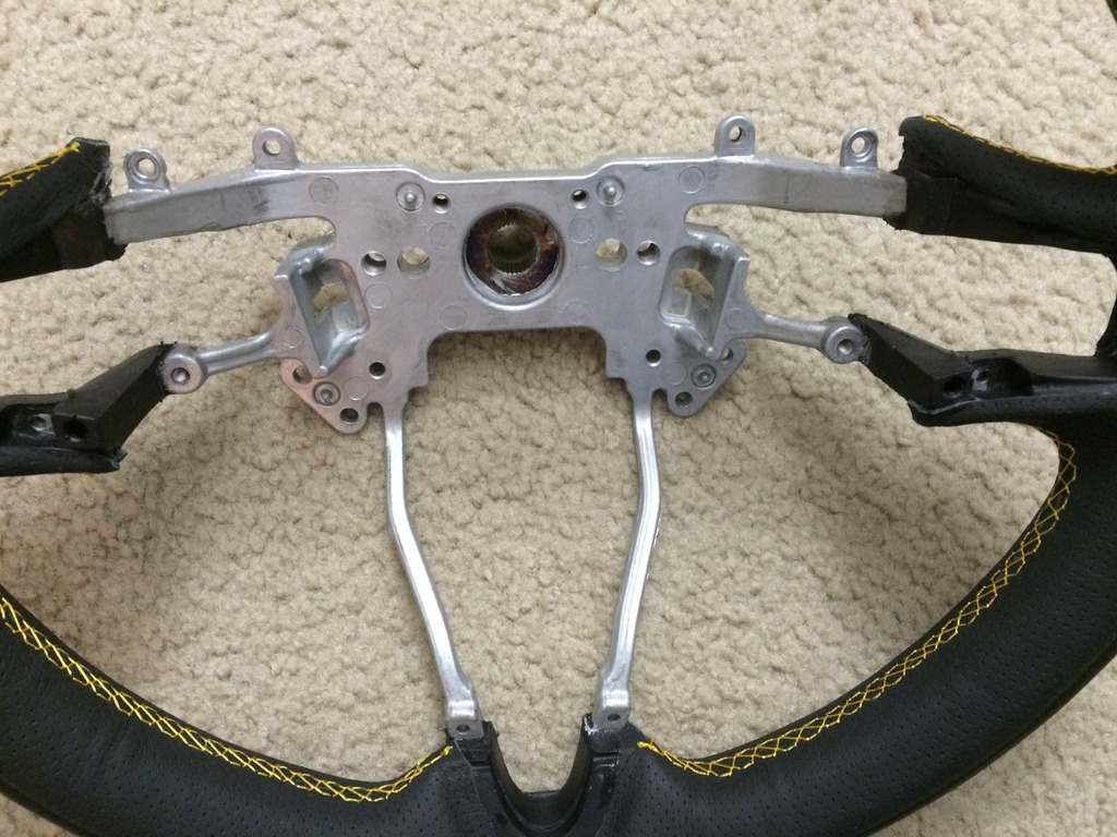

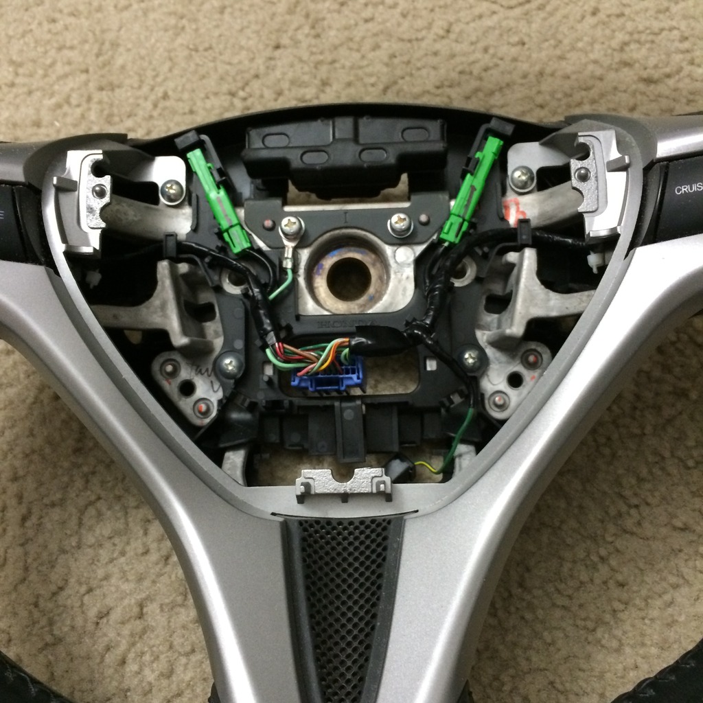

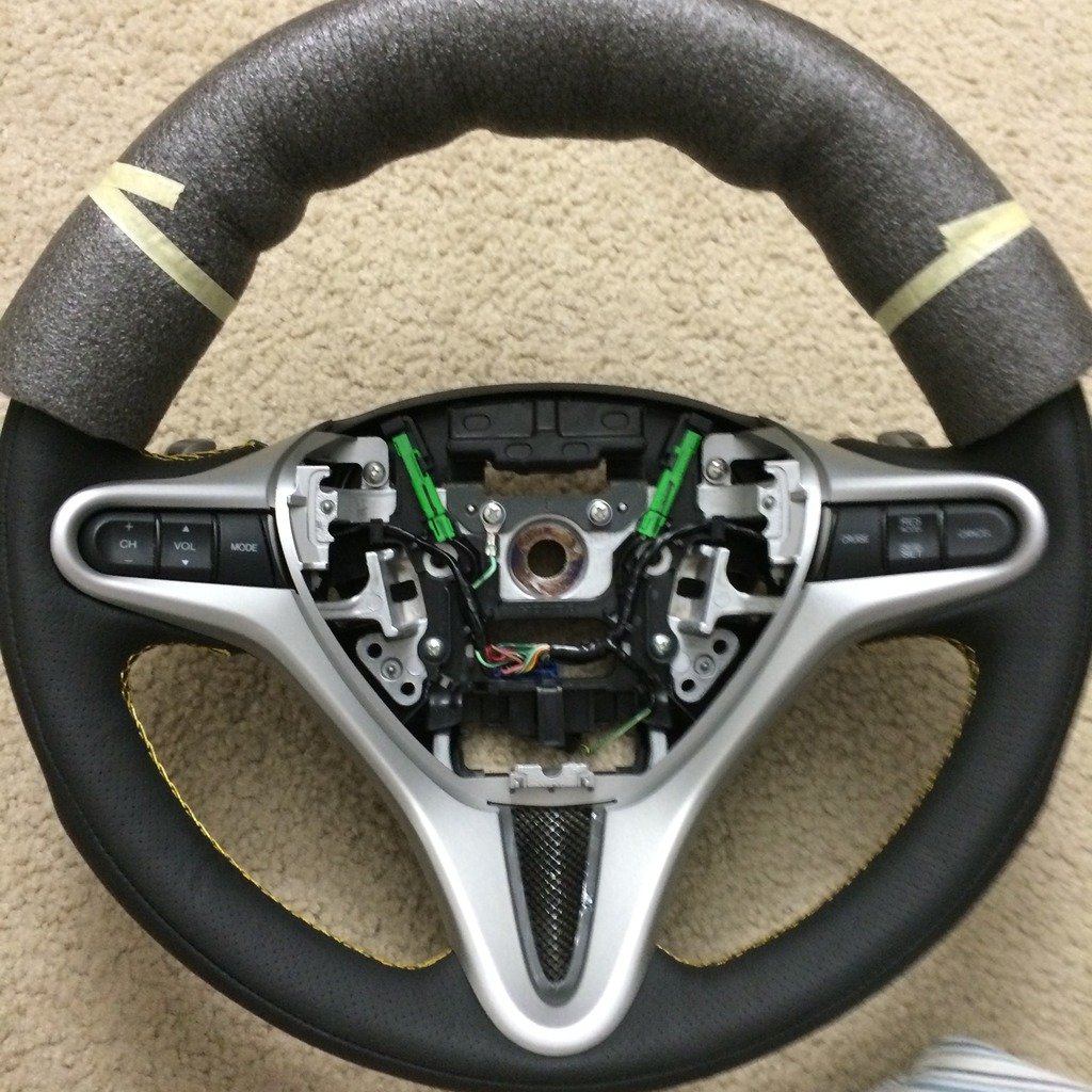

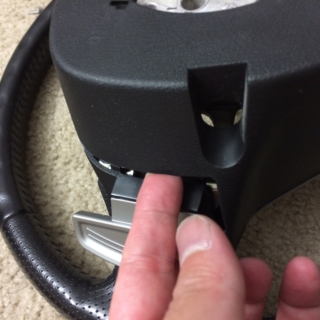

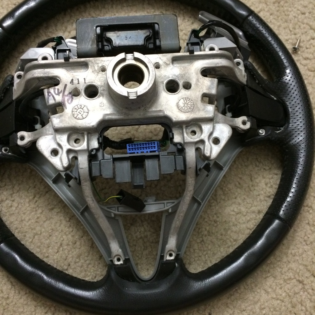

Take out the rear plastic panel and then start taking out all the screws
and remove all the plastic panel, wiring, switch etc to the J's Racing Steering Wheel:

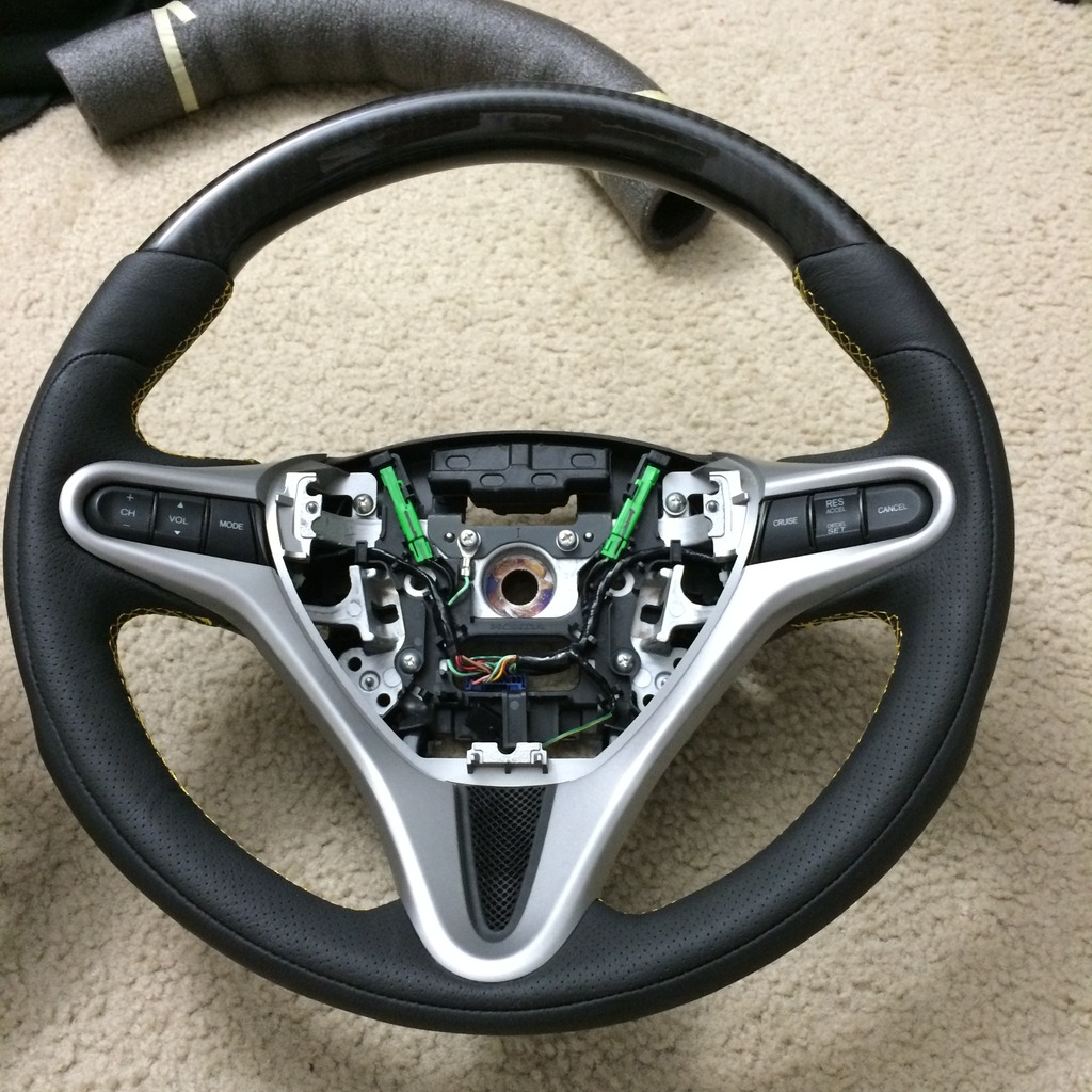

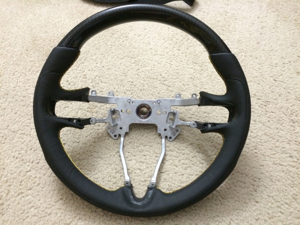

Once all the parts moved to the J's Racing Steering wheel,
it will look like this:

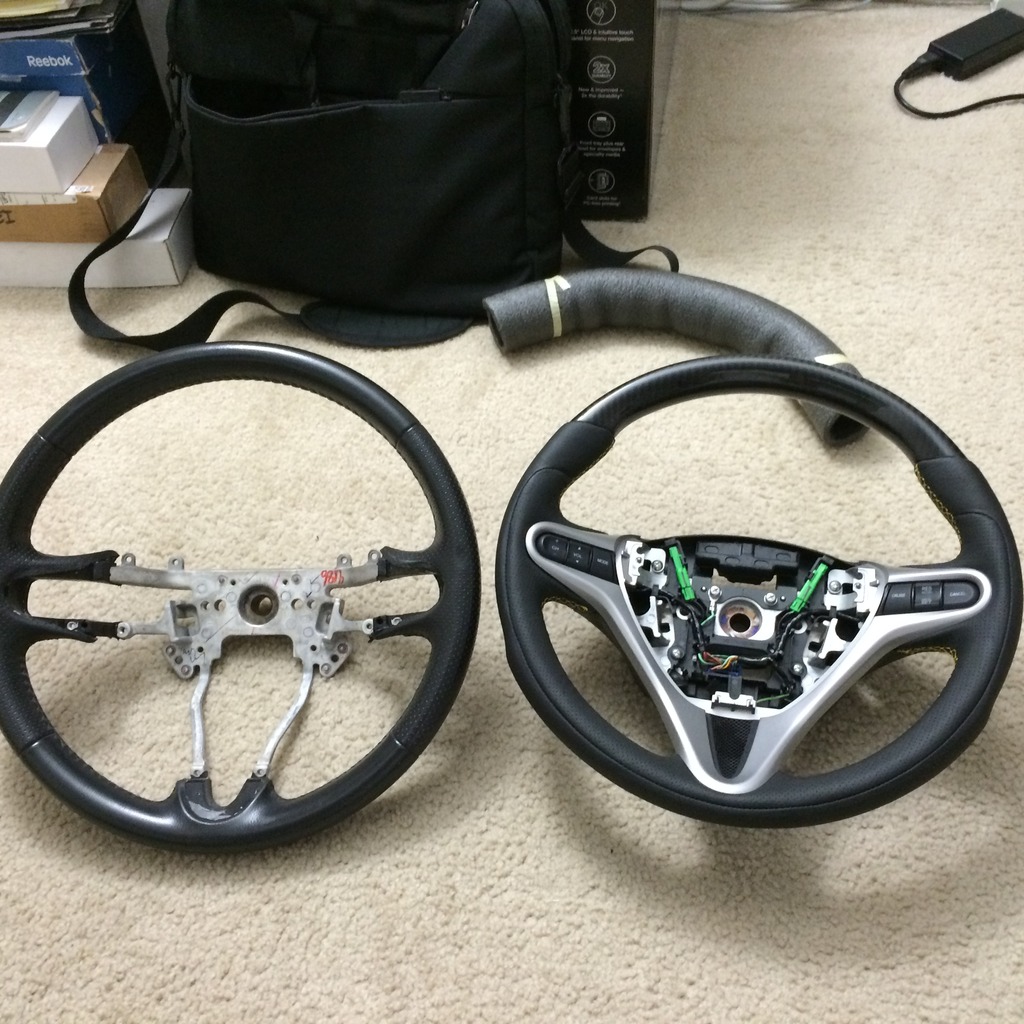

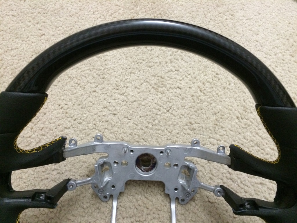

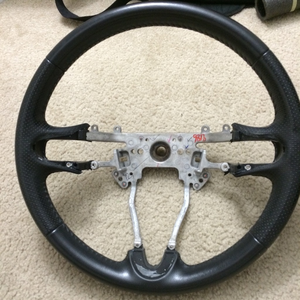

Comparison between J's Racing Steering Wheel and OEM Stock:

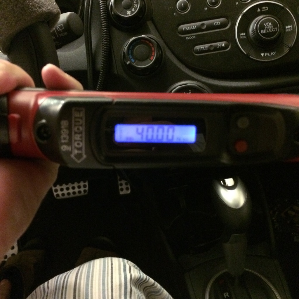

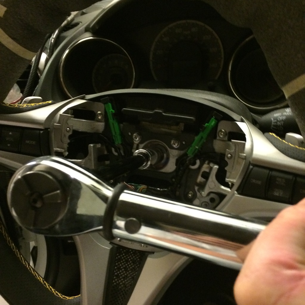

Install the steering wheel back,
tighten the main bolt using torque wrench at 39nm (but I use 40nm)

Connect all the wiring, and the air bag, and tighten the two Torx T-30 bolt
to 10nm, oh, and Honda told to discard this bolt, but I reuse them
and apply Loctite:

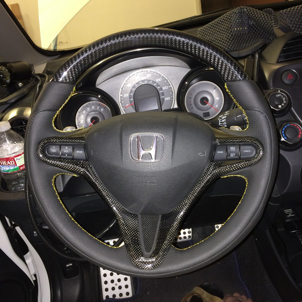

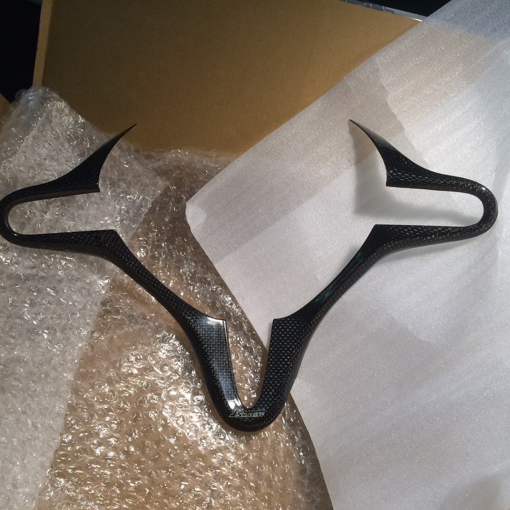

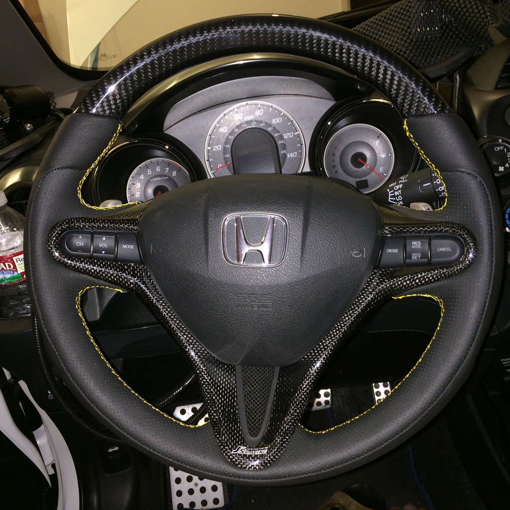

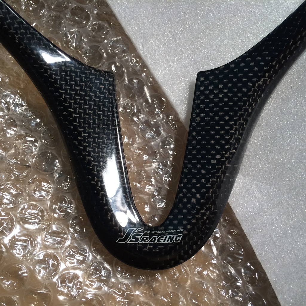

And here is the Final Step,
Install the J's Racing Carbon Fiber Steering Wheel Trim,
and here it is :

Got mines in the other day. Just wanted to clarify on something:
When removing the rear plastic panel and transferring the guts, are they just held in by the screws?
Any any link to the CF trim? Thanks for the write up!
Old Sep 20, 2015 | 12:50 AM
BMW ALPINA's Avatar
Joined: Jan 2013
Posts: 2,449
Hi, Congratulations
Yes, the rear plastic panel and other stuff just hold by some screws,
easy
The Carbon Fiber Trims are from eBay,
and below is the link:
http://www.ebay.com/itm/Authentic-Js-Racing-Carbon-Steering-Wheel-Trim-Fit-CIVIC-SI-FA1-FA5-FG2-FG1-GE8-/151520515847?hash=item2347539707&vxp=mtr
