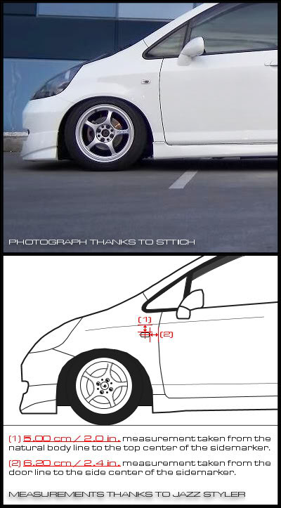

ok after thinking bout it... how do you measure like where to put on the fender? haha damn it I need help
Old Oct 12, 2008 | 06:06 PM
gimme's Avatar
Master FitFreaker
iTrader: (13)
Posts: 4,253
From: Phoenix
sigh. 2" down from the body lie and 2.4" from the end of the fender.
Old Oct 12, 2008 | 06:11 PM
08_Nick_Fit's Avatar
Posts: 640
From: Rancho Cucamonga, CA
Thanks!! Damn I feel retarded tho... Well I got the template. I just need the side markers now. Im still scared to cut into my fit ha.
