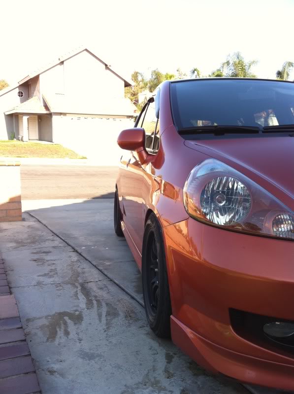

didn't need to roll after all... i already had the front sorta rolled and me and a buddy did a little tweaking to the rear.. thanks for the info guys.
here are some phone pics of the fitment.

Specs on the wheels?

15x8 +36

Higher offset so that's why your fenders only needed rolling.

me and a buddy just used a bat for the rear and on the front i just pushed the tabs up and with a little snip of the fender liner to roll the front..
