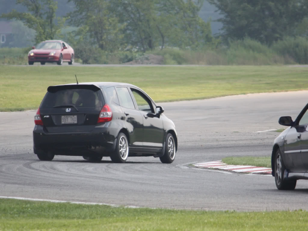

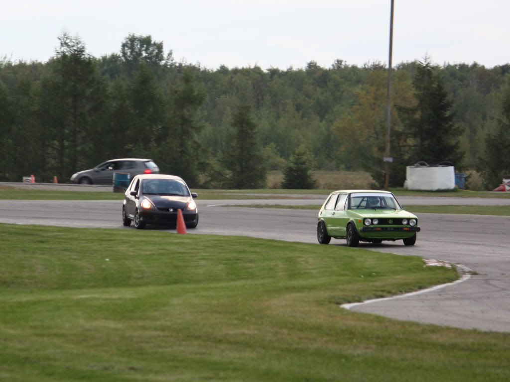

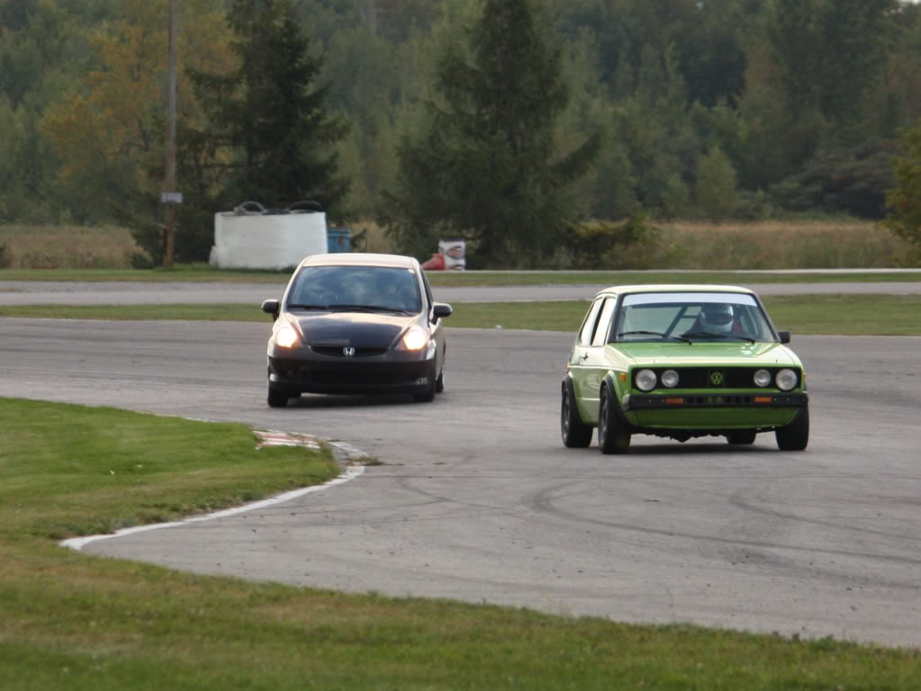

This is so true!
I have eibach pro kit springs on eom dampers and no rear sway bar and I can have a lot of fun on the track. I can even get the tail to step out a bit to help rotation with some trail braking. I think your setup can be a lot of fun too except if you're on a very bumpy track where you'll most likely bottom out the suspensions(that was my case). Sport dampers would be a good thing to help this but there's not a lot of choices on the market.
Just in case you were wondering: I never went off track with the fit but you need some good reflexes. But it won't do that if you don't provoke it quite hard.
