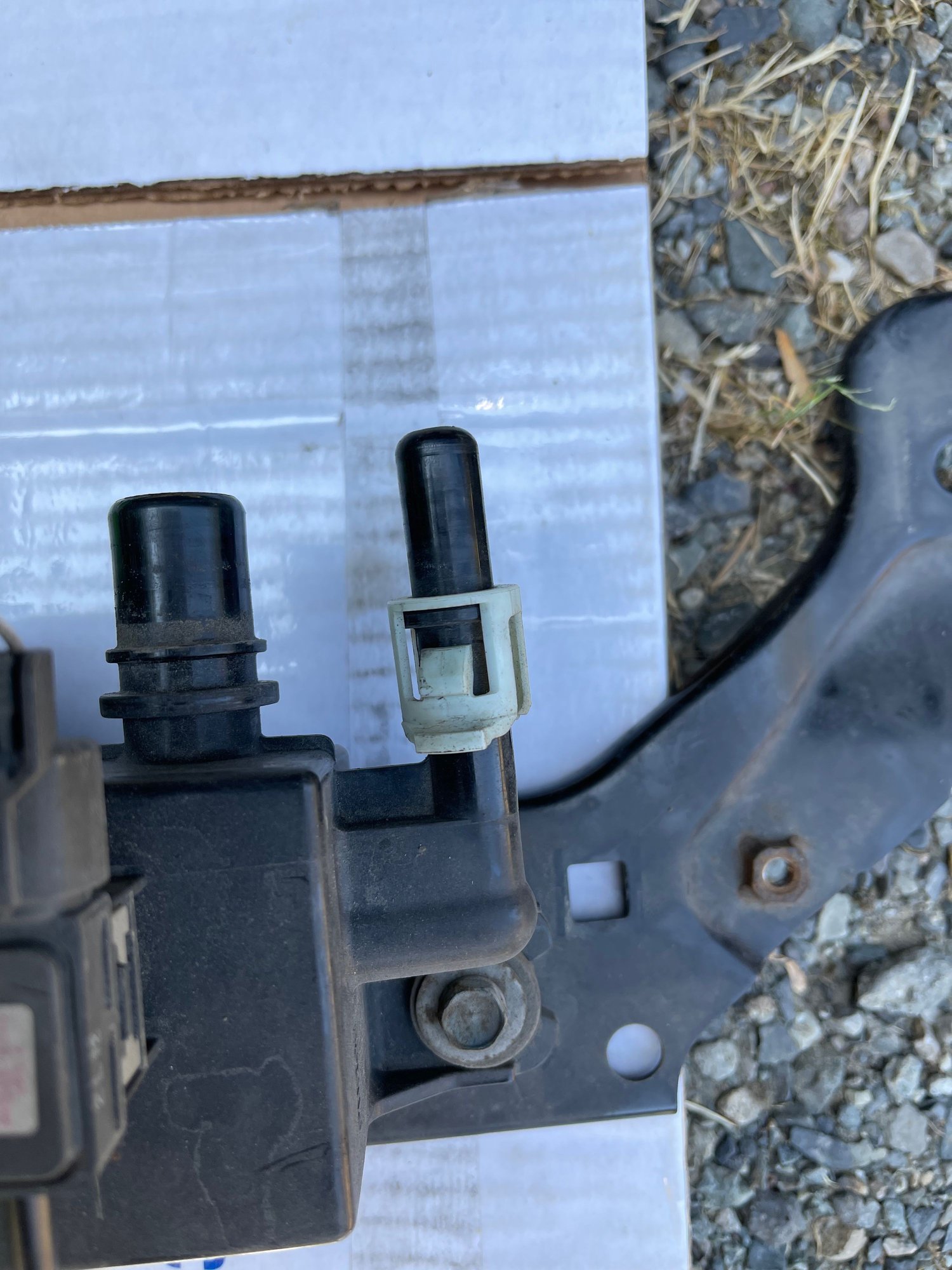

Now that we have all bolts removed, scoot back out from under the car most of the way so that you can see the canister from the other side. Undo those two connectors. To do so, pinch the green tabs on one, and use the Flat Head screwdriver to push it off from the bottom. For the other one with the white plastic on the inside of the connector, just pinch the white bits and pull the black piece off. The white bits will stay on the nipple (see next photo for clarification). Disconnect the small rubber tube connecting to the back of the canister.
See how the white bit stayed on the nipple? This one can seem tricky, but it's actually the easiest one to remove.

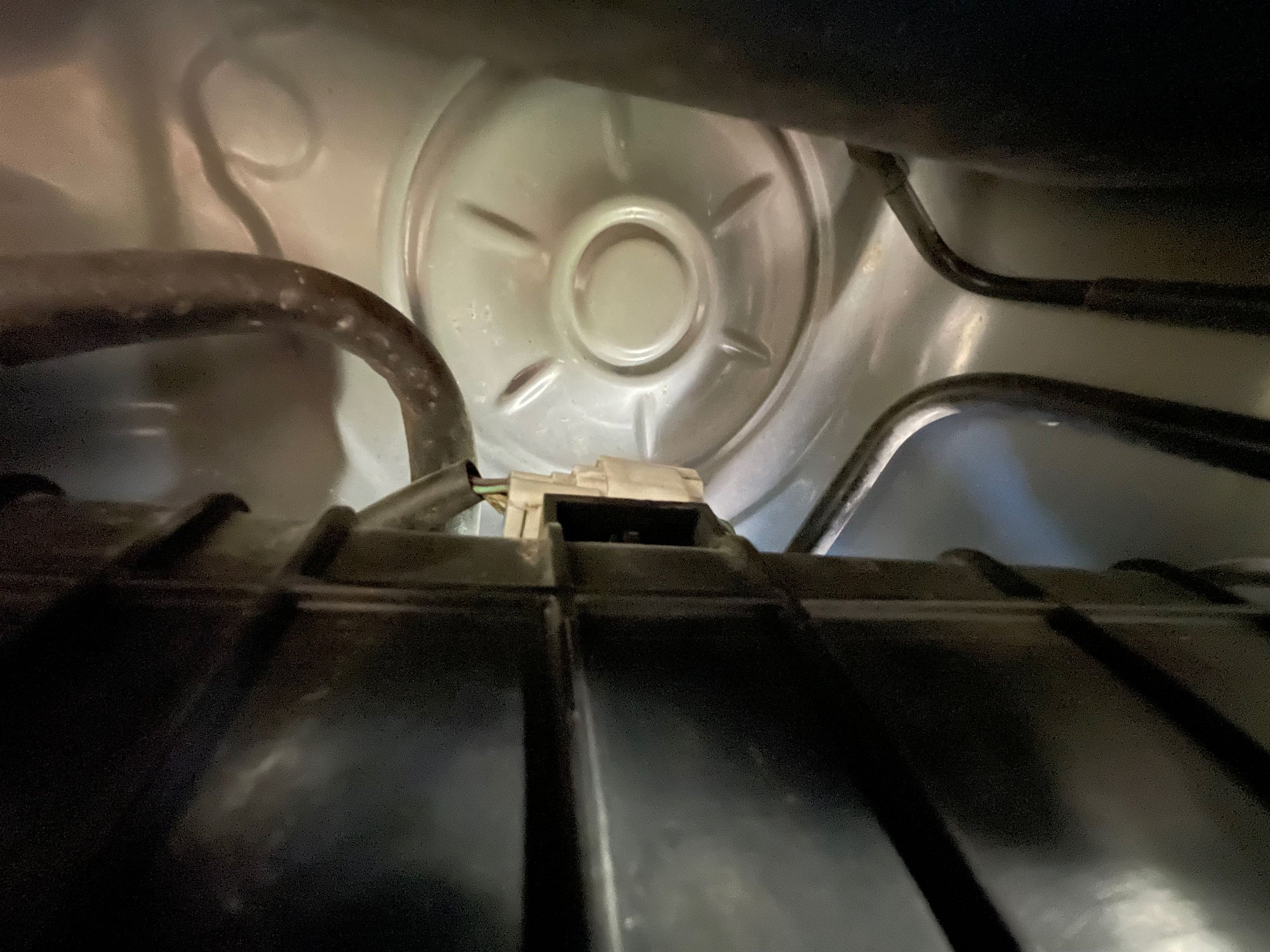

Thank you for this! On mine the tube circled in blue was completely chewed through by rats. Could you please help me out if you know what it's called and what it's supposed to go to? Much appreciated
