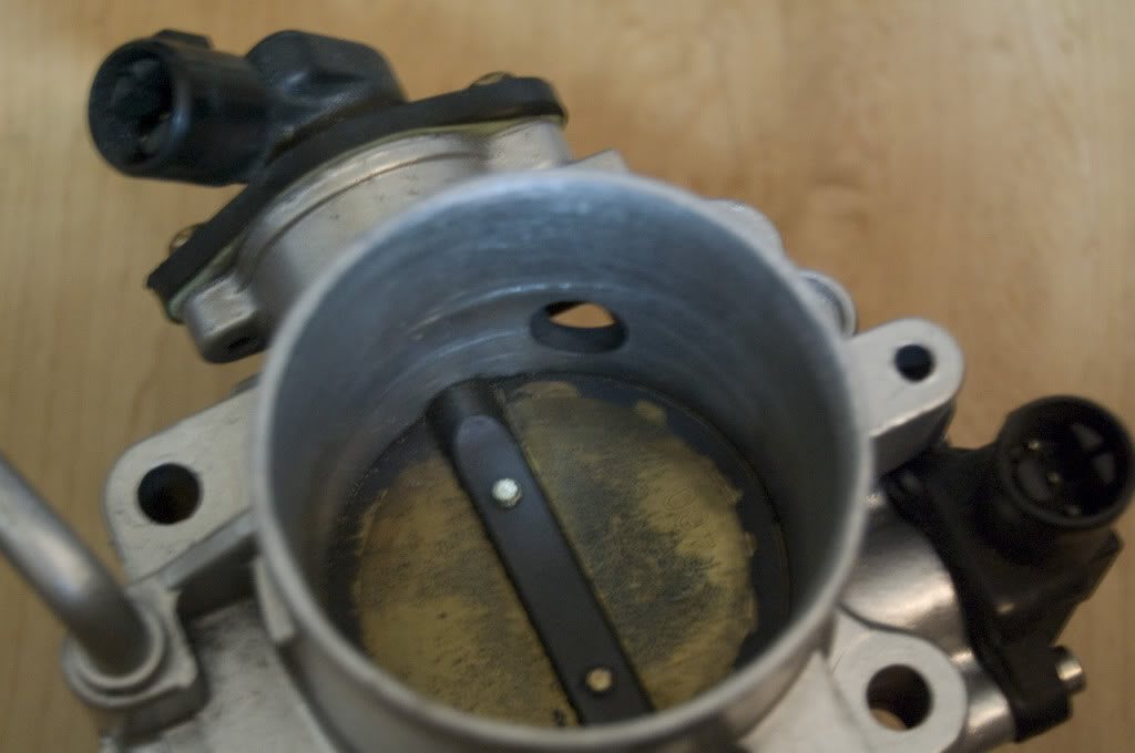

Originally Posted by AnlDyxp_GD3
I think someone on the forum mentioned that depressing the clutch all the way completely closes the throttle body. But that can't be right is it? If the throttle body were to close all the way, wouldnt your car stall or shut off?
Lets just say for the sake of argument that this is a Fit throttle body. It isn't of course, it belongs to my del Sol, but I didn't feel like tearing into the Fit.
Notice that the valve is completely closed. This is the same configuration as when the car is idling. But how does it stay running!?
There is a bypass before the valve that allows air to enter when you are not mashing down the accelerator. Notice in the blurry picture you can see wood through the bypass even though the throttle is closed.
Of course with the drive by wire system in the Fit, instead of a bypass the ecu probably just opens the throttle wide enough to maintain the proper idle speed.
